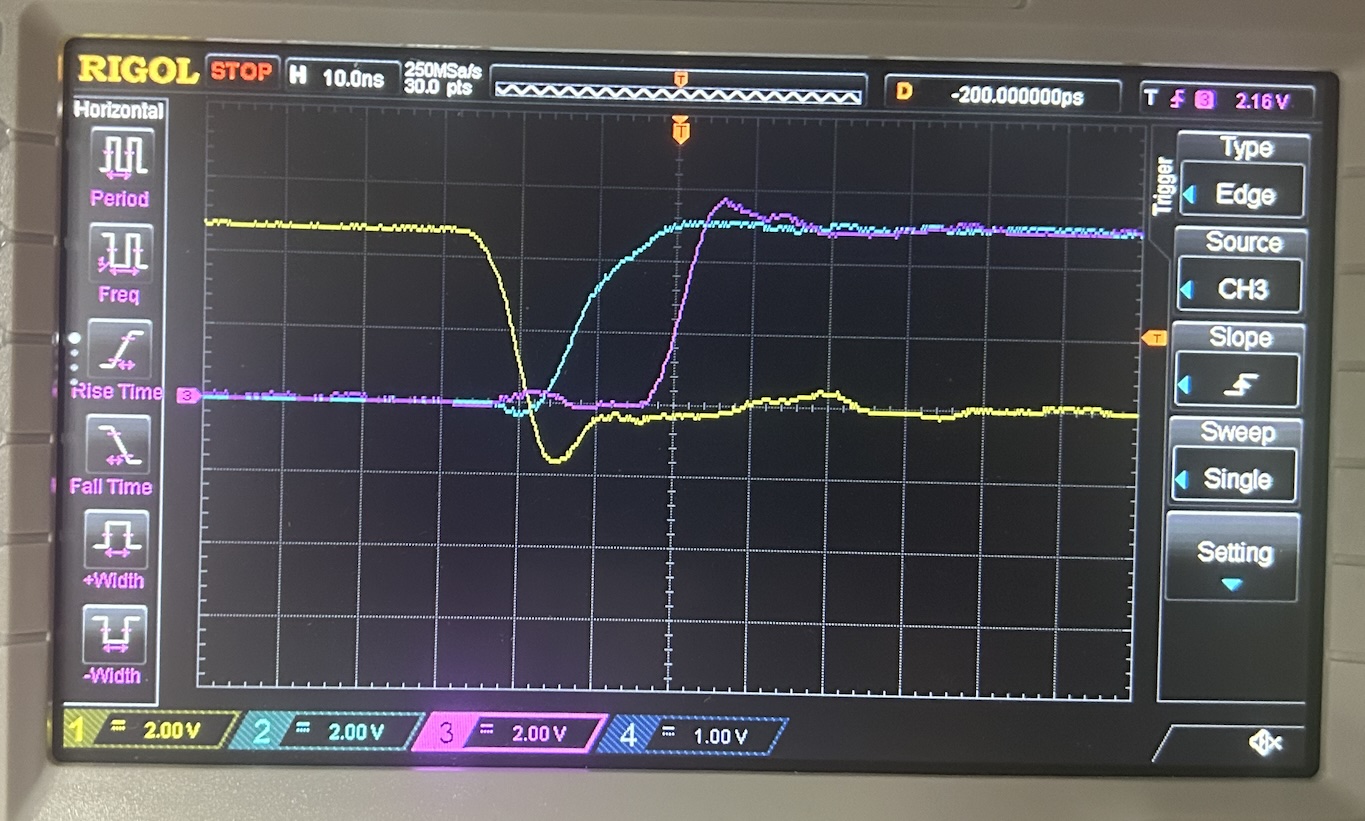

Here are a pair of traces. The bottom one is the original setup using phi1-qualified writes, where I get this phantom write occasionally. The top one is the working setup using /phi2-qualified write, where phi2, /phi2 are symmetric outputs from halved clock via hc74 flipflop. Vertical scale is 2V (0-5V signal), horizontal is 10ns.

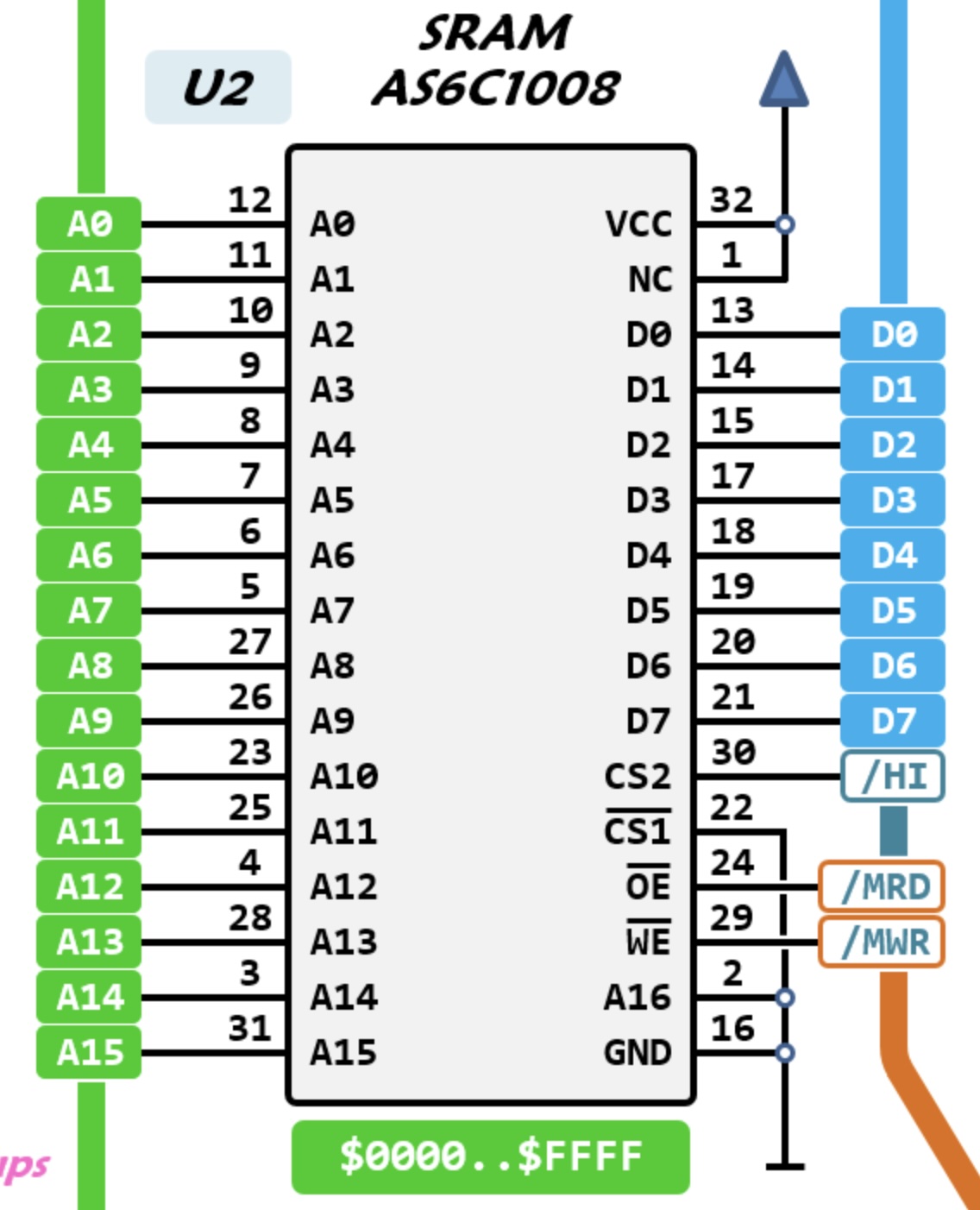

Both traces capture a rising edge of /MW which is /WE on the RAM AS6C1008. From the RAM datasheet this is what locks the actual write. It seems to want 25ns setup time before the rising edge (this shouldn't be an issue), and 0ns+ hold time after. The 65c02 datasheet says we get 10ns+ hold time for both address and data after the phi2 falling edge (am I reading that correctly?). So we want the rising /WE edge within 10ns of the falling phi2 one.
Looking at the 50% voltage point (is that right?), it seems like the bad case shows about 20ns between the falling phi2 and the rising /WE. There's about 10ns lag between phi1 and phi2 plus about 12ns lag from phi1 to /we, which seems about what to expect from the hc139's datasheet. So that's too slow to be guaranteed to lock the addr/data that the 65c02 is holding?
In the good case we see only about 7-8ns lag from phi2 to /we, in fact /we rises a little before the cpu's phi1 output. I don't have the /phi2 signal on the trace since I was assuming it was just the inverse of phi2, but maybe that's not quite right since otherwise you'd expect a similar 12ns lag for the hc139?
But from these traces it seems like any write strobe generated downstream of phi1 is going to be too slow to meet the 10ns limit after phi2? So I'm probably missing something!

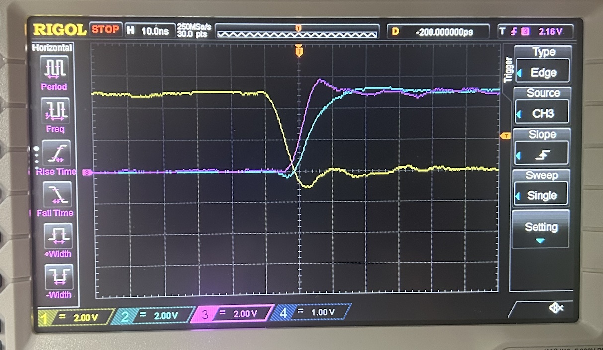

For completeness, here's a trace of clock in (ch3, purple) with Q (ch1, yellow) and /Q (ch2, blue) outputs. It does look like 2-3ns lag between the two, so perhaps explains the slight discrepancy above.
One other idea I'm curious about. I followed Michael's diagram and simply wired the SRAM's /CS1 to ground. What if I wired /CS1 to phi1, leaving CS2 = /HI and /WE = /MW as is. I This would give a rising edge on /CS1 before the /WE rising edge. Would that lock the write earlier (the datasheet describes write cycle 2 "controlled by CE#, CE2") and potentially fix my problem?
I'll give it a try but curious if I'm reasoning correctly there.

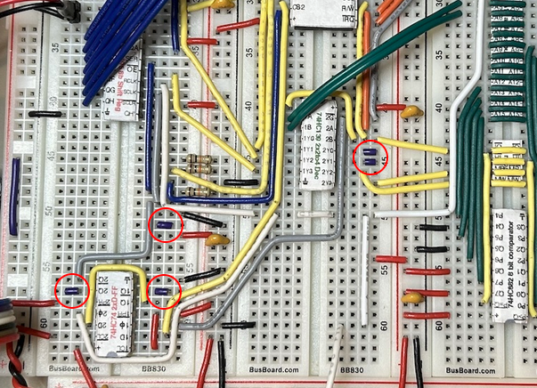

I was looking at the image of your breadboard wiring (with some envy, it must be said - it is quite neat) as I am always looking to see how other people do things, when I spotted some links that I have no clue as to their purpose. I've circled them in the attached image.

if there's space I try to mark n/c pins with a no-op purple 'staple' like that. the ones of the left are part of the hookup for an SD card that's not present in the photo.

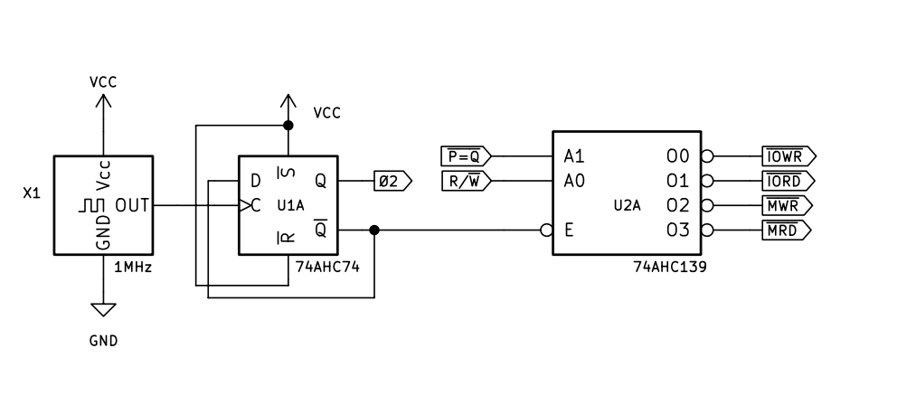

i did resolve the issue eventually by avoiding the phi1 out from the 65c02 and generating my own anti-symmetric phi2/phi1 clock signals from a flip-flop. fairly up-to-date schematic here https://docs.google.com/presentation/d/ ... slide=id.p
