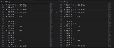

Here are a few more data points.
- Replacing the LS139 with an HC version made no difference. Fails the same way.
- I changed the .org of my ROM code from $f000 to $e111 to flip the parity of all the jsr addresses, with no other changes. The IO addresses remained in the same place in the $c0xx page. The failure mode is identical - it returns $100 beyond where it should, at the same call location. In the original case it read $f113 instead of $f013. With the modified org it read $e224 instead of $e124. See side-by-side traces attached
- trying to understand how it could be a software issue I sprinkled in some `lda $1ff` instructions so I'd see where the value changed. Here's a fragment of a trace where you can see the value morph. This is after successfully doing several jsr/rts involving the top-of-stack at $1ff, and passing my memory tests which heavily exercise the stack in a number ways.
It's as if somehow interactions with the VIA are affecting that memory location, but I'm having trouble imagining a scenario where the byte at $1ff magically increments when $ff doesn't appear on the LSB of the address bus at any intervening point.
Any other debugging ideas? I'll try to organize a PC with hoglet on the weekend. I'll probably also try some clock alternatives - all these tests are still clocked super slow, <1KHz. I'll also try to dig out a different memory chip - I think it's only 32Kb so will leave a hole from $8000-$bfff but I guess that doesn't matter for this purpose.
I've also attached the org .f000 listing if anyone wants to stare at it - it's a bit of mess as chop and change...
* f108 r 85 00     STA  $0000
  0000 W 41
* f10a r a0 c0     LDY  #$c0
* f10c r ad ff 01  LDA  $01ff
  01ff r f0                     <= TOS OK with value $f0
* f10f r 18        CLC
  f110 r da
* f110 r da        PHX
  f111 r a2
  01fd W 00

Dinosaur's suggestion of using symmetric Q, /Q outputs from a '74 flipflop halving the input clock (replacing the w65c02's phi1 output) seems to fix the problem, at least at for the sub-1khz speeds i'm experimenting with.
I also narrowed down where the phantom write happens (below). Surprisingly to me, read/write to IO page ($c0xx) doesn't seem to be implicated, but I guess phi1-qualified /mr and /mw signals are enough out of phase with the /phi2, /hi and /io signals that we still have the write enabled as the address bits change?
I find it odd that so much seems to work correctly before we get to this repeatable failure point but the hardware details are still very mysterious to me.
Is there a good tutorial that would help me understand the two write-cycle timing diagrams in the RAM datasheet https://www.alliancememory.com/wp-conte ... eb2007.pdf ? I haven't had enough practice to grok them on their own.
Progress! :D
I also narrowed down where the phantom write happens (below). Surprisingly to me, read/write to IO page ($c0xx) doesn't seem to be implicated, but I guess phi1-qualified /mr and /mw signals are enough out of phase with the /phi2, /hi and /io signals that we still have the write enabled as the address bits change? I find it odd that so much seems to work correctly before we get to this repeatable failure point but the hardware details are still very mysterious to me.
I still suspect a noise issue of some kind. The W65C02's clock outputs don't lag the clock generator by enough to cause logic problems at your very slow speeds. But the W65C02 is fussy about edges (especially clock edges) at all speeds! Sometimes noise glitches like crosstalk happen at only very specific emergent combinations of conditions and can be really tough to pin down. Can you look at your clock and address lines on a scope? Now that you have a potentially working configuration you could do a before/after comparison.
