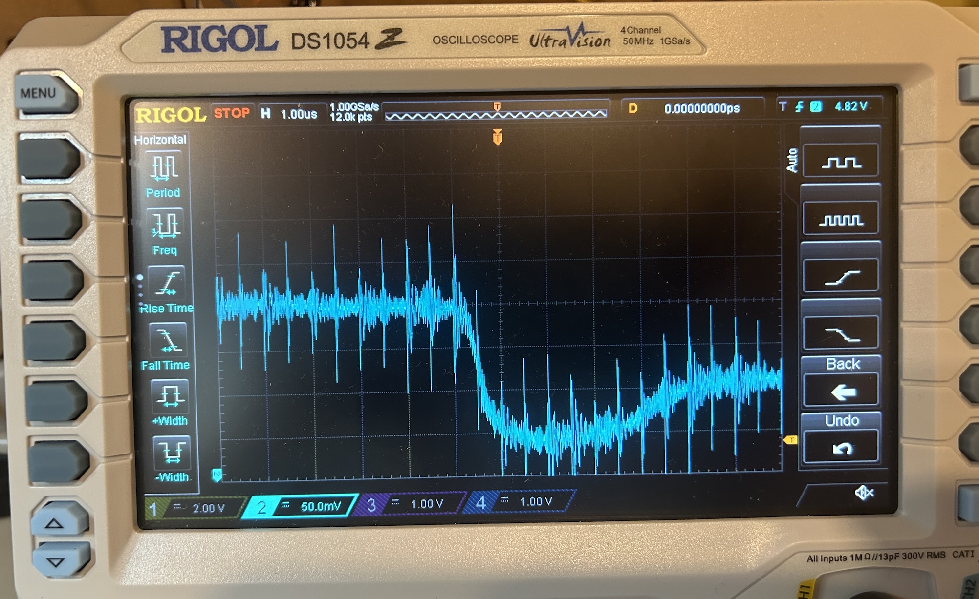

I have a typical 65c02 breadboard setup @ 1MHz which is working nicely (4x20 LCD, SD card, kbd, running forth etc).
I read somewhere on here about the EconoReset part so figured I'd wire one across my /RES pushbutton to debounce it. (sure "if it ain't broke..." but that's half the fun :)
But now when I power up the initial startup is fine (it plays a little speaker init sequence) but then immediately resets again when it tries to initialize the LCD screen, and so just plays the startup sound in an infinite loop. Reading the datasheet more closely, I realize it is presumably triggering because the LCD init is causing the voltage to dip below its trigger point. (I think I have the 5% threshold part, number is DS1813-5T&R)
I'm powering the board from a bench power supply at 5.00V and over-current protection @ 300mA. There is definitely a current spike when the LCD initializes, but I don't think it was exceeding that threshold. Maybe momentarily tho?
I'm still new at all the hardware stuff. Any recommendations for how best to avoid the repeated reset? Is a small increase in input voltage or current threshold likely to help? (I do like that ocp helps me fry fewer parts...). Thanks to previous advice here I've already sprinkled lots of capacitors and more power gridding on the board, but maybe I need a bigger one to help serve the LCD?

Here's a couple thousand words worth of pics.
I don't think the wires are particularly long. There are a bunch of 100nF and a few 10uF caps on the power rails near components, and crisscross grid.
(strike this:) It seems the culprit is actually the keyboard - this hosts a pro micro (RP2040 MCU).
Correction: disconnecting the kbd stops the reset cycle, but the kbd isn't involved in the 6502 init sequence or connected to the reset line and quickly gets into a quiescent state where it's sitting waiting for keypresses. So although it might be dragging down the overall current draw, I think the LCD on/off cycle during init is what triggers the actual reset.)
I'm still learning the scope but managed to trigger a trace during one of the reset events. The voltage drops to about 4.8V (vertical grid 50mV) and recovers to 4.9V after about 5us (horizontal scale 1us). I guess the other spikes are due to the two 1Mhz clock edges per 1us? I measured near where the PSU connects to the breadboard.
I'm not sure i'm reading the ds1813-5 datasheet correctly but it seems to say the typical trip point is 4.6V (though 5% of 5V might imply 4.75V?). So maybe it's borderline.
I don't see an obvious spike in current draw on the power supply but maybe it's momentary. Could I use the scope reading to size a larger capacitor to serve the momentary excess demand? Or something else?

It does seem like upping the current limit on the power supply solves it

There are different versions of the DS1813, each with its own voltage threshold at which it releases or sinks the reset line.
BTW, although the DS1813 has an internal pullup, it’s weak and makes the reset circuit somewhat noise-prone.  For best results, you should have a 3.3K pullup in your reset circuit.

yup, i think i have the 5% version. I can't quite make sense of how it's presented in the datasheet but I assume it means it will trigger around 0.95 * 5V ie. 4.75V which seems to be the case.
I still have the 3.3K pullup there from my unbounced reset switch, so all good I think.

No.  The specific part number that you have determines the “trip” voltage.  I’m not sure about the meaning of the tolerance spec—I go by the part number suffix, which defines the nominal trip voltage:
  • DS1813-5   — 4.62
  • DS1813-10 — 4.35
  • DS1813-15 — 4.13
Dallas Semiconductor, while noted for the high quality of its products, was also noted for writing confusing data sheets.  When Dallas was bought out by Maxim, some effort was made to clean up the data sheets, but a lot of them are still a bit of a mess.  I ran into this with the DS1216E “smart watch” when I adapted it years ago to my Commodore 128D.  I ended up on the phone for about an hour with Dallas tech support...taking notes.  :D
With that said, a self-reset in your application due to voltage sag is an indictment of your power source or distribution...or both.  :D
Some years ago, prior to my start with my POC series, I had an occasion to use the DS1813 in something else I had devised, and initially omitted the pullup resistor, since the data sheet mentioned the presence of an internal pullup.  By sheer happenstance, I had an unrelated circuit problem with the device and moved it to my work bench to troubleshoot.  On the bench, the DS1813 kept going in and out of reset, although when it was on my desk in my office, things were fine.  It wasn’t the power source or connections, so I surmised noise was the culprit, proved with a quick check with the ’scope.
It turned out, “hash” from the fluorescent lamp in the bench’s magnified work light was triggering the spurious resets.  I decided to add a pullup to the circuit and voilà!  No more spurious resets.
