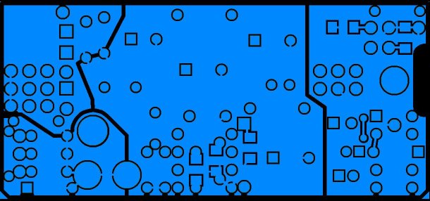

Imagine this senario. You have a printed circuit board with one or more plane layers, as for a ground plane. The circuitry on part of the board produces electrical noise that cannot be allowed into another part, and yet they need to be connected to each other. You may have to cut the ground plane so each circuit has its own, and then join them at only one point, where you can control the noise. Besides having bypassing and possibly other filtering at that point, the cutting of the plane means ground currents from one part of the circuit won't be running across the other part and producing IxR (ie, voltage) drops against which signals get referenced. The "chainsaw" line effectively cuts through the plane layer(s). Even if the only planes are on inside layers, you can clearly see the chainsaw line if you hold the board up to the light, since the board will be translucent there. I've used this to keep computer noise and switching-power-supply noise out of the audio.
I had forgotten about this but I've had gerber viewer software for a couple of years or more so I can now just put up a picture. I do my CAD in DOS on another computer so I couldn't even do a screenshot before. This is the ground plane layer of a little board I did a couple of years ago:
(It shows up on my monitor about three times actual size.) This one is cut into four sections. Three of them are joined at strategic points where switching power supply noise can be controlled and kept out of the audio.
