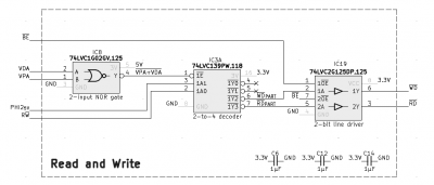

Just for Ardis, if you haven't come across it yet. This is the '139 RWB to /RD /WD circuit Yuri mentioned:
It converts the 816's RWB signal into a pair that can be used with the Read and Write pins on an SRAM or such. You don't need the 74xx125 line driver if you don't need to respect BE. You also don't need the 74xx02 NOR gate if you're happy not turning off /RD and /WD when there is no valid address. But personally I would keep it.

AndrewP wrote:

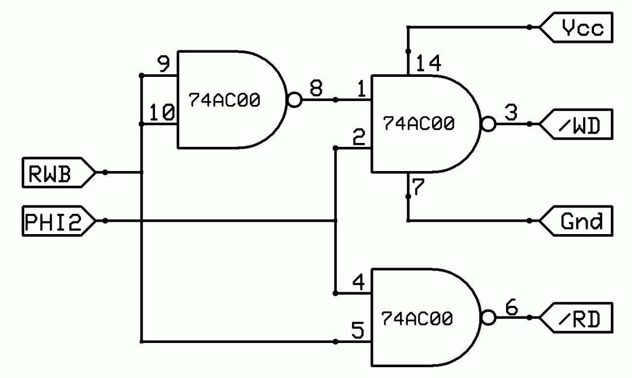

This is the '139 RWB to /RD /WD circuit Yuri mentioned...
Qualification of RWB with VDA and VPA is unnecessary—doing so merely consumes silicon.  VDA and VPA are best used to qualify chip selects, especially for I/O hardware that may react badly to false address bus states that occur during so-called dead cycles.  My very first POC unit was a victim of address bus hinkiness until I bodge-wired VDA and VPA into I/O decoding.
The generation of /RD and /WD can be accomplished with a single 74xx00 NAND, e.g.:
File comment: Qualified Read/Write w/74AC00
The above shows use of a 74AC00, but any of the 74-series CMOS types would be fine, e.g., 74AHC00.
