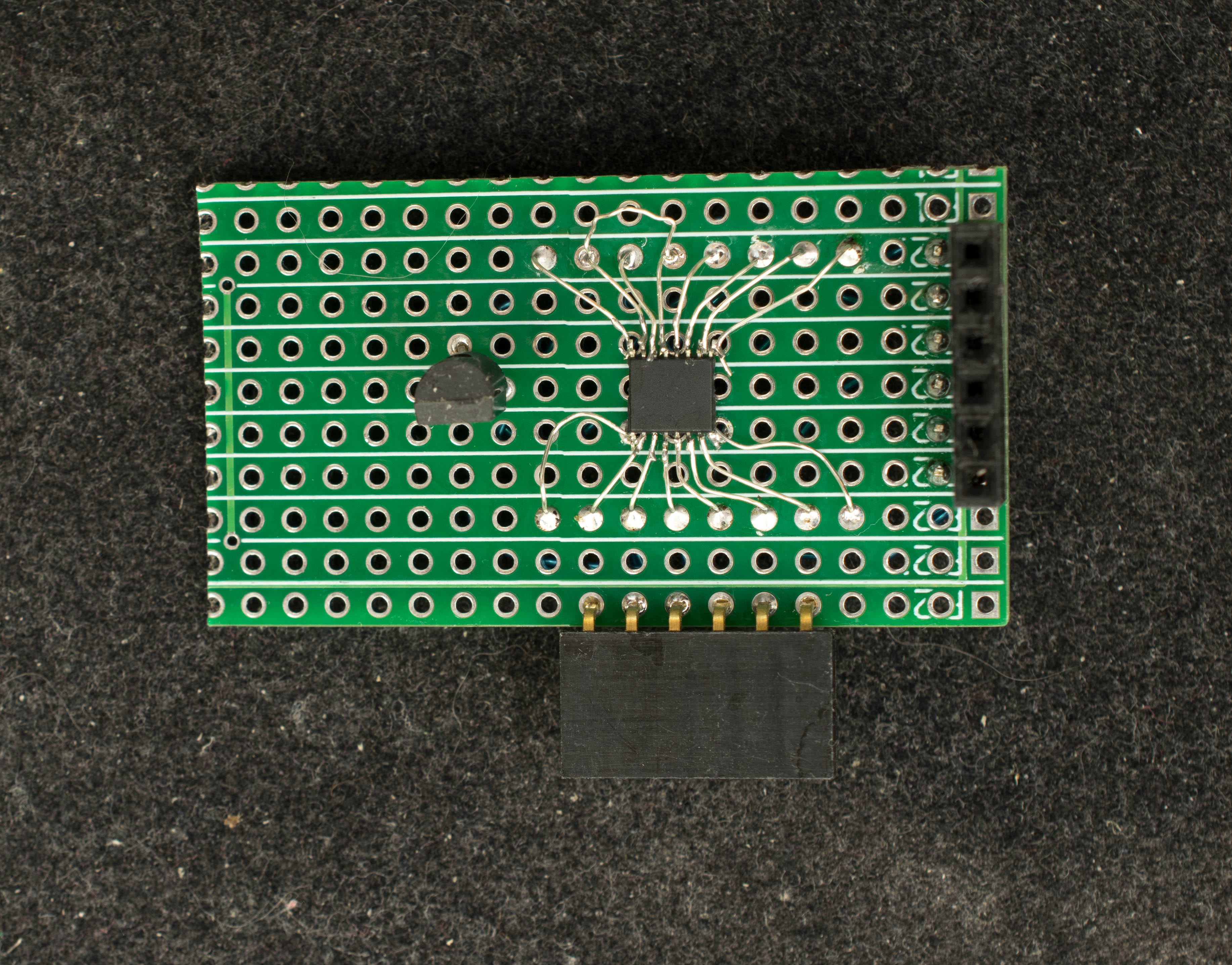

Well, the 16is750 a 16550 register-compatible UART that's still around (although seemingly only in a HVQFN-24 package). :| But the reason it doesn't have a zillion legs is, it's not bus-driven. Instead, the host interface is SPI (or I2C, depending on whether a certain pin is tied high or low).
So, not quite the same animal. But it's possible to make a little module that plugs into a DIP site (as I did with this now-obsolete 24-TSSOP version)...

Yabbut... there's something a bit weird about using a serial interface to, um, talk to a serial interface... kinda non-intuitive.
Though I suppose the big advantage is the self-clocking nature of SPI (I'm not a fan of I2C).
I'd love a parallel memory interface with perhaps a couple of addresses for internal registers, one chip select, one interrupt output, rx and tx, none of the control signals - kind of a cut-down 6850 I suppose. Should fit easily in a 20 pin chip.
I agree there's some irony there which may be amusing. :) But we know irony isn't seriously a factor when deciding how to provide UART capability in a given setting.
The pros and cons of various approaches will differ in importance according to circumstance. For example in a design which needs to be small, or which one intends to overclock, a parallel-interface UART loses points for complicating the address-decode glue, adding capacitance to the bus and increasing its length. In fact there'll be an incentive to de-populate the bus as much as possible (especially if it'll avoid wait states), so one might quite reasonably end up with just a single peripheral on the bus -- a VIA, perhaps -- which, using SPI, manages multiple I/O devices (not just the UART).
