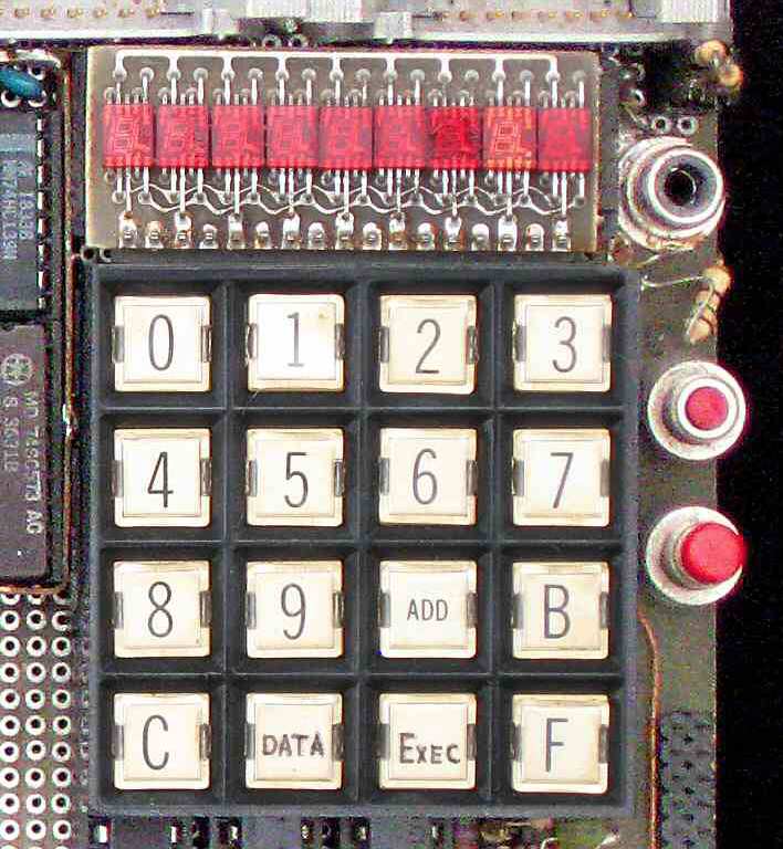

Just use a 4x4 with one of the keys being a shift key.
Yup. :) Or -- similarly -- the monitor facility on my KK Computer has a shift function, but shift is invoked using a pushbutton that's external to the keypad. Thus the hex digits from 0 to F can all directly appear on the keypad itself.
I chose to have shift-A mean, "switch to Address entry mode." Shift-D means, "switch to Data entry mode," and shift-E means Execute starting at the currently displayed address. The other keys also have a "shift" interpretation, but I can't remember what they are -- I would have to refer to my records! :lol: :oops:
(Oh -- and the other red pushbutton is reset. I trimmed its plastic knob because I wanted reset to be more difficult to actuate.)
