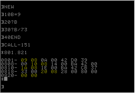

Posts: 1929
BillG wrote:
Except that storing the length of the line instead of the address of the adjacent line is that it does not need to be adjusted when lines are inserted or deleted.
Yeah, I never understood why Applesoft and friends used 16-bit absolute line links instead of 8-bit relative. It seems like a waste of a perfectly good byte for every line and adds an unnecessary burden to the line editor when inserting/deleting.

8-bit relative has its price at run-time: an addition or subtraction involving the line's actual address.
PostPosted: Sat Mar 09, 2024 1:41 am
Posts: 1929
The 6502 does it in such a way that the difference is negligible, and in fact slightly favors the relative technique:
nextln:
    ldy  #0         ; [2]
    lda  (txt),y    ; [5]
    clc             ; [2]
    adc  txt        ; [3]
    sta  txt        ; [3]
    bcc  next99     ; [2*]
    inc  txt+1      ; [5]
next99:
    ...             ; best case 18, worst 22
nextln:
    ldy  #0         ; [2]
    lda  (txt),y    ; [5]
    tax             ; [2]
    iny             ; [2]
    lda  (txt),y    ; [5*]
    sta  txt+1      ; [3]
    stx  txt        ; [3]
    ...             ; best case 22, worst 23
PostPosted: Sat Mar 09, 2024 1:48 am
Posts: 690
Location: North Tejas
Touché
How could forget that the 6502 is not like the 680x where I can simply do
ldx 0,X
