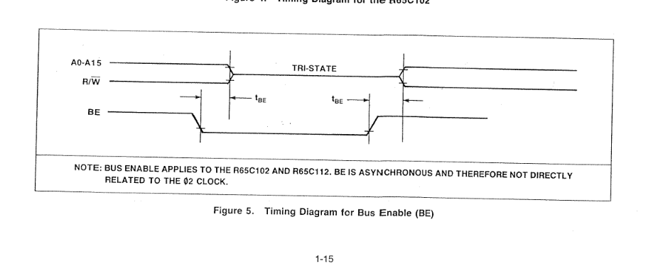

EDIT:
Looking at the Rockwell datasheet (here https://web.archive.org/web/20221112220 ... essors.pdf) there is the timing diagram for BE on page 1-15 (see attached picture), which has A0-A15 and R/W going into tri-state, but the databus is oddly absent. Hm.

sburrow wrote:
I'm thinking of doing unconventional things to the '816.
Attaboy, Chad! :twisted:
Sorry I'm rushed ATM, and haven't fully reviewed the details of what you're proposing here. But as for...
What if I hold BE low during all read cycles? Will whatever is on the databus still reach the internals of the 65816?
... I'm inclined to say the answer is yes. I mean, if the answer were no, what could possibly be the reason?
I can't imagine the chip designers included any extra logic specifically to accommodate the extraordinary circumstance of inputting data from a bus access that's been prevented from outputting an address! Virtually nobody is worried about this, so they have no incentive. And even if they for some reason did want to do something about it, what remedy could they apply?
From another line of reasoning, the simplest way to implement BE is to merely run that signal to the on-chip logic that enables the output buffers. Doing so will provide the functionality that users require, and I can't imagine why they'd wanna run BE anywhere else. But perhaps my imagination is having an off day today!

I think for me the most likely answer is that BE disables the output drivers, and that won't affect the inbound data. I'm not quite sure how you plan to make use of this but an initial experiment will probably enlighten both of us!
