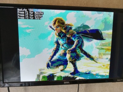

Now! Attachments! Registers! Errors! Confusion!
As shown below, I am able to use the PIC to load from the SD card again, but this time it also includes code. And that code is running! Kind of! The picture looks great, I jump to the start of code (which is included with the picture data but in the V-Blanking area), and it has the ability to blink a pixel in the top corner. That's a sign of life :) But that's all it's doing. In fact, I had my "printchar" subroutine copied over to the code, and although the simulator shows the 'A' character, my actual hardware does not.
YET it still does the blinky pixel AFTER trying to print the character. Huh? That makes me think there is something I really don't understand about the '816 in native mode. I *feel* like the registers are being cleared or corrupted or something. I can JSR and RTS just fine, anything more complex and it gets weird. My first instructions look like this:
CLC
XCE
REP #$08
SEP #$34
The REP #$08 turns off decimal mode, and the SEP #$34 keeps it in 8-bit mode with interrupts off, right?

What is DBR (data bank register) set to? Unless you've changed it somewhere, it's set to 0 by reset.
My guess is that you have PBR=$3e (the bank your code is in), maybe set by a JSL, and DBR=$00 (not modified after reset).
IF this is true, your JSR absolute and branches will work as expected, bur your absolute data references will be happening in bank 0.
   JSR printchar_store       will push 2 byte rts addr & jump to $3Exxxx

leepivonka, thank you thank you thank you! Hot dog, it works! See attached pictures :) Wow, I *really* had a fundamental misunderstanding there. Thank you for seeing that, so awesome to see it doing complex functions now! If I saw you in person I'd hug you! :D
This is what I inserted:
LDA #$03
PHA
PLB
And so the next (and last) thing I want to get rolling right now is the keyboard. And it's not working, probably because the interrupts are doing something very similar. The keyboard works for my fallback monitor, but not in my new demo code, probably for the same reasons: a register is not set correctly. Will be continuing to work on that. Once the keyboard is functioning then I can start to rest, or perhaps just push harder :)

Whelp, that was fast! Keyboard is now working (mostly) as expected, yay! I just changed the addresses in my ISR from absolute to absolute-long, and copied my fallback monitor VIA code into the demo code. BAM, that did it!
So many more hardware things to get working. The keyboard isn't great for Tetra right now, but that's all software. After that is the vertical scrolling and then getting my latest demo code with the editor to work.
After all that I want to try to get the PIC to speed up it's reading from the SD card. It currently takes about 1.5 minutes to load 128KB from the SD card. That's a LONG time. Some things I'm considering is speeding up the PIC from 4 MHz to 8 MHz, and perhaps running PIC assembly code directly rather than through a C compiler. I'm super scared to even *touch* the darned thing since I've been fighting with it for a week now. I'm happy it's working but golly what a ride!
Y'all have been seeing a whole bunch of Link today :) I guess it's that or the Gouldian Finch, should probably try that too soon. Just wanted to show off those colors! I'm really contemplating doing the little color change George suggested, that sounds like it would be really neat.
