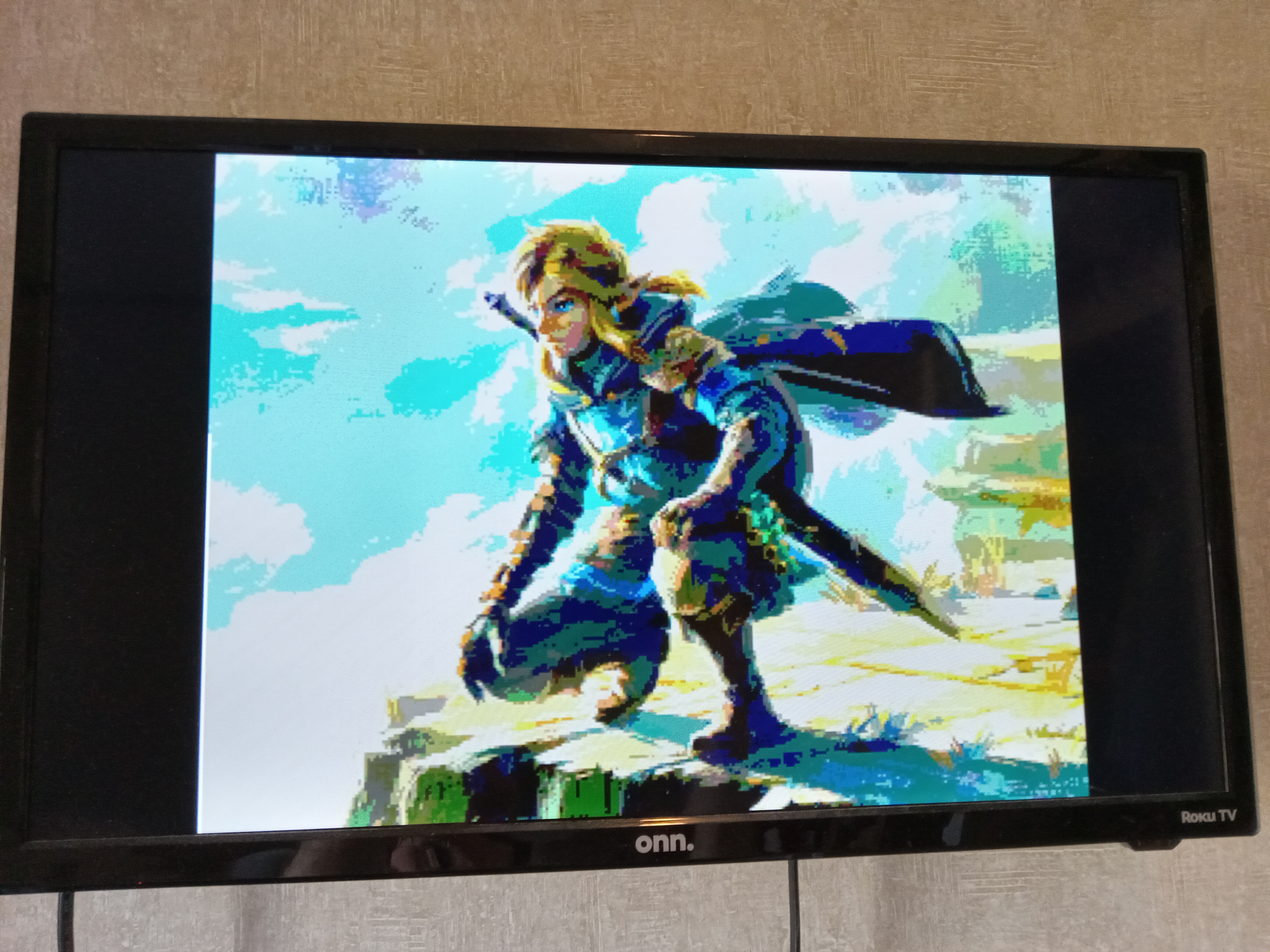

Hello everyone!
The time has finally come for me to show to you my latest single board computer: The Acolyte '816 Computer
This is a 4" x 4" four-layer board with a mix of surface mount and through-hole components. I used solder paste and a skillet for the QFP packages (the 65816, the 6522, and the XC9572XL CPLD). Those were the easy ones! The rest are mostly SOIC packages which I soldered by hand. The two 512KB RAM chips are SOJ and that was much harder than I thought! I made as many components through-hole as possible so that my 5 yo daughter was able to help solder them for me. She did all of the capacitors, the DIP socket, and some of the resistors. She let me finish up the connectors myself :)
The '816 runs at 12.5 MHz, half of the 25.175 MHz VGA clock speed. Thus the video is active on PHI2-low and the processor is active on PHI2-high, just like all of my previous Acolyte builds. The problem here was to capture the '816s bank addresses during PHI2-low, as well as letting the VIA be selected on the rising edge of PHI2. The solution was a bunch of '245 transceivers!
This SBC is capable of displaying 64 colors at 320x240 or mono at 640x240, at the same time side by side. The way this is done is by dedicating the upper two bits simply to black and white, while leaving the lower 6 bits for color. For example, 0xC0 produces white for text, while 0x3F produces white for color. The text and color both seem pretty crisp, even on a 'smart' TV with a VGA-to-HDMI adapter (though these pictures are blurry it seems). Using the CPLD, it is also capable of hardware vertical scrolling, allowing for better use of the 80-column text and perhaps in some types of video games.
It also is a "ROM-less" design. Right now I am storing 512 bytes of bootloader code on the PIC16F886, which spoon-feeds the '816 upon startup. After that, the '816 can take over, or the PIC can continue to spoon-feed data from the SD card. The PIC's databus is connected directly to the VIA, so after boot the '816 can still talk to the PIC at any moment.
Some of the peripherals I chose were the PS/2 Keyboard and Mouse, on separate ports now. It also includes a 3.5 mm audio jack for 1-voice square wave audio from the VIA's T1 timer, two ports for Sega Genesis controllers, and a 6-pin connector for an FTDI USB adapter (which came in REALLY handy when debugging the PIC!). This machine is meant to have two-player video games, but also things like text editors and paint programs. All of this is powered by a 5V USB wall-wart.

Sorry for all your wasted efforts, but you were no longer a novice long times ago. By tackling video logic first, you've bypassed the algebra and went directly to differential equations and very successfully, by all accounts.
SOJ components are much easier to solder if you have longer finger pads where solder tip can preheat before applying the solder.
Great job, a masterpiece, indeed.

Excellent work, I've always especially liked the way you compete your designs into well-rounded devices with a broad set of functionality. And as Bill said, you are way beyond novice!
The way you do the graphics and text in one data stream is interesting too, I thought about something like that once. Does it overlay the high resolution text on the graphics colour? Did you consider instead making the text layer multiply the graphics layer, to allow text of any colour on a black background, instead of white text on a coloured background?
I don't know about multiplying or adding, but they actually *can* be utilized at the same time. So, theoretically I can have (brightly) colored text, and theoretically I have access to 128 colors. But what happens is the voltage levels on the video circuit exceed the 0.7V maximum, I think reaching to 1.0V. Still, the VGA-to-HDMI adapter doesn't seem to care much, and it actually makes the color pixels look dimmer without the added brightness coming from the 'text' bits.
Though I don't think that answers your question :) I guess my best answer is that I can put them together to get high resolution color, but there are some limitations to it.

sburrow wrote:
Ah I see, you're combining them in various combinations through resistor adders. I guess in effect the text bits act a bit like intensity bits in 16-colour VGA palette, pulling the colour up towards white or down towards black. I think this would still mean you're restricted to having the text background colour be the "dark" version of the text foreground colour. But as it's all done with passives it will be quite compact, and it means you actually have 128 colours, not 64, as there are light and dark versions of all the colours!
I had a look at your schematics and I have attached a summary of how your "red" output works:
On the electrical front, if I've got this circuit right, I'd be a bit concerned at the 3.3V input to the 74AHCT08, if that label name is accurate; and also the loading on its outputs, as it's often going to be driving 5V through 480 ohms one way or the other, when one gate is outputting high and the other low; that's 10mA. I haven't checked the specs but it feels quite high.
I'm pleased to see that you're not suffering from glitches between pairs of pixels with this setup - when I tried something like this I found that at the point the latch (your 74AHCT273) is reloaded, it was hard to get the multiplexing (done by your AND gates here) to switch at exactly the right time - so I avoid that sort of system at the moment. It looks like you've managed that well though.
On the whole I think your circuit is performing an additive blend, and there are going to be some interesting effects on brightness from the various combinations of highs and lows. It also means you can set or clear both high bits together to brighten or darken the graphics colour, effectively getting an intensity bit like with 16-colour VGA.
Going back to what I was suggesting in my last post, an equivalent would be to replace R3 and R4 with low-voltage-drop diodes, so that these signals can pull the "graphics" colour down to (almost) black, or let it remain at whatever colour it's meant to be - this is what I meant by "multiplying" the text layer with the graphics layer. I don't know whether you'd prefer the result or not, but I think it would give richer options for text colour, with the constraint that the text background would now always need to be black, and you'd be back to just 64 colours, rather than 128, as you'd no longer have the bright and dark versions of them.
Apologies if that doesn't make much sense - I'm in a bit of a hurry - but happy to elaborate or discuss more later!

Thank you everyone. I'm still not out of the woods yet though! Having problems interfacing with the PIC still, and some of my bodges are so delicate that I've had to resolder them three times already! To me, the PIC is acting weird sometimes, just plain looney-land, so I'm constantly starting back at simple code and trying to add tiny pieces along the way. It is a constant battle. I was able to revert back to my fallback system monitor, but the SD card image stuff I just cannot replicate at this time! :| Once the PIC is done loading the bootloader code, the '816 does great, but when it asks the PIC for additional data it acts sporadically it seems. I had MANY issues like this along the way, mainly databus contention. Here I wonder if it's some PIC register not cleared or something, IDK. Arg.
OH! Now that makes sense! Hm, that is an interesting proposition! And, I would simply replace these resistors with diodes, which would be very simple to do on the board. Hm, cool idea George, I'll be considering that (once things are less PIC-ky, har har).
