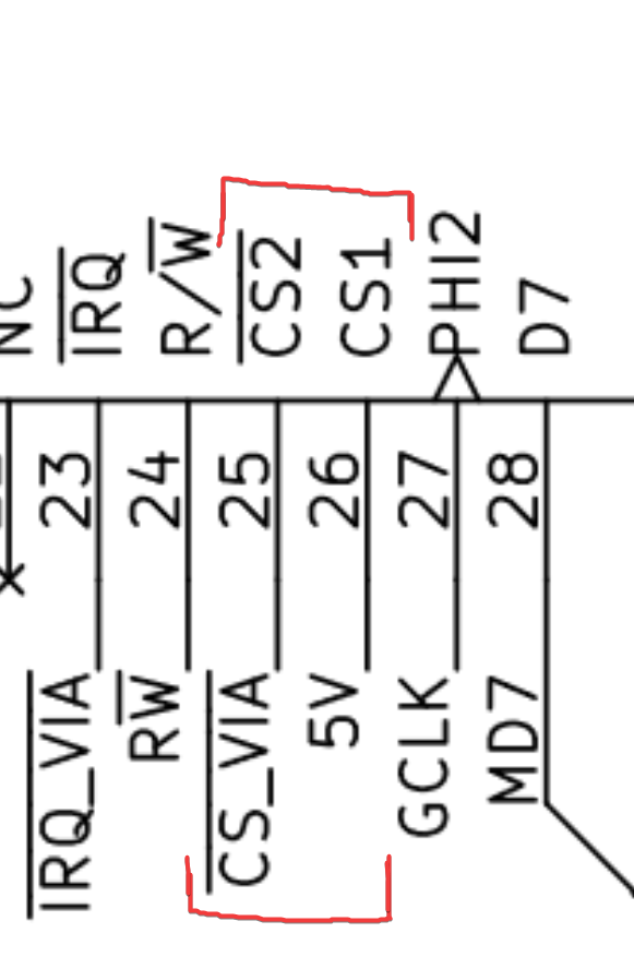

Proxy wrote:
maurice6502 wrote:
CS0 signal is active low to select base address for device access, pins 13-14 (BA0 - BA1) are used to select 4 "pseudo" registers; BA2 at pin 2 is a further addressing to allocate more 4 bytes for polling flags
check the datasheet again, the 65C51, similar to the 65C22, has 2 chip selects: CS0 (pin 2) is active high while CS1 (pin 3) is active low. so the chip is only "selected" when both CS0 is high and CS1 is low.
but on your board only CS1 (pin 3, renamed to CS0) is being checked while the original CS0 (pin 2, renamed to BA2) is repurposed as an address line, which can and likely will cause issues in existing systems.
so overall it's not actually 65C51 pin compatible.
You are right, but this expedient only affect base address of device; BA2 is CPU buffered Address 2(weight 4) , this move base address (selected with CS0 that come from one external HC138) at +4 . This involve that base address should be moved +4 but 6502 code must anyway be modified and code recompiled..
This device is hardware compatible, not software..

oh i think i see what you mean... you assume that CS0 (pin 2) is always tied to a CPU address line, in which case you are right and it would function, but keep in mind that that case is not guaranteed.
for example a system could simply tie CS0 (pin 2) directly to 5V and only use CS1 (pin 3) to select it. or the other way around, tie CS1 low and only use CS0. both cases are perfectly valid according to the datasheet but niether would work with your board.
as practical example: the 65C22 on my 65816 SBC. i have CS1 always pulled high, and only use CS2 to select it (names are off by 1, but you get the point).
