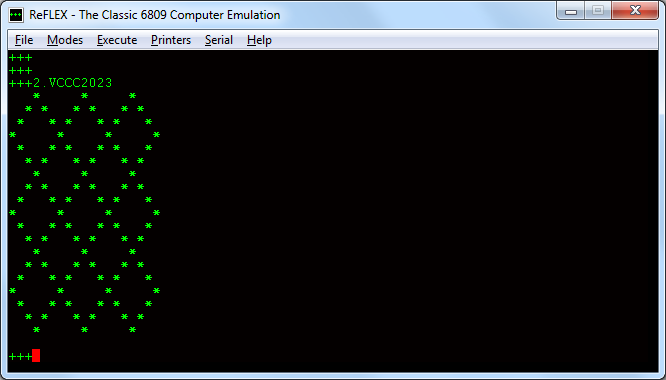

OK, I grit my teeth and prepared a single entry - the 6809 one because:
* it is the smallest of the four
* there is an emulator available which is very easy to install and use
Because I seriously object to being judged on the size of the source code, I spitefully compacted it:
* Removed all comments
* Removed all unnecessary white space
* Use single letter labels
* Replaced all equates with magic numbers
* FLEX text files use only a CR to separate lines, so I removed all line feed characters
* Historically, FLEX assembly language programs were written with a single space before the instruction mnemonic and a single space between it and any operand; the assembler "autofields" as it creates the listing
Because that is so danged mean, I included an assembled listing of the "normal" commented source code. The compacted source code file is less than one sixth the size of the "nice" one. Take that, stupid rule makers...
I will post the code for all four here in a little over 24 hours so that it is Boxing Day on the East side of the International Date Line.
Edit: I guess it is OK to include a screenshot...

54 bytes of instructions plus a 16-byte table that I zig-zag through several times.
Very well done indeed!
It was immediately apparent that there were four different lines in the object. And each line can be broken down into a series of spaces (possibly none) followed by a star.
At first, I tried to avoid storing duplicates of lines by using a list of line addresses. It turns out that the code to handle those addresses took up more space than the lines saved.
So I ended up using one long string of couplet descriptors.
I also looked at trying to extract some savings from the repetition of a pattern within each line, but could not figure out how to effectively make that work.
The object can be viewed as consisting of a row of diamonds repeated three times. Except that the line of three narrowly separated stars is not repeated between rows of diamonds.
The solution was to omit the top line of stars from the image but emit the bottom line at the beginning for the top line.
Without further ado, this is the first version for the 6800. It has 49 bytes of code and 39 bytes of data.

This is the file ID from my submission:
VCCC2023 in 6809 Assembly Language for FLEX
Author: Bill Gee
Category: Christmas Challenge
System: 6809 Computer (SWTPC compatible) running FLEX
Language: Assembly language
Len source code: 290 bytes
Len exe file: 93 bytes
Len code only: 47 bytes of executable code, 39 bytes of data
Instructions:
Download and install ReFLEX
http://datapipe-blackbeltsystems.com/wi ... tml#reflex
Open VCCC2023.DSK as diskette #2
"2.VCCC2023" to run.
If you want to assemble the source:
ASN W=2
ASMB VCCC2023
RENAME VCCC2023.BIN VCCC2023.CMD
Description:
The image can be decomposed into four unique types of lines, each
consisting of several space-star couplets.
A couplet is a number of spaces, 0..5, followed by a star.
-1 spaces denotes the end of the line.
-2 spaces denotes the end of the image.
The rows of diamonds repeat three times.
Because the line containing the three narrowly spaced stars are not
repeated between rows of diamonds, a row of diamonds does not include
the top row; the bottom of the previous row provides those.
That means we must begin by emitting that "bottom" row as the very top row.
Comments:
ZIP file contents:
FILE_ID.DIZ - This file
REFLEX.PNG - Screen shot of program run in ReFLEX emulator
VCCC2023.TXT - Source code in FLEX format
VCCC2023.CMD - Assembled executable
VCCC2023.DSK - Virtual disk for use with ReFLEX
VC9-2023.LST - Assembly listing of commented and uncompacted source code
Oh yeah, Merry Christmas!
