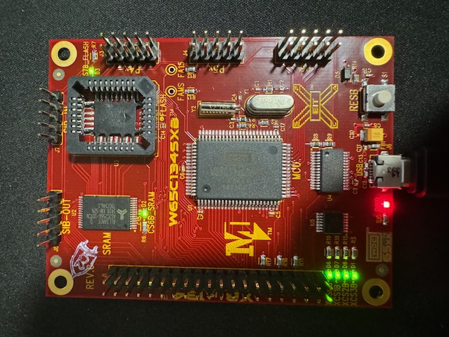

Hi all, I am new to the 6502 space, and as a embedded SWE I have found that there are simply too many bits in my day. So, I decided to buy a W65C134SXB as a Christmas present to myself.
Now, I have been following the Getting Started Guide, and installed the requisite drivers for the FT232. However, I am getting no serial port connection whatsoever. Running up Device Manager shows no active COM ports. Attached is the curreny visual state of the board, with some lovely LEDs lit. Any insight into this would be appreciated, I could well be missing something blatantly obvious, but I am getting the uneasy feeling that I may have a defective board here, possibly due to inadequate shipping from Mouser.

Noted, and book marked. I happy to report that this was operator error. The micro usb cable I had to hand was power-only. This is a humbling start, and a lesson to always check the cables.

And yes, I've seen that issue too - with a cheap USB cable. The on board firmware tries to use hardware handshaking and (I think) if there is no serial then it gets confused. The LEDs are active low so come on until some code initialises the port and sets their outputs high.
