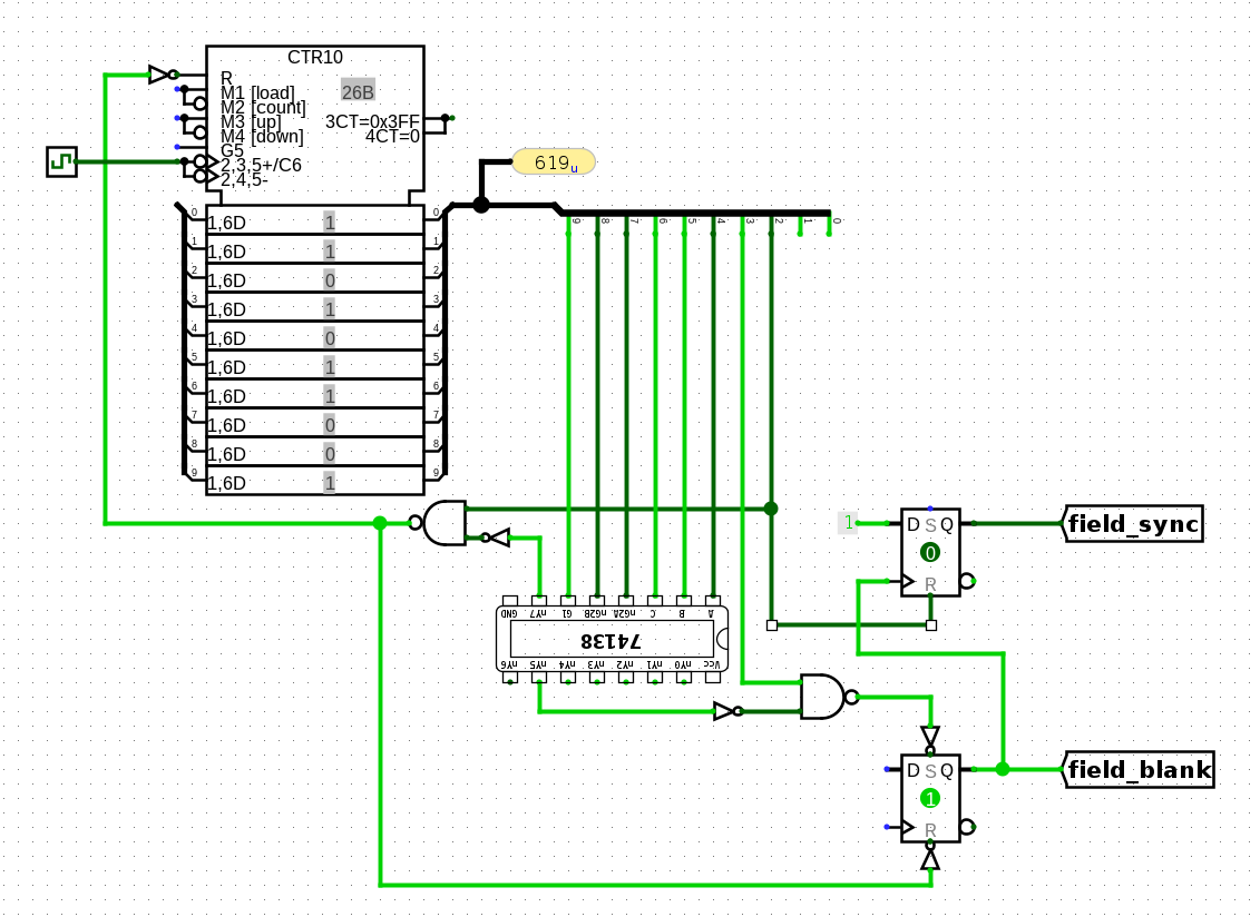

Anyway, disgraceful or not, here's a field generator for svga (600 vertical pixels, another 28 lines of blanking and vsync). There are a couple of inverters not required in a TTL interpretation, and one missing. I also make the dreadful solecism of moving the field sync one line forwards: it starts on line 600 for four lines instead of line 601, but it simplifies the logic. I'm working on the basis that the reason for the back porch is to allow an analogue monitor time to get the beam back to the top of the screen; the front porch is largely irrelevant.
The counter doesn't need to be synchronous; I think one-and-a-half 393s will do here, using the lots-of-adders approach to generate the contiguous memory addressing.
We'll see if it works when/if I bolt it together... now to look at the line timing. I suspect a similar approach.
edit: Looking at it, those two inverter-nand combinations could each be replaced by half a 139, saving a chip. Depends if I need inverters and nands elsewhere.
edit 2: or I could use a 238 instead of the 138, with positive outputs.
