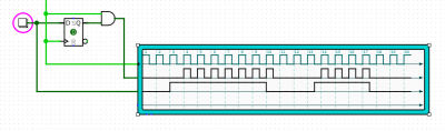

To stop the 65c02 I believe I need only ensure that ph0 is stopped low: viewtopic.php?t=939
This is easily done with a d-type and an AND gate.
The clock output stops and starts in the correct phase irrespective of the phase in which the switch occurs, so the STM needs to pull the clock enable low when it needs the bus, pull BE down either after monitoring the clock or just waiting one clock period - 400ns - and it's just fighting the resistors from the video ram address generator. If it does it during blanking, then the VRAG doesn't care; the data isn't displayed.
