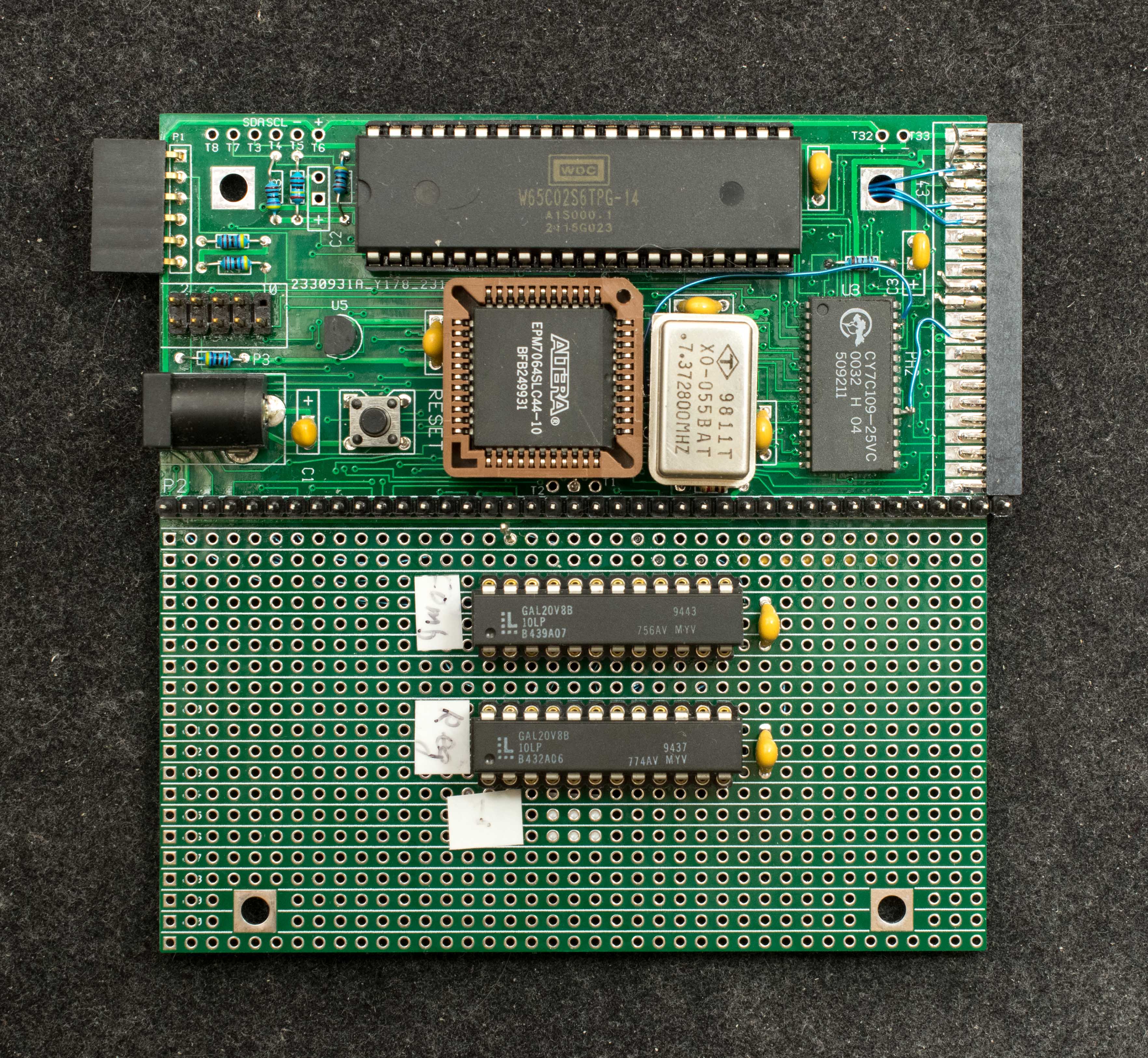

I ordered a batch of GAL22V10 from eBay, but they turned out to be fakes--they are writable but not verifiable.  I returned it and ordered another batch from different vendor.  In the meantime I have an unknown old batch of GAL20V8 that programed and verified OK, so I'll try it while learning about WinCUPL.
The CF bootstrap circuit should fit a GAL22v10, but needed two GAL20V8 to fit, at least with my current understanding of WinCUPL.  I've split the design into state machine GAL20V8 with 5 registers representing various states of CF disk, and combinatorial GAL20V8 driving the CF signals.  New design, new (old) device, new (old) design software, so I expect problems. I'll breadboard it and find a way to test it.
Since the CPLD-based CF bootstrap is working as described in previous posts, I'll build the GAL20V8 implementation in parallel and compare their outputs to CPLD. Here are pictures of the two GAL20V8 in parallel with CPLD-based design.
When I received GAL22V10, I'll also prototype it in parallel and compare its outputs with working hardware.
