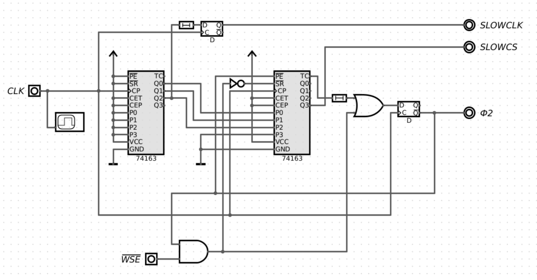

So here's the circuit I've designed to do it, extended from DrJeffyl's circuits:
Simple clock stretching to match a derived, half-rate clock signal
Note that in this circuit WSE has been inverted - so the signal feeding into the NAND gate is high if the cycle should be a fast cycle, and low if it should be slow.
As with DrJeffyl's circuit, the input clock oscillator is double the frequency that PHI2 generally ends up being (e.g. CLK=32MHz, PHI2=16MHz); but here we also have SLOWCLK which is half of the regular PHI2 frequency (e.g. SLOWCLK=8MHz). I have some other circuits for greater divisors, in case you need the slow clock to be even slower, but I'll post those separately.
The main change in this circuit - from DrJeffyl's 163-based circuit - is that counter U2 that generates PHI2 has its low bits loaded from counter U1, which generates SLOWCLK. These bits can be interpreted as a negative number which says how many clock ticks are needed before the falling edge of SLOWCLK - e.g. if they were both set, that would represent -1 in two's complement, imagining higher bits are all set, meaning that one more tick is needed before the falling edge of SLOWCLK - which is indeed the case because on the next tick U1's low bits will roll over to 00. However, as both U1 and U2 are driven by the same input clock, U2 is going to lag a clock cycle behind U1. To remedy that, the relevant output of U1 is passed through a separate D flip-flop (U4A) to form SLOWCLK before being used in the rest of the circuit, bringing it back into sync.
Whenever PHI2 is low, U2 will be reloaded with its high bit set, its next lower bit clear, and the lowest two bits taken from U1. This means that U2 will tick for 1-4 more cycles until a falling edge of SLOWCLK, then 4 more cycles, all with its top output bit (PHI2) high, and then wrap around to zero causing PHI2 to fall in sync with another SLOWCLK falling edge in at least 4 CLK ticks' time. These 4 guarranteed ticks ensure that there will definitely be a low and then high phase of SLOWCLK in the meantime.
U2's second-highest bit is initialised clear, but will get set after the next falling edge of SLOWCLK, and then stay set until PHI2 falls. This is exactly the signal we need for SLOWCS - it is high during the specific low-then-high phases of SLOWCLK, and low at all other times.
The final extension to DrJeffyl's circuit is the input to U2's /MR pin. If this is high, then U2 will tick through a stretched cycle as described above; but if it is low then U2 will get cleared to zero on the next CLK tick, causing PHI2 to go low. We use this to curtail the stretched cycles if PHI2 is high but the incoming WSE signal does not request stretching. This means that unstretched cycles only have one CLK tick in the high state before going low again.
Low phases of PHI2 are always just a single tick because U2's /PE pin is driven by PHI2, so when PHI2 is low we always load U2 with its top bit set on the next cycle.
I hope this explanation makes sense - there's quite a lot going on in a rather small circuit. I have built this on a breadboard for testing, and wired it up to an Arduino Mega to run a full test suite of all the various phases that PHI2 and SLOWCLK could be in. I'll post the output of that test program below, but here are some waveform diagrams to illustrate:

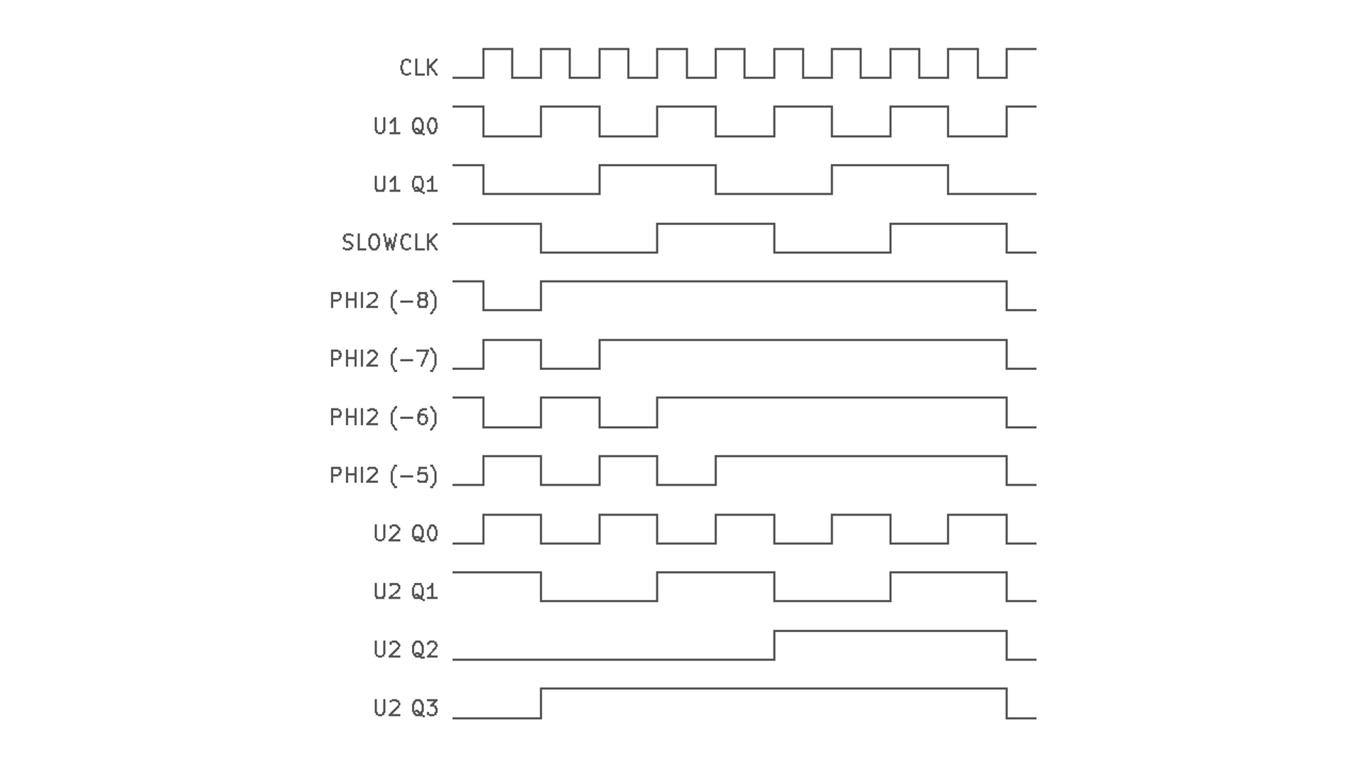

Waveforms for critical signals in the circuit, when WSE is asserted near a rising edge of PHI2 with at various points during SLOWCLK
This shows the critical signals in the circuit. It includes four separate PHI2 lines, covering the various phase relationships. In each case assume WSE was raised around the rising edge of PHI2 in one of these lines - it could occur before or after it without affecting the result. In the first PHI2 trace, this occurs at the same time as a falling edge of SLOWCLK, and we load U1 with the value -8, and wait in fact for two full cycles of SLOWCLK before continuing. This ensures we get a full low phase of SLOWCLK with SLOWCS high, even if WSE was late arriving. The next trace down shows the response when PHI2's rising edge was one CLK tick further in, and in this case U2 gets loaded with -7, and so on. The lower traces in this diagram show the states of the outputs of U2 for the PHI2(-8) case in particular.
Some of these phases are actually going to be quite rare - they'd only occur on initial startup, as once PHI2 has been synchronised with SLOWCLK once, it will only change phase by a multiple of two CLK cycles at a time. But it's still important to handle those cases, otherwise it would never get in sync, so my the Arduino has a way to force it to happen, and test the result. the Arduino code also tests WSE rising or falling on both sides of the leading edge of PHI2, to make sure both behave the same way.

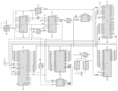

I have designed this circuit into a simple 6502-based computer to test it out further, but not built it yet:
Full 6502-based computer schematic based on this clock stretching technique
I'm expecting this to be able to run into the 30+MHz range, as the CPU/RAM core is the same as in my fast PDIP design and there aren't too many I/O devices to bog things down. The address decoding is also quite coarse but it should be fine to tighten that up and add more RAM in the upper half of the address space. It will make WSE more complex to determine, but it doesn't really matter much if that is slow, so long as it's ready by the end of the usual PHI2-high phase.

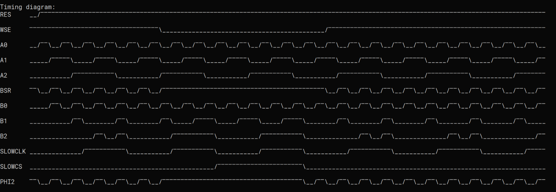

Okay, I think I've got it, and I'm honestly proud of myself to finally be able to do something useful with my GAL besides address decoding & clock dividers. :D
Of course, all credit still goes to gfoot! I merely converted his design into GAL equations.
Some notes:
- I've added /RES input to ensure all registers are in consistent state. It can be driven directly by your computer's reset circuit.
- First '163 Q-outputs are A2,A1,A0 (A3 is not used)
- Second '163 Q-outputs are SLOWCS,A2,A1,A0 (since A3 is directly tied to SLOWCS)
- Second '163 equations are duplicated so that the counter can be cleared with NAND(PHI2, /WSE) - which is represented as /PHI2 + WSE as per DeMorgan's theorem
- SLOWCLK division can be configured by changing the equation to use A1 instead (unfortunately, there's no way to use A3 since we're out of GAL outputs and thus we're not counting A3)
- SLOWCS can easily be made active-low by inverting its pin definition (line 5)

riginal thread: http://forum.6502.org/viewtopic.php?f=4&t=7798
'22V10 was barely enough to keep all the stuff, but my hunch turned out to be correct - 10 registers is all we need for this task.
I've slightly simplified the schematic to be more GAL-friendly:
I haven't tested all the edge cases, so here's the basic test I did (my recently developed GAL solver turned out to be surprisingly handy here :lol:)
RES     __/‾‾‾‾‾‾‾‾‾‾‾‾‾‾‾‾‾‾‾‾‾‾‾‾‾‾‾‾‾‾‾‾‾‾‾‾‾‾‾‾‾‾‾‾‾‾‾‾‾‾‾‾‾‾‾‾‾‾‾‾‾‾‾‾‾‾‾‾‾‾‾‾‾‾‾‾‾‾‾‾‾‾‾‾‾‾‾‾‾‾‾‾‾‾‾‾‾‾‾‾‾‾‾‾‾‾‾‾‾‾‾‾‾‾‾‾‾‾‾‾‾‾‾‾‾‾‾‾‾‾‾‾‾‾‾‾‾
WSE     ‾‾‾‾‾‾‾‾‾‾‾‾‾‾‾‾‾‾‾‾‾‾‾‾‾‾‾‾‾‾‾‾‾‾‾\____________________________________________/‾‾‾‾‾‾‾‾‾‾‾‾‾‾‾‾‾‾‾‾‾‾‾‾‾‾‾‾‾‾‾‾‾‾‾‾‾‾‾‾‾‾‾‾‾‾‾‾‾‾‾‾‾‾‾‾‾‾‾
A0      __/‾‾\__/‾‾\__/‾‾\__/‾‾\__/‾‾\__/‾‾\__/‾‾\__/‾‾\__/‾‾\__/‾‾\__/‾‾\__/‾‾\__/‾‾\__/‾‾\__/‾‾\__/‾‾\__/‾‾\__/‾‾\__/‾‾\__/‾‾\__/‾‾\__/‾‾\__/‾‾\__
A1      _____/‾‾‾‾‾\_____/‾‾‾‾‾\_____/‾‾‾‾‾\_____/‾‾‾‾‾\_____/‾‾‾‾‾\_____/‾‾‾‾‾\_____/‾‾‾‾‾\_____/‾‾‾‾‾\_____/‾‾‾‾‾\_____/‾‾‾‾‾\_____/‾‾‾‾‾\_____/‾‾
A2      ___________/‾‾‾‾‾‾‾‾‾‾‾\___________/‾‾‾‾‾‾‾‾‾‾‾\___________/‾‾‾‾‾‾‾‾‾‾‾\___________/‾‾‾‾‾‾‾‾‾‾‾\___________/‾‾‾‾‾‾‾‾‾‾‾\___________/‾‾‾‾‾‾‾‾
BSR     ‾‾\__/‾‾\__/‾‾\__/‾‾\__/‾‾\__/‾‾\__/‾‾‾‾‾‾‾‾‾‾‾‾‾‾‾‾‾‾‾‾‾‾‾‾‾‾‾‾‾‾‾‾‾‾‾‾‾‾‾‾‾‾‾‾\__/‾‾\__/‾‾\__/‾‾\__/‾‾\__/‾‾\__/‾‾\__/‾‾\__/‾‾\__/‾‾\__/‾‾
B0      _____/‾‾\__/‾‾\__/‾‾\__/‾‾\__/‾‾\__/‾‾\__/‾‾\__/‾‾\__/‾‾\__/‾‾\__/‾‾\__/‾‾\__/‾‾\__/‾‾\__/‾‾\__/‾‾\__/‾‾\__/‾‾\__/‾‾\__/‾‾\__/‾‾\__/‾‾\__/‾‾
B1      ___________/‾‾\________/‾‾\________/‾‾\_____/‾‾‾‾‾\_____/‾‾‾‾‾\_____/‾‾‾‾‾\________/‾‾\________/‾‾\________/‾‾\________/‾‾\________/‾‾\_____
B2      _________________/‾‾\__/‾‾\___________/‾‾‾‾‾‾‾‾‾‾‾\___________/‾‾‾‾‾‾‾‾‾‾‾\______________/‾‾\__/‾‾\______________/‾‾\__/‾‾\______________/‾‾
SLOWCLK ______________/‾‾‾‾‾‾‾‾‾‾‾\___________/‾‾‾‾‾‾‾‾‾‾‾\___________/‾‾‾‾‾‾‾‾‾‾‾\___________/‾‾‾‾‾‾‾‾‾‾‾\___________/‾‾‾‾‾‾‾‾‾‾‾\___________/‾‾‾‾‾
SLOWCS  __________________________________________________/‾‾‾‾‾‾‾‾‾‾‾‾‾‾‾‾‾‾‾‾‾‾‾\_________________________________________________________________
PHI2    ‾‾\__/‾‾\__/‾‾\__/‾‾\__/‾‾\__/‾‾\__/‾‾‾‾‾‾‾‾‾‾‾‾‾‾‾‾‾‾‾‾‾‾‾‾‾‾‾‾‾‾‾‾‾‾‾‾‾‾\__/‾‾\__/‾‾\__/‾‾\__/‾‾\__/‾‾\__/‾‾\__/‾‾\__/‾‾\__/‾‾\__/‾‾\__/‾‾
EDIT: FYI - the above equations have not been tested with a real GAL, and I have no idea whether they are truly doing what they should.
EDIT 2: Fixed some copy-paste typos in GAL assembly.
EDIT 3: I totally forgot to actually load B2..B0 with A2..A0... So the above code is totally wrong. I'll post updated version in the morning. There's at least one register that may be saved.
EDIT 4: Updated the post and the schematic (added few signal delays), I think it's now behaving exactly as it should.

Nice! What's the ".R" syntax, I haven't seen that used for these devices in the past - are you using a different compiler to WinCUPL? Normally I'd use ".D" here as we want the outputs to be configured as D flipflops.
I think if you've directly translated the circuit, it's probably using a few more macrocells than it needs to. Things like delaying SLOWCLK are probably unnecessary in a PLD because we can instead arrange for the other signals to happen one cycle earlier.
To elaborate a bit more - the reason I delay SLOWCLK through an extra flipflop is that B is loaded synchronously from A, while A is reloaded with A+1. This means that generally B lags A by one tick. But in the PLD we can just as easily load B with A+1 in the first place, so then A and B will be exactly equal and there'll be no need to delay SLOWCLK.
I'd also note that once that's done, A0=B0 at (almost) all times (unless I'm missing something) so there's another possible saving there.
Oh and if you'd like, I can post the Arduino program I used for testing - you could use that to test the device when you've burned it. Though my test program is for the divide-by-two case and I think you implemented the divide-by-four one, so you'd need to make some updates.
Thanks! I'm using galasm - it's CLI-friendly and also the first GAL assembler I found while researching, and I also like the operator choice (+ and *) so I've been using it ever since. R stands for "register" and it basically defines an equation that is evaluated & latched with CLK. Basically, a D flip-flop in galasm looks as simple as "Q.R = D". Luckily all your components use same clock, so I didn't need something like GAL20RA10 (which supports individual clocks for registers).
Good point! I was actually wondering why did you use a flip-flop there since I blindly carbon-copied that part into my equations in a cargo-cult fashion. If we can save some registers, that means we could have more bits for clock division, which is great!
This would be very helpful - I'd love to see if my implementation behaves the same way as you intended. :)
Also, one more comment/question: I had to add several delays in Digital (e. g. 1st '163 Q2 -> delay -> top flip-flop), they are presented as rectangles with a wide "H"-like shape. I did this to ensure that the flip-flop doesn't latch D in the same clock cycle as 1st '163, since (if I understand correctly) it should take an extra cycle for D2 to propagate into flip-flop. Is my assumption correct? Is there any chance for a race condition to happen here (e. g. if top flip-flop somehow latches D with a delay due to clock line capacitance and thus records D2 one cycle earlier)?
/Andrew

PHI2    --___/‾‾‾\___/‾‾‾\___/‾‾‾\___/‾‾‾\___/‾‾‾\___/‾‾‾‾‾‾‾‾‾‾‾‾‾‾‾‾‾‾‾‾‾‾‾‾‾‾‾‾‾‾‾‾‾‾‾‾‾‾‾‾‾‾‾‾‾‾‾‾‾‾‾\___/‾‾‾\___/‾‾‾\___/‾‾‾\___/‾‾‾\___/‾‾‾\___/‾‾‾\___/‾‾‾\___/‾‾‾
Case 3
/RES    ___/‾‾‾‾‾‾‾‾‾‾‾‾‾‾‾‾‾‾‾‾‾‾‾‾‾‾‾‾‾‾‾‾‾‾‾‾‾‾‾‾‾‾‾‾‾‾‾‾‾‾‾‾‾‾‾‾‾‾‾‾‾‾‾‾‾‾‾‾‾‾‾‾‾‾‾‾‾‾‾‾‾‾‾‾‾‾‾‾‾‾‾‾‾‾‾‾‾‾‾‾‾‾‾‾‾‾‾‾‾‾‾‾‾‾‾‾‾‾‾‾‾‾‾‾‾‾‾‾‾‾‾‾‾‾‾‾‾‾‾‾‾‾‾‾‾‾‾‾‾‾‾‾‾‾‾--
/WSE    ‾‾‾‾‾‾‾‾‾‾‾‾‾‾‾‾‾‾‾‾‾‾‾‾‾‾‾‾‾‾‾‾‾‾‾‾‾‾‾‾‾‾‾‾‾‾‾‾‾‾‾\_______________________________________________/‾‾‾‾‾‾‾‾‾‾‾‾‾‾‾‾‾‾‾‾‾‾‾‾‾‾‾‾‾‾‾‾‾‾‾‾‾‾‾‾‾‾‾‾‾‾‾‾‾‾‾‾‾‾‾‾‾‾‾--
SLOWCLK --_______________/‾‾‾‾‾‾‾‾‾‾‾‾‾‾‾\_______________/‾‾‾‾‾‾‾‾‾‾‾‾‾‾‾\_______________/‾‾‾‾‾‾‾‾‾‾‾‾‾‾‾\_______________/‾‾‾‾‾‾‾‾‾‾‾‾‾‾‾\_______________/‾‾‾‾‾‾‾‾‾‾‾‾‾‾‾
SLOWCS  --_______________________________________________________________/‾‾‾‾‾‾‾‾‾‾‾‾‾‾‾‾‾‾‾‾‾‾‾‾‾‾‾‾‾‾‾\_______________________________________________________________
PHI2    --___/‾‾‾\___/‾‾‾\___/‾‾‾\___/‾‾‾\___/‾‾‾\___/‾‾‾\___/‾‾‾‾‾‾‾‾‾‾‾‾‾‾‾‾‾‾‾‾‾‾‾‾‾‾‾‾‾‾‾‾‾‾‾‾‾‾‾‾‾‾‾\___/‾‾‾\___/‾‾‾\___/‾‾‾\___/‾‾‾\___/‾‾‾\___/‾‾‾\___/‾‾‾\___/‾‾‾
Case 4
/WSE    ‾‾‾‾‾‾‾‾‾‾‾‾‾‾‾‾‾‾‾‾‾‾‾‾‾‾‾‾‾‾‾‾‾‾‾‾‾‾‾‾‾‾‾‾‾‾‾‾‾‾‾‾‾‾‾‾‾‾‾\_______________________________________/‾‾‾‾‾‾‾‾‾‾‾‾‾‾‾‾‾‾‾‾‾‾‾‾‾‾‾‾‾‾‾‾‾‾‾‾‾‾‾‾‾‾‾‾‾‾‾‾‾‾‾‾‾‾‾‾‾‾‾--
PHI2    --___/‾‾‾\___/‾‾‾\___/‾‾‾\___/‾‾‾\___/‾‾‾\___/‾‾‾\___/‾‾‾\___/‾‾‾‾‾‾‾‾‾‾‾‾‾‾‾‾‾‾‾‾‾‾‾‾‾‾‾‾‾‾‾‾‾‾‾\___/‾‾‾\___/‾‾‾\___/‾‾‾\___/‾‾‾\___/‾‾‾\___/‾‾‾\___/‾‾‾\___/‾‾‾
