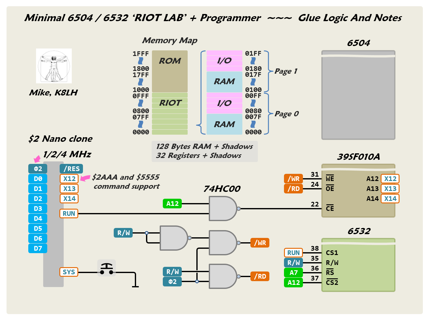

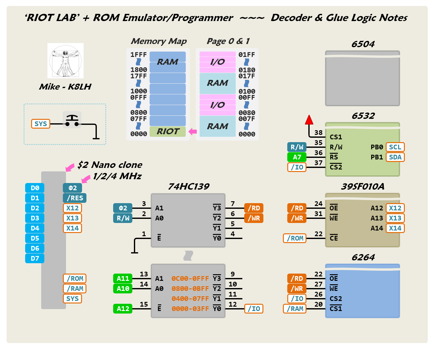

I love your videos... excellent production quality. Well thought out and organized. OTOH, watching you swapping out the Flash ROM over and over again, breaking pins, etc., is cringe worthy.
I wonder if it would it be worth the effort to include in-circuit programming capability via a USB serial connection for iterative code development and testing on a project like this? I couldn't resist fleshing out a couple ideas (below)...
Please keep up the good work.

It wouldn't be impossible to make a flash ROM in circuit programmable, with the only change being a bodge wire to R/W I believe - basically a programming cycle would just load the bootloader to RAM and wipe the ROM. I don't see why that wouldn't work. Just via 9600 baud serial.
However, that would make it a strict requirement to use a modern ROM and that goes a little bit against the idea... OTOH used SST39SF010's seem to be flooding the market anyway so that's a clear plus.
