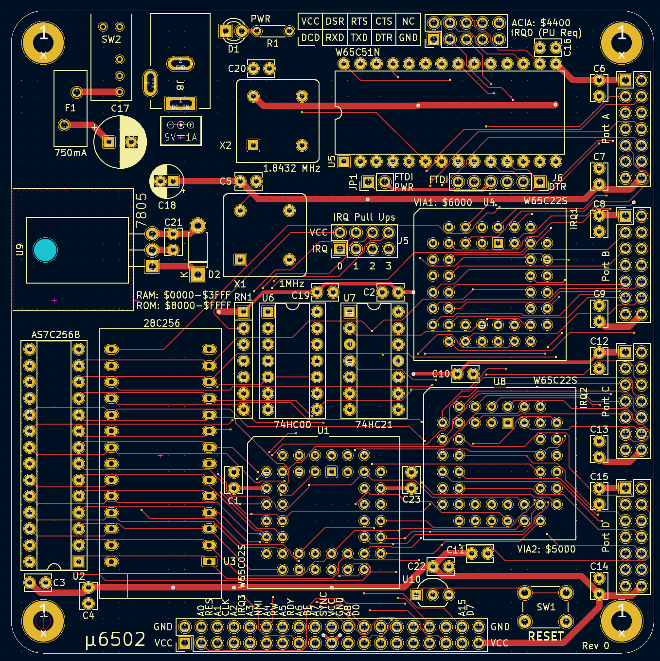

As with many others, I got started playing with the 6502 after watching Ben Eater's series of videos. I quickly became frustrated with all of the wires and flakiness of a breadboard and decided to design a simple PCB to continue exploring the 6502. During research for my PCB design project, I quickly found my way to Mr. Wilson's excellent site and tried to follow many of his suggestions and guidelines. The result is what I call the u6502. My overall goal was to make something simple enough that I could understand it but capable enough to be a useful long-term learning platform. With that in mind, I started with Mr. Wilson's example schematic and added a second VIA and an ACIA along with some simple additional support circuitry.
My initial schematic revision:
File comment: Rev0 schematic
I used a 100mm^2 4-layer PCB design with a signal, ground, ground, signal stack up to keep production costs low.

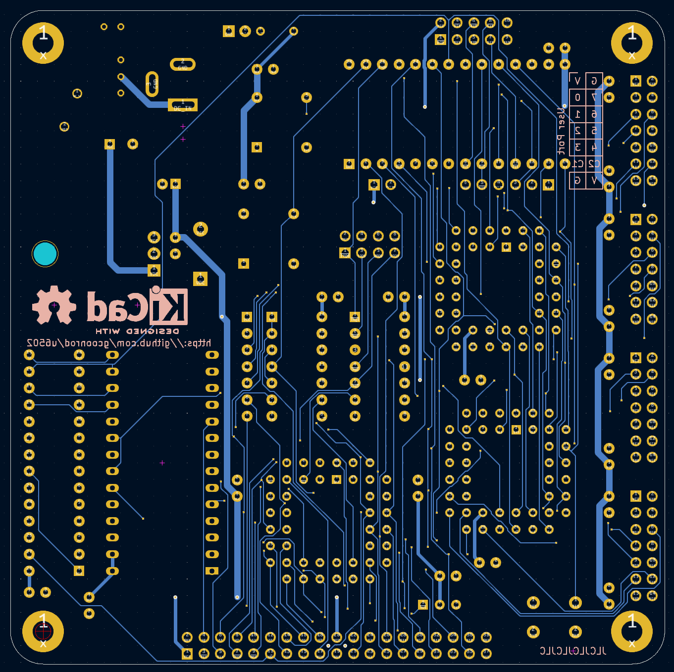

PCB Back:
File comment: PCB back

My initial testing seems to show that the VIAs are working as expected and I am able to drive a common 16-character LCD with only minor issues. However, I have been completely unsuccessful in my attempts at interacting with the ACIA. I have not been able to get any serial data into or out of the RX/TX pins on the ACIA. I have tried the following troubleshooting steps:
  • Validate CS logic with a logic analyzer. I think the chip is being correctly addressed, however, I only have a cheap 8-channel LA and am not 100% certain.
  • Validate clock signals on PHI2 and XTAL1. Both the PHI2 clock and 1.8432MHz baud rate clock seem to be producing clean signals and are connected to the correct pins.
  • Review assembly listing file and compare with known working examples.
    File comment: Test program listing file
    acia-test.txt [13.04 KiB]
    Downloaded 113 times
Here is the snippet from the listing file that covers the ACIA setup and data sending:

Any suggestions or ideas about additional troubleshooting steps would be very greatly appreciated!

Welcome!
Your code looks good (including the loop part when you're waiting after writing the byte - since it's a well-known bug in ACIA which prevents "TX buffer empty" flag from being set properly).
One small note: your comment says "receive IRQ but no" - looks like it's truncated, but I assume you're expecting ACIA to fire an IRQ when data is received? If so, bit 1 of command register should be set to 0 - see https://www.westerndesigncenter.com/wdc ... 65c51n.pdf (page 13)
Also, in case you're not connecting /DSR, /DCD, & /CTS lines anywhere (e. g. if you're probing your UART with a logic analyzer, or using USB-UART converter), you should tie them low, otherwise they will prevent you from sending/receiving the data.
Here's an excerpt from Garth's RS-232 primer on this:
The 6551 ACIA (UART) will not send data if CTS is not true, and it won't receive if DCD is not true. This doesn't mean you absolutely have to use CTS and DCD. If you only want a two- or three-wire interface with no hardware handshaking, then ground these UART inputs so the 6551 will run.
Here's another good article that I used to get my ACIA up & running: http://retro.hansotten.nl/6502-sbc/lee- ... acia-6551/
/Andrew

I see that you're using a PIO delay loop to regulate transmission, which is indeed necessary with the current production ACIAs. However, you should consider whether it's introducing enough delay.
The loop you have will perform 255 loops, consuming 5 cycles per loop, for a total of 1275 cycles. With a 1MHz Phi2 clock, that corresponds to 1.275 milliseconds. At 9600 baud 8N1, you need 10 bit times with each bit occupying 1/9600 sec, so 1/960 sec in total, which is 1.042 milliseconds. So the delay loop should work, and indeed there should be about a 20-25% margin between characters.
I would suggest setting up your SBC to continuously print characters (eg. ASCII 42 is '*') and use your scope or analyser to see whether the Tx output line shows a pattern consistent with the above.
One obvious cause of not getting such output would be if the /CTS line (which may be floating in your design) is going high (inactive). The /CTS line is not even connected to your FTDI header. The ACIA will interpret that as a demand to stop transmitting! At the very least, add a weak pull-down resistor so that if it isn't actively driven, it will default to active-low.
There's another important point, which is that a normal RS-232 port (such as on the back of a PC) uses very different voltage levels than the ACIA. NEVER directly connect the ACIA to a serial port - it will be damaged. Use a level-shifter device, such as the MAX232, to do the necessary voltage translation. Some of FTDI's devices use "normal" TTL voltages, and these won't cause any damage - but MAKE SURE that it specifies "TTL-232" and not "RS-232 levels", since they also make a lot of devices with the latter.
As for your address decoding, I do notice one or two problems here. You've avoided the pitfall of qualifying the ACIA's CS lines with Phi2 (though really the RAM chip doesn't need this either), but the RAM chip is decoded to be active across all addresses below $8000 - and only the /OE line tied to A14 prevents it from conflicting the data bus when reading your devices. This does not, however, prevent writes to your devices from causing aliasing writes to RAM at $040x, $100x and $200x respectively. The rule of thumb is that you should have mutually exclusive chip-selects for address decoding (the 74HC138 and 74HC139 are particularly useful for this) that are not Phi2-qualified, and that /WE and /OE for asynchronous devices (your RAM and ROM) should be generated as simple combinations of R/W and Phi2.

but the RAM chip is decoded to be active across all addresses below $8000 - and only the /OE line tied to A14 prevents it from conflicting the data bus when reading your devices.  This does not, however, prevent writes to your devices from causing aliasing writes to RAM at $040x, $100x and $200x respectively.  The rule of thumb is that you should have mutually exclusive chip-selects for address decoding (the 74HC138 and 74HC139 are particularly useful for this), and that /WE and /OE for asynchronous devices (your RAM and ROM) should be generated as simple combinations of R/W and Phi2.
I missed this the first time around; but although it's labeled "16k RAM" (which is rare, as they go 2K, 8K, 32K, 128K, 512K), he's actually using a 32K RAM and A14 is indeed connected to an address input (not just the OE\ input), avoiding the problem you mention.  So like I've done, he's only using half the RAM, while the other half sits there harmlessly.
Andrew, is this also the case for the W65C51N? I should have been more specific in my description. I am using all current production CMOS ICs from WDC. Either way, I will run my test program again after grounding those lines.
Chromatix, Mr. Wilson is correct in that I am only using 16k of the 32k RAM as in his example SBC schematic. I followed the address decoding example in the 6502 Primer so any errors in implementation here would be from my own ignorance/inexperience. But if I understand it correctly then I shouldn't have to worry about any bus contention between my RAM and IO.
It's not clear whether the W65c51N has an internal pull-up on the /CTS line etc. An old NMOS device would have one, which would hold the line in the inactive state if left open. A CMOS device may or may not not have it, and if left floating it could drift to either state and/or react to high-frequency noise. So whatever type of device you have, you MUST pull /CTS low for the transmitter to be enabled.
It's also unclear whether the W65c51N reacts in the same way as older devices to the /DCD line. Older versions of the ACIA may discard a character being received when /DCD goes high, on the grounds that it is likely corrupted, and won't enable the receiver unless it's pulled low. To be on the safe side, tie it down with a weak resistor, and do the same for /DSR just so that it doesn't float around randomly (it doesn't affect the receiver or transmitter functions).
/DTR and /RTS are outputs driven by the ACIA, so you wouldn't tie those either way. Just be aware that the ACIA drives /RTS according to an obsolete "peripheral mode" protocol, not the modern "peer to peer" protocol, ie. it won't tell the remote end to stop transmitting if the receive buffer is full.

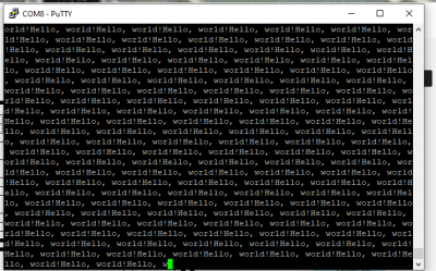

Pulldowns on the right signals and a MAX232 transceiver did the trick!
File comment: It works!
Thanks again, everyone!
