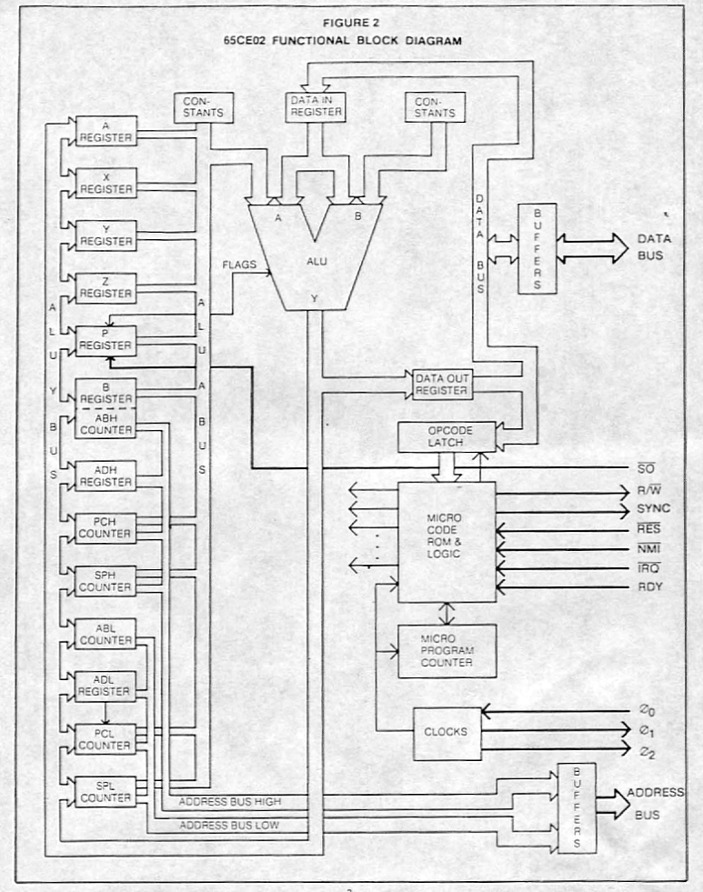

Ruud wrote:
So INX should be 1 cycle, and INX16 would be 2.
Ehhhh, no and maybe yes. If you use the ALU to increment X, the internal data bus is needed twice.
Maybe a single bus is a good foundation for your design, but I wasn't thinking of that constraint. (In a TTL design of course it costs more to add busses than in FPGA.) Looking at the 65ce02 datasheet (pdf) we see
A unique design feature allows [Address registers] ADL and ADH to store indirect address vectors while [Address Counters] ABL and ABH function as counters, thus relieving the ALU from internal address fetches and increasing throughput
and we also see some additional busses in the block diagram (see below)
The same datasheet shows the reduced cycle counts, including many single-cycle instructions (and no page-crossing penalties). Garth has previously mentioned patents covering the elimination of dead cycles, but I haven't yet discovered the patent numbers.

...Garth has previously mentioned patents covering the elimination of dead cycles, but I haven't yet discovered the patent numbers.
Broken external image link
http://img716.imageshack.us/img716/3018/65ce02blockdiagram.jpg
I heard of the 65CE02 mentioned here on the forums, but I didn't realize how powerful it was compared to the original before I read through the manual last night. Why didn't WDC use this design as it's foundation? or did WDC's version come before this iteration? Is the 65CE02 still being sold?
 Post subject:
PostPosted: Mon Mar 08, 2010 7:31 pm
Posts: 10980
As I understand it, the 65CE02 came later than the 65816, and arguably borrowed some ideas from it. The 'CE02 is by Commodore, not by WDC, and I think it didn't happen in any quantity because of marketing or management misses.
