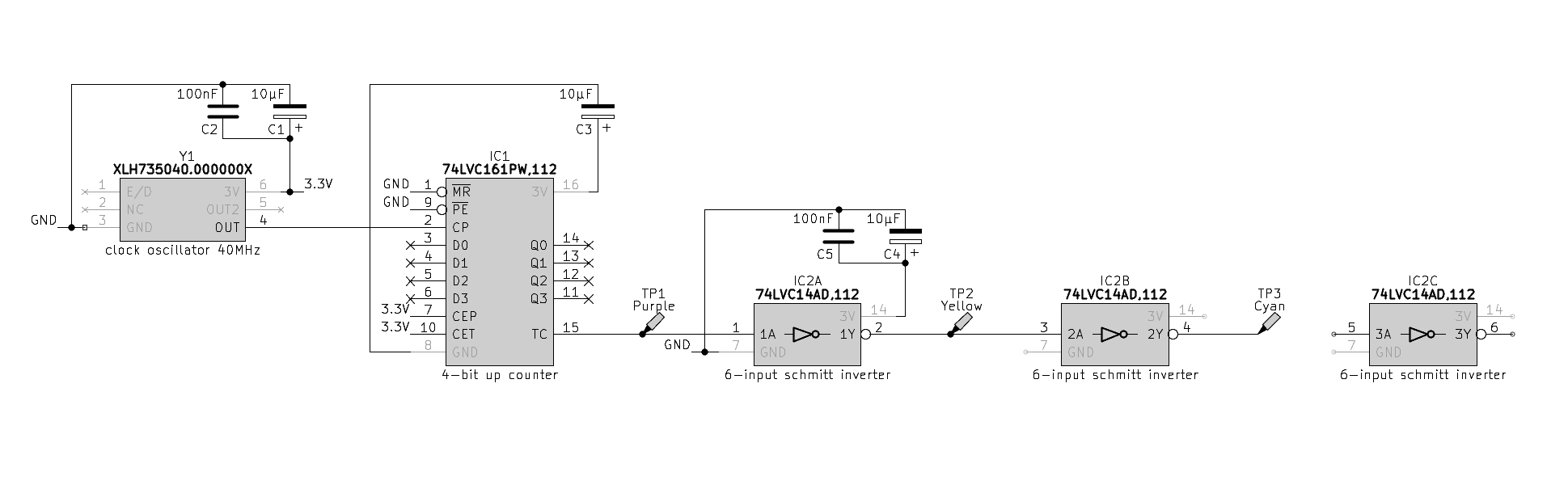

This is something I've been meaning to test for sometime; and that is how can I delay a signal by a small time, on the order of 3ns to 12ns.
It's not something I really want to do as I'd far rather have my signals gated by some well known and very consistent clock but venturing into the world of SVGA has shown me there are going to be times it's simpler just to delay a signal slightly.

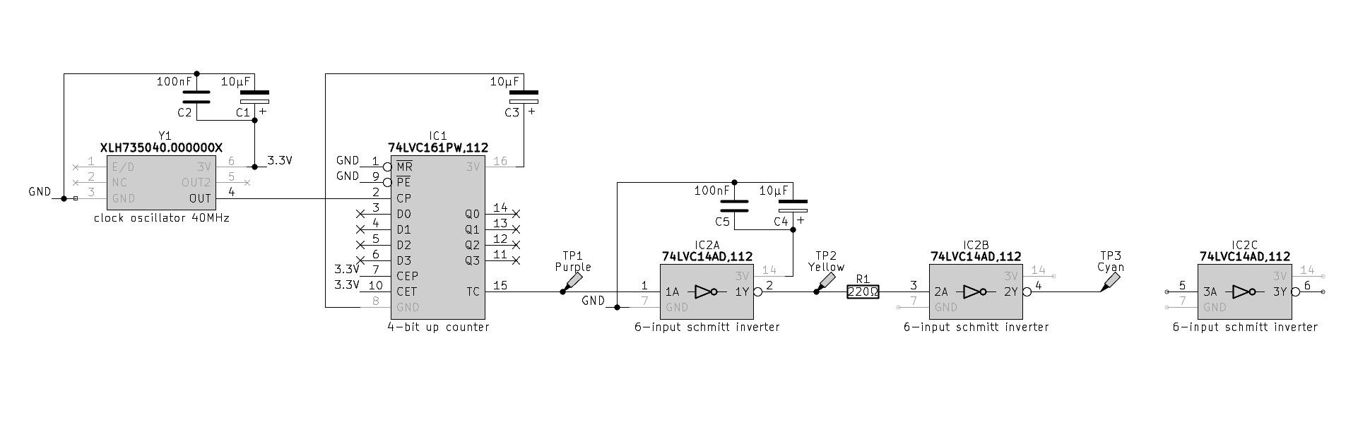

My setup is a 40Mhz clock running into a 74LVC161 counter from there I use the terminal count (TC) pin to generate a nicely spaced signal that I can trigger my scope on. I also use TC as the signal input into a 74LVC14 Schmitt inverter. Everything is running on a breadboard.
With no further ado this is what I found:

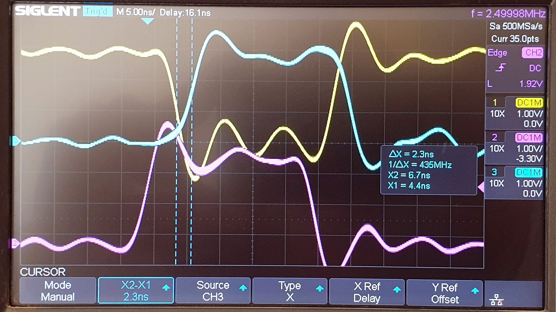

• A direct connection from the output of inverter one to the input of inverter two gave a 2.3ns delay measured between the input and output of inverter two.

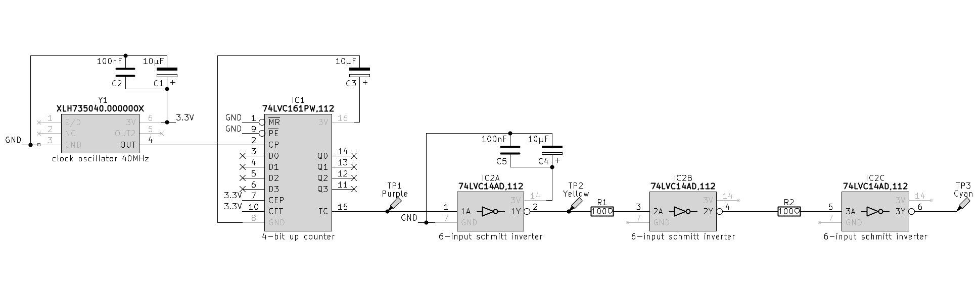

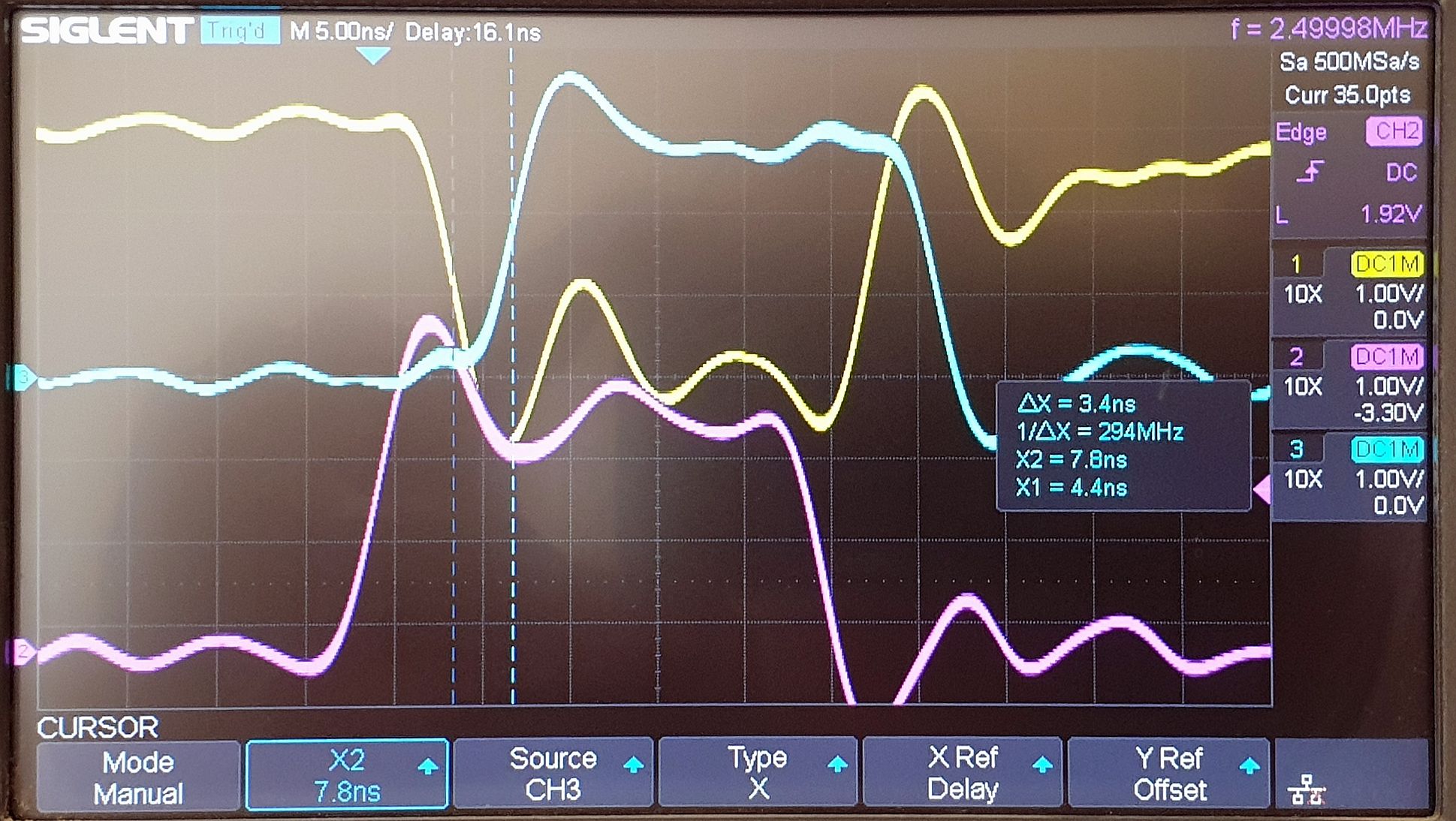

• A 100Ω resistor connected from the output of inverter one to the input of inverter two gave a 3.4ns delay measured between the output of inverter one and output of inverter two.

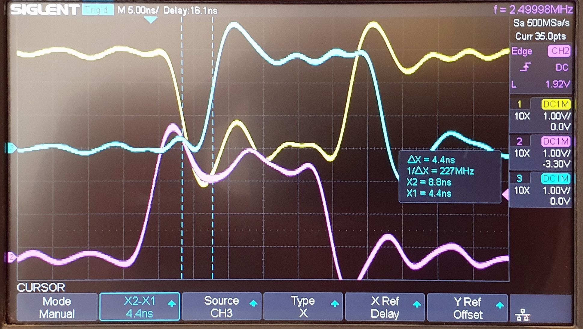

• A 220Ω resistor connected from the output of inverter one to the input of inverter two gave a 4.4ns delay measured between the output of inverter one and output of inverter two.

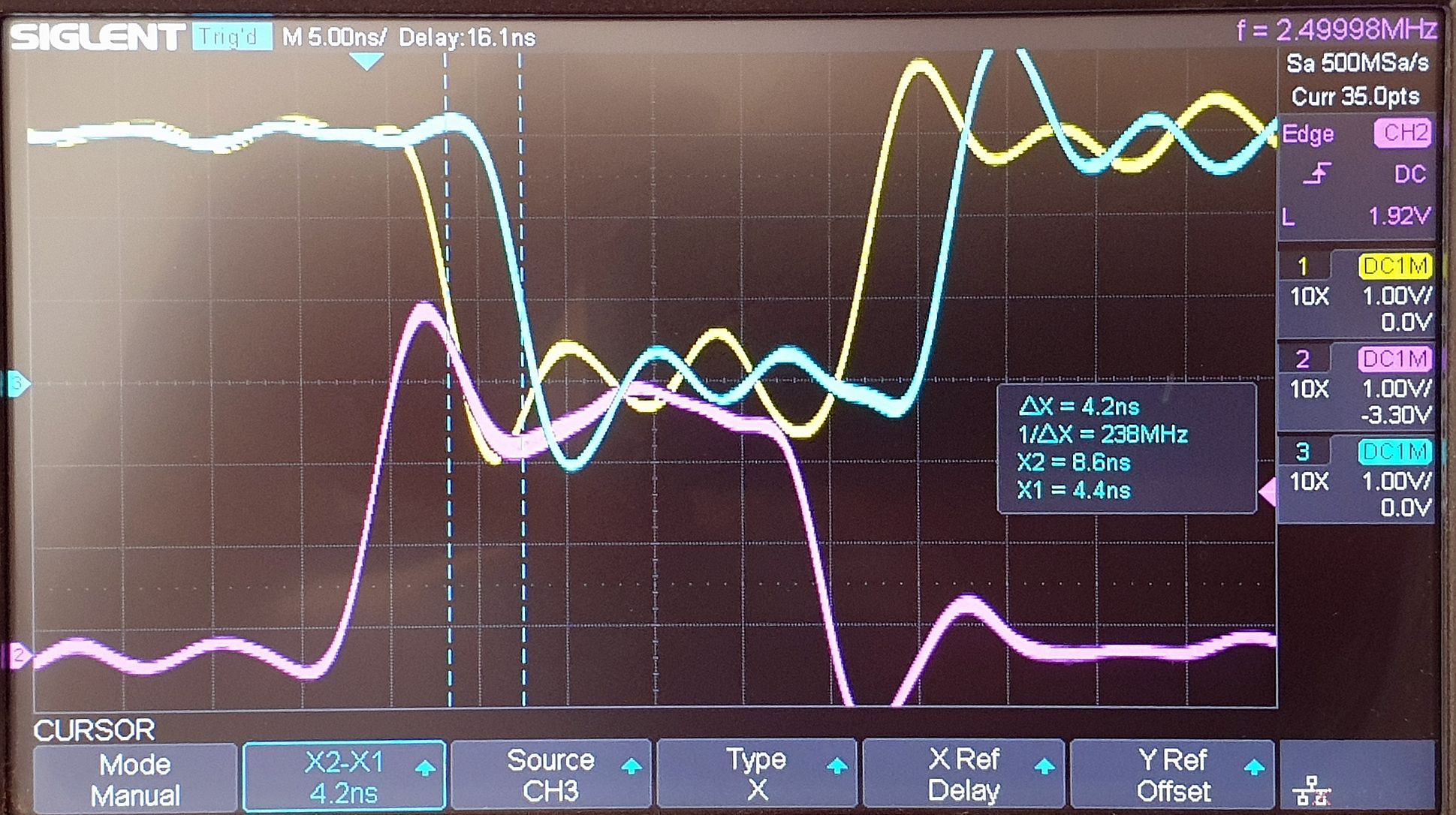

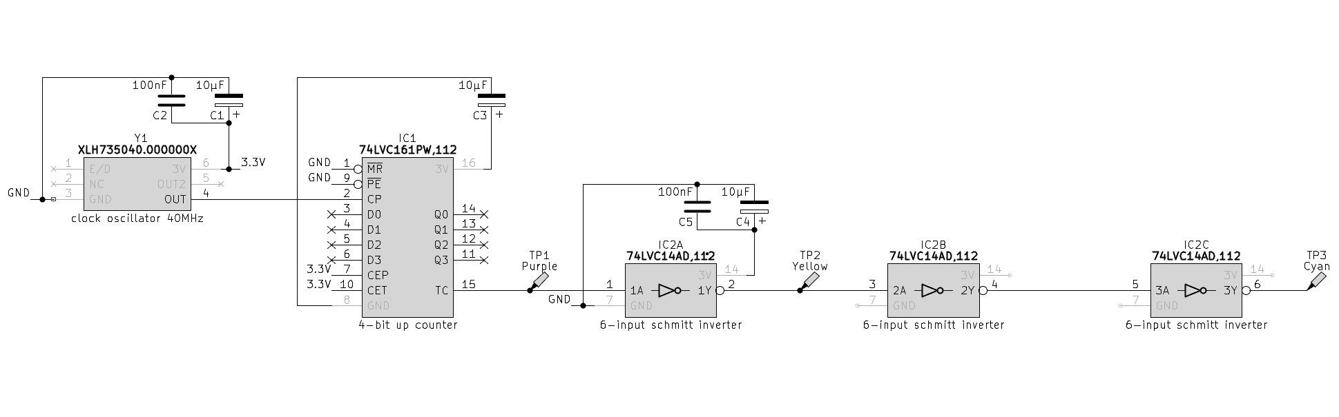

• A direct connection from the output of inverter one to the input of inverter two followed by a direct connection from the output of inverter two to the input of inverter three gave a 4.2ns delay measured between the output of inverter one and output of inverter three.

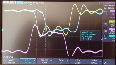

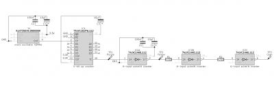

• A 100Ω resistor connected from the output of inverter one to the input of inverter two followed by a 100Ω resistor connected from the output of inverter two to the input of inverter three gave a 6.1ns delay measured between the output of inverter one and output of inverter three.

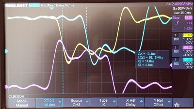

• A 470Ω resistor connected from the output of inverter one to the input of inverter two followed by a 470Ω resistor connected from the output of inverter two to the input of inverter three gave a 10.4ns delay measured between the output of inverter one and output of inverter three.

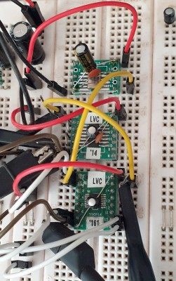

Was this particularly rigorous? No
Is this meaningful? Kinda. Measured delays should be viewed with a dose of skepticism as I'm using breadboard and it is quite easy to change a delay by about 1/2 a nanosecond by poking my finger into various wires. I'm also running at a perfect room temperature of 25°C.
Is this useful? Kinda. Even though there will be variances between timings from a breadboard and timings on a PCB I think the general times are not going to get significantly smaller. I noticed that soldering the inverter inputs to the outputs together (for direct connection measurements) on the adapter board had barely any effect at all. I suspect the oscilloscope probe positions (i.e. plugged into a breadboard) and the length of the probe connections have more effect. I also should point out that the inverter outputs are only driving another single inverter input. I will probably need to add a line driver if I'm going to use one of those outputs from several other inputs.
With all that said the gate delay timing I saw falls nicely in between the datasheet's given minimum value of 1ns and typical value of 3.2ns.
And lastly what did the real physical mess actually look like?
