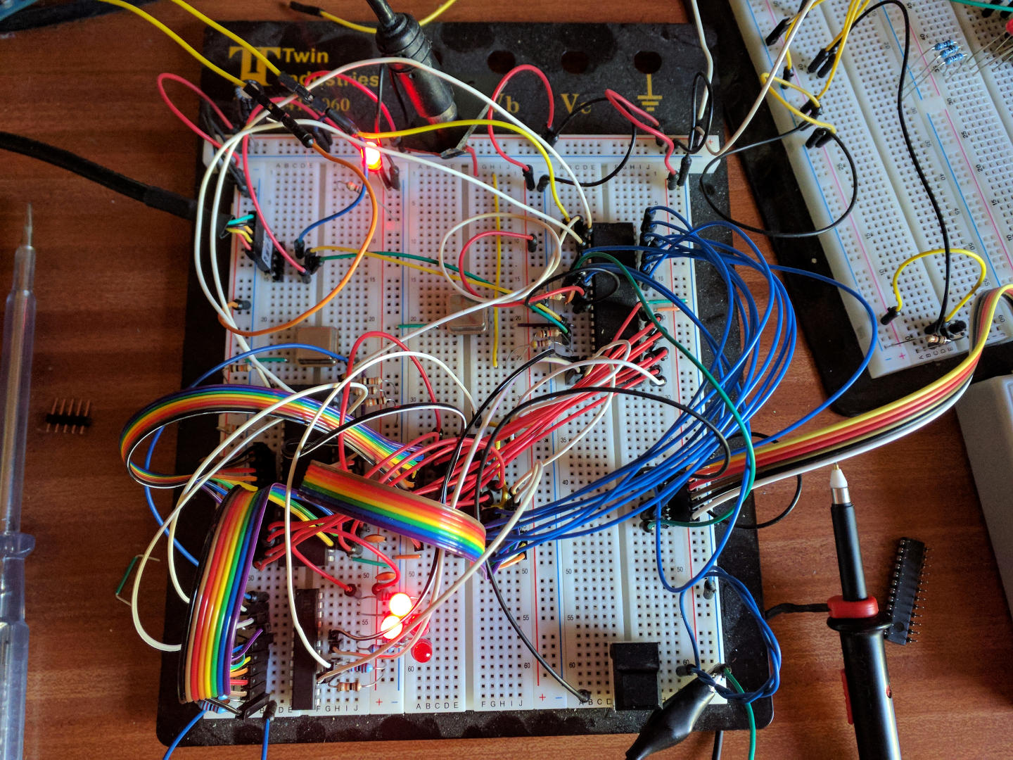

I'm still waiting for a few more parts (namely ZIF sockets and oscillators) but I have chips on the board and wires going between them. I'll probably add another breadboard for the power supply and clock, but I'm waiting for parts to arrive so I can move my flash programmer (just barely visible in the top of the frame) to some stripboard, which will free up a breadboard.
The power/ground network seems good but I don't have any experience with this so I could be doing it wrong (power and ground are red and black wires respectively, but blue where they're being used to pull a pin in a particular direction). The address bus is yellow, control lines (both those to/from chips and intermediate logic lines) are blue, and the data bus will be green when I start wiring it up.
The flash chip will be in a ZIF socket in the "final" build, but as I mentioned earlier that hasn't arrived yet.
If you have any questions or pointers please let me know.

Looks like you're off to a good start!
I would suggest doing *all* the power connections before doing any of the bus wiring. Especially with the "flying wires" method, all the aerial wires will make it cumbersome to aim your smaller jumper wires later on.
ZIF sockets don't typically play well with breadboards, but (depending on what type of socket it is) you might be able to mount it in a machine pin socket as a kind of "socket carrier." This works really well with the nice (but expensive!) Aries sockets, but less well with the more common 3M type ones (those big blue/green ones).

The wiring starts to get hairy after a while - so quietly forget the 6522 - unless it's a vital part of your bootstrap...
My Ruby system on day 1:
I bought some "jumper jerky" from Pimoroni (I think) for some of the bus connections, but it actually proved to be harder to use and one end or the other of an 8-bit bus would pop-out, but that board did work and it produced video too (although that was done by the ATmega separate to the 65C02).
Hard to see what's there but top-right is the ATmega with 16Mhz can oscillator, middle is 32KB of RAM (reflected over both 32KB regions) Left is the 65C02 and the GAL under it. (doing the write qualify and other stuff to handle 2 x 32KB RAM chips)
On day 2, I moved to stripboard which made it far more robust and worked solidly up to 16Mhz. I mounted 2 x 32KB RAM chips one on-top of the other but brought out the /CS pin on the top one to a separate output on the GAL. Output was a simple 8-bit latch and single bit input - I didn't use the 65C22 until the PCB version.
I was in-circuit programming the ATmega (which holds the 6502 boot code) so didn't bother with ZIF sockets, but I think I might not bother with one for a breadboard - put in some link pins to make it trivial to locate it when you put it back in again... I experimented with a few different schemes for the GAL which is why it's at the bottom of the board to make it easy out/in.

The issue there is I don't have any 74HC14s. My spares bin consists of some 74HC00s and some 555s (which might work but I'd rather just wait for the can to arrive).
I got the rest of them in fine. Good eyes and young fingers probably help :)
I got 2 of the Aries ones, and the datasheet says the pins are 2.67mm. I checked with some 22AWG wire with ~3mm of conductor exposed, and that stayed in the breadboard well enough to pick it up, so hopefully it works nicely.

Great start! I'd say the power and ground is enough. For my recent breadboard prototype I didn't wire the power in a grid, only the ground, and I did that by connecting from IC's ground pins to the opposite rail, rather than having separate wires. The rationale was that the ground pins of the ICs are speecifically what I want electrons to be able to get to/from easily for ground returns with minimal trips through connection points.
Rather than using ZIF sockets, I make little straps out of paper and selotape and put one around each ROM IC, so that I can more easily pull them out:
File comment: Home-made chip puller
My wife is very good at sewing, and I originally asked her to make these things for me out of ribbon, but she laughed and told me to just use paper instead, so here we are!
It sounds silly but I find this method works very well, and I've never damaged an EEPROM pin despite what must be hundreds or thousands of removals and insertions. It should be fairly obvious how to make it, but I made a how-to video here: https://youtu.be/TGueNvmNNCM
