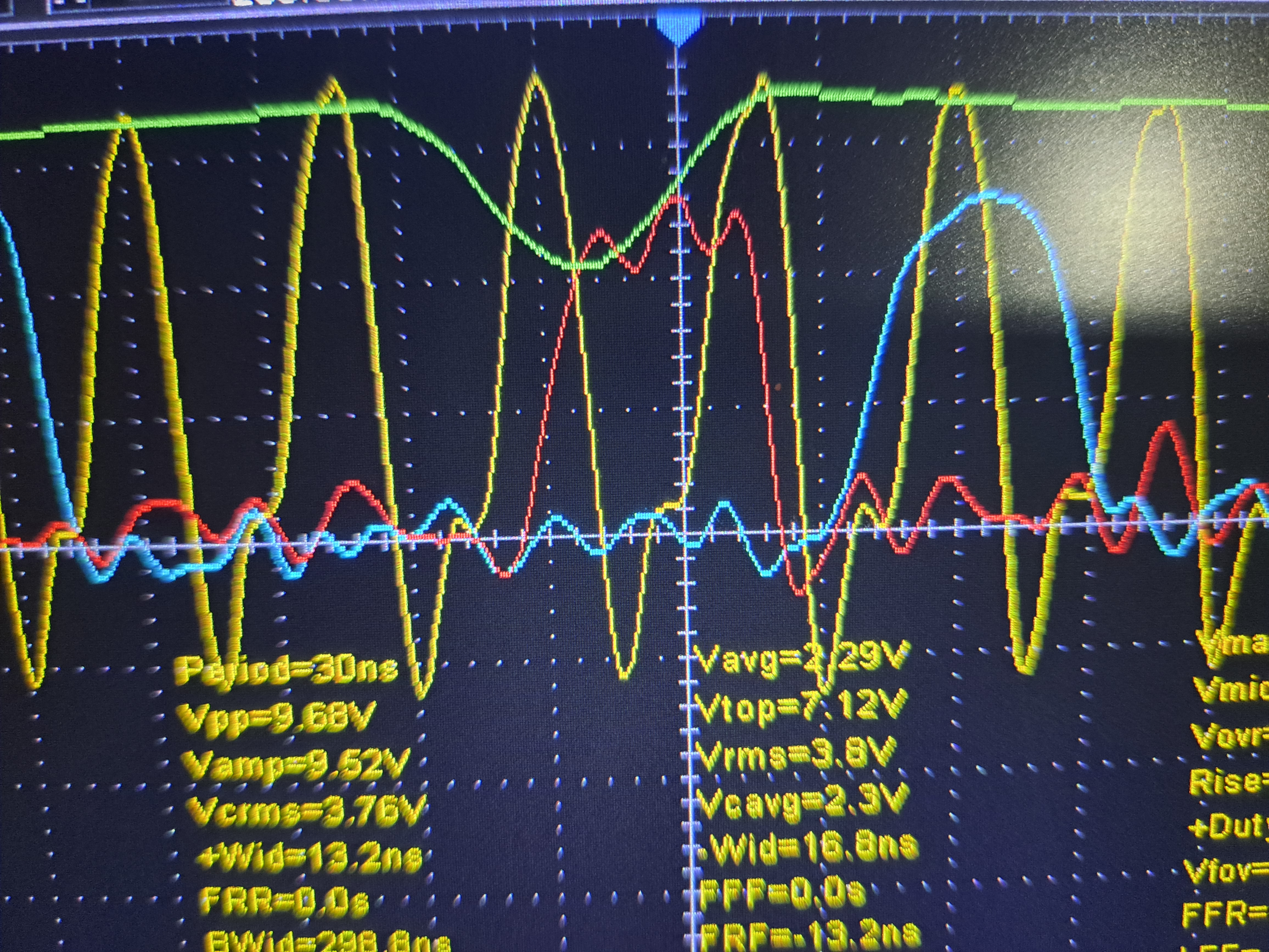

That's interesting - I guess it wouldn't affect the base frequency, so you'd want to start from a frequency that doesn't quite run stably, then try this to increase stability.
I've actually just been trying something a bit similar - feeding the output of a 74AHCT74 through a chain of inverters, and tapping its set and reset signal from different points along the chain to form an oscillator. With 74HCT14 as the inverter, the fastest stable frequency I got was by putting two inverters in a row after each of the 74AHCT74's outputs (inverted and non-inverted) and feeding that back into the appropriate set/reset signals - this frequency was about 24MHz. Choosing asymmetric taps changes the duty cycle.
I replaced the inverter with 74AHCT04, and the frequency increased to 56MHz. The propagation delay is small enough that it feels like it could be used to fine tune the duty cycle much better than with the HCT inverter.
I also thought that, given a two-phase clock, you can drive a flipflop's set and reset inputs to copy the clock (with a slight delay), and if you then used inverters to delay the set or reset signals, that could also allow adjustment of the duty cycle. I guess there are a lot of options!
Edit: Now I seem to have made a 33MHz clock with 35% positive duty cycle, and the computer is working quite well with that. So it looks like skewing the duty cycle towards phase 1 is needed. I still don't really have enough control to tune the duty cycle and propery experiment with it.
Edit 2: here's a scope of PHI2 and A0, it is barely ready by the time the clock rises. It is being measured about 4cm from the IC pin, at the RAM. On a PCB this may be better.
File comment: PHI2 (yellow) and A0 (blue)

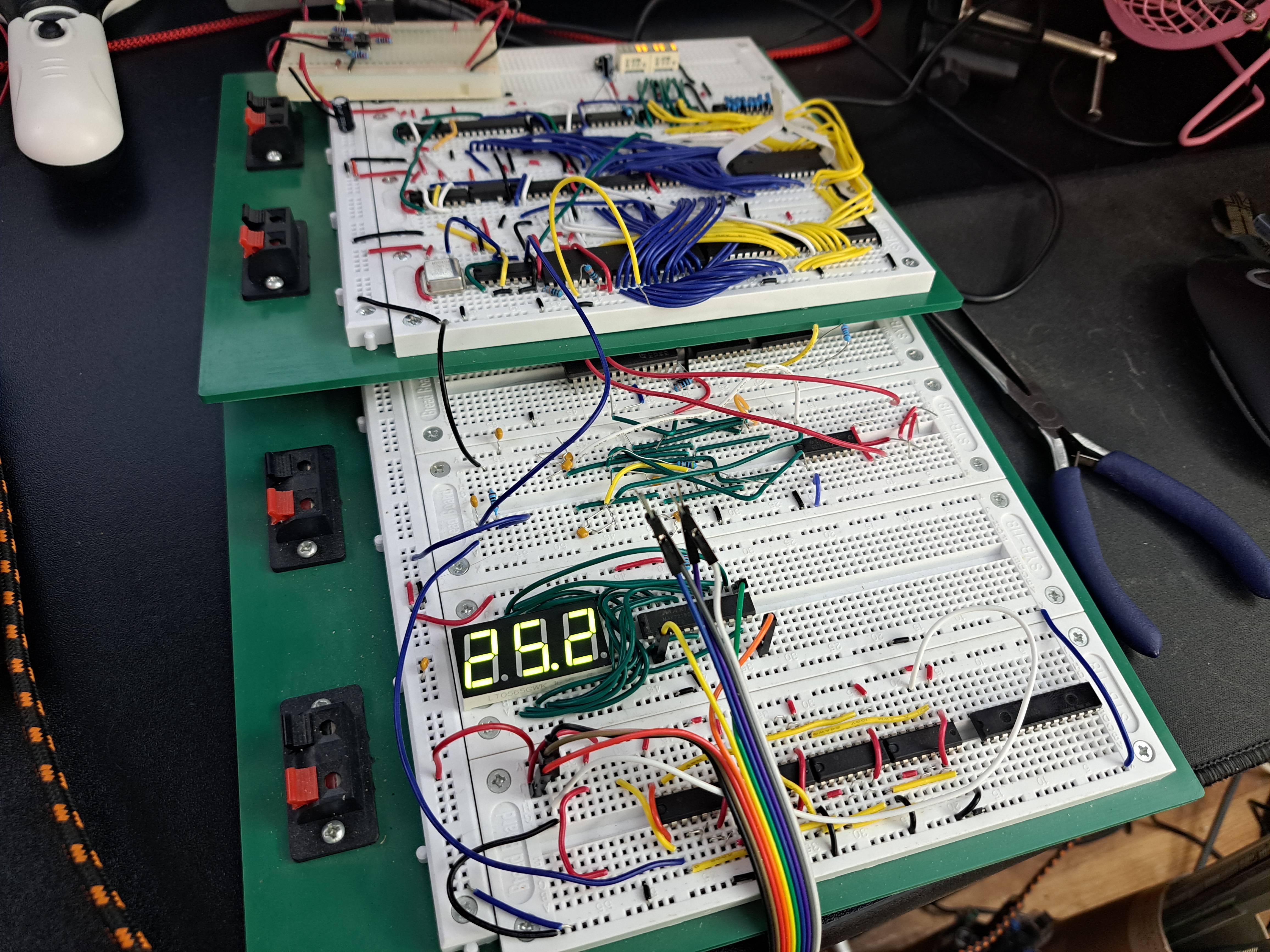

Yesterday evening I expanded the prototype's address bus to the full 16 bits, so that it can run more proper 6502 programs now. I'll develop some tests, maybe port the Dorman suite but it seems not quite what I need here. The RAM read/write stress test I already wrote ran fine overnight, for over 12 hours, at 25.175MHz.
Wiring wide buses is the one thing I really dislike doing on breadboards.
I started making the fast bus capture circuit to help with debugging, and got sidetracked by feature creep, wanting to add a frequency meter to it - this is where it got to so far:
File comment: Frequency meter / data bus capture device
There are four 74ACT163 counters, a RAM chip that's not wired up yet, and an LED display driver (MAX7219). The ATMega328 (in an Arduino Nano at the moment) polls bit 15 if the counters as part of its work managing the bus capture process, and just counts the rate that is changing, as for every falling edge 65536 CPU cycles have passed. So it can calculate the effective CPU frequency, which in this case depends how much ROM or I/O it is doing. It's interesting to see, for any particular 6502 program, what the effective clock rate is.
It should only need a few more glue ICs and some better Arduino code, then it will be able to record the bus data.
