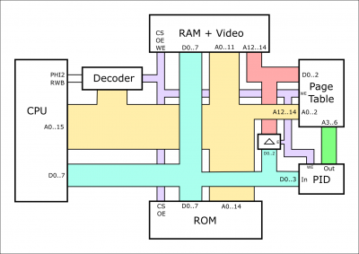

I can't remember whether I already posted this, I thought I had but can't see it, so sorry if it's repeating, but in my experiment with this sort of thing I put some normal static RAM between the PID register and the high address lines of my main memory so that each process had its own page table. Processes used a system call to request pages to be mapped, and the supervisor (PID=0) can map any pages it likes for itself including those already used by other PIDs, so it can read memory of other processes if necessary.
In the prototype I only used 32K of main memory, so not many address lines were used, but it would scale up well to larger RAM modules - or the high bits in the page table could reflect executability and other protection states. At some point you might want 16 data bits in the page table. I probably copied most of these ideas from Andre's system.

@gfoot how do you set the pagetable values? Wouldn't it require some registers visible to the CPU? That seems to be missing or I haven't understood how it works
For the supervisor process I think it was memory-mapped, with user processes using a syscall to request maps be set up for them.
On the hardware side I think ideally you'd use some transceivers or multiplexers to control the buses to the pagetable RAM, but I didn't get that far, this prototype was very hacky and I seem to remember I cut a lot of corners on that bit. It's no harder than the way video RAM is shared between the CPU and GPU though - you just need to make the address decoding swap things around when you're writing to the pagetable.

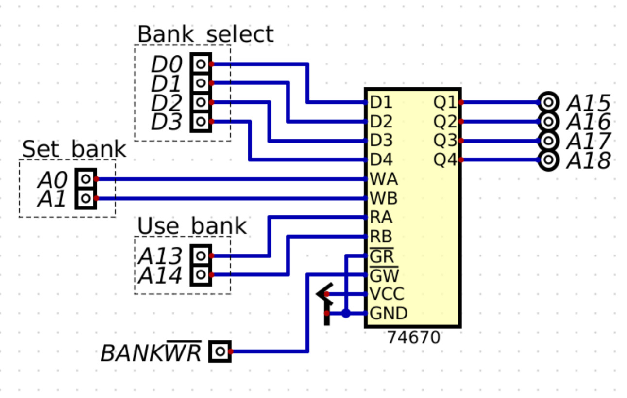

Thank you for your responses!
Andre, Michael - '610 seems to be the perfect solution. And I don't even need a '157 in front of it - it's already a simple self-sufficient MMU.
This gives me 16x 32 KB banks with my AS6C4008 RAM, each divided into 4x 8KB sub-banks that can be mapped individually.
With BANK/WR asserted by access to $D000-$DFFF, I can configure 4x 8 KB banks by writing to one of four registers:
- $D000 - select bank for CPU address range $0000-$1FFF (region 1)
- $D001 - same for $2000-$3FFF (region 2)
- $D002 - same for $4000-$5FFF (region 3)
- $D003 - same for $6000-$7FFF (region 4)
To read those registers, some more glue logic is required, but this is already a good start, since my kernel will be able to efficiently copy data between banks.
However I'll probably use region 4 to keep track of active bank mappings as well as kernel's own stuff and shared memory.
The only downside is whenever I'm context-switching between processes, 3 writes are needed to swap first 3 regions from one process memory to another.

I tried to go below 3 chips for full read-write ability for banking registers, but this is best I could do.
'157 selects A0-A1 when bank index register is accessed (to read/write bank index for each of 4x 8KB regions), and A13-A14 when bank is accessed.
'670 stores 4-bit bank index for each of 8KB registers.
'244 puts bank index on data line when bank index register is read.
/Andrew
