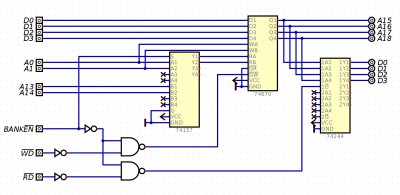

fachat wrote:
Good you found the '273 because of its reset capability.
Is /banken qualified with phi2? Otherwise it stays valid for too long, and the CPU has taken the data off the bus already
IIRC the 273 latches the data in at rising edge of CP. So you should make sure CP is only low when phi2 is high.
Yep, it is: I have used /RD & /WD signals (qualified with Ф2) as inputs in my latest design, since I already have them in my SBC. I also happened to have just enough spare '14 gates for this task:

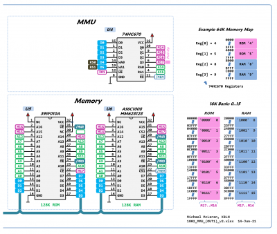

and3rson wrote:
Yeah, it seems like it would be nice to have an ability to map different regions of multiple banks at once, especially when there's a need to copy data between processes, or work with kernel & user-space data simultaneously.
I was looking at the 74HC670 4-bit Register File IC some years back for the ability to map different segments into 64K address space. I had seen the '670 used in projects by the RC2014 Z80 crowd. Could something like that be useful in your project? *drawing below was for an '1802 project which uses separate address space for I/O...
Good luck on your project.

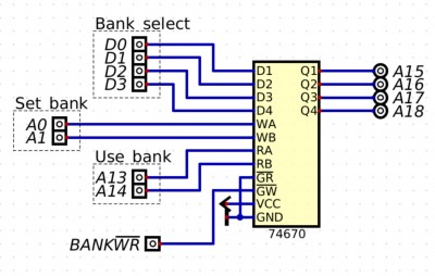

PostPosted: Fri Aug 18, 2023 9:42 pm
Posts: 163
Location: Lviv, Ukraine
Thank you for your responses!
Andre, Michael - '610 seems to be the perfect solution. And I don't even need a '157 in front of it - it's already a simple self-sufficient MMU.
This gives me 16x 32 KB banks with my AS6C4008 RAM, each divided into 4x 8KB sub-banks that can be mapped individually.
With BANK/WR asserted by access to $D000-$DFFF, I can configure 4x 8 KB banks by writing to one of four registers:
- $D000 - select bank for CPU address range $0000-$1FFF (region 1)
- $D001 - same for $2000-$3FFF (region 2)
- $D002 - same for $4000-$5FFF (region 3)
- $D003 - same for $6000-$7FFF (region 4)
To read those registers, some more glue logic is required, but this is already a good start, since my kernel will be able to efficiently copy data between banks.
However I'll probably use region 4 to keep track of active bank mappings as well as kernel's own stuff and shared memory.
The only downside is whenever I'm context-switching between processes, 3 writes are needed to swap first 3 regions from one process memory to another.

I tried to go below 3 chips for full read-write ability for banking registers, but this is best I could do.
'157 selects A0-A1 when bank index register is accessed (to read/write bank index for each of 4x 8KB regions), and A13-A14 when bank is accessed.
'670 stores 4-bit bank index for each of 8KB registers.
'244 puts bank index on data line when bank index register is read.
/Andrew
