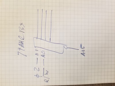

If your goal is to drive the RAM to the edge of reason, and almost every access will be to RAM, what about just forgetting chip select altogether? Tie CS high, and gate R/W\ with A15:
