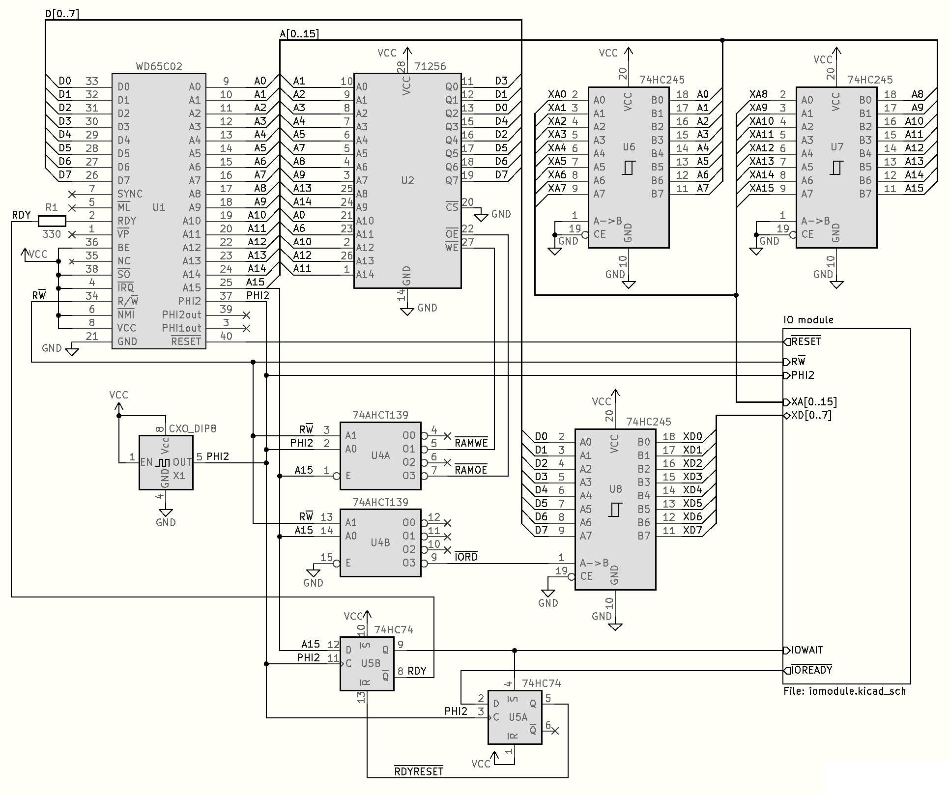

Here's an updated schematic - notes below, and as always feedback is appreciated, thanks for everything so far:
Main changes:
  • I replaced the broken wait state logic with my older plan of a pair of D flipflops, without being specific yet what will drive them
  • I replaced the RAM CS logic with CS always being asserted, and replaced the inverted clock arrangement with a 74AHCT139 that can drive the RAM's WE and OE signals
  • I removed the ROM and put transceivers in instead, so the ROM can just be an I/O module
  • The reset circuit is also in with the I/O now, potentially part of the ROM circuit depending where I go with that
Making the ROM be an I/O module was always the long term plan - the previous circuit with it more integrated was just going to be a proof of concept. However, when it came to PCB layout, the ROM was really annoying to fit in while still keeping the address and data lines short, and the transceivers are much easier to fit in that regard, so I've jumped ahead and put those in. The idea is that the ROM, any VIAs, and other I/O only see the signals on the other side of the transceivers, with at least one wait state. Individual I/O boards could probably define their own wait conditions - supporting VIAs running with a slower clock, for example, by dynamically waiting long enough for them to have a clear setup and slow PHI2 phase and latching the result for the main CPU to pick up after that. I sketched some circuits with latches instead of transceivers, especially for the data bus, and that may also make more sense.
The reset circuit is lumped in with I/O because it is not speed-critical. It's also possible that I'll use the reset circuit from my ARM2 computer, which holds reset low while ROM is preloaded into RAM - and that would require the I/O modules being able to drive the buses, i.e. BE connected to ~RESET and some support for reversing the address transceivers. But I'll probably just do a simpler version first.
The wait states now work by the D flipflop U5B getting set after the rising edge of PHI2 whenever A15 is high, with its inverted output driving RDY. This signals the IO system that it needs to do something, and it eventually responds by lowering ~IOREADY which is sampled at the rising edge of PHI2 by U5A, resetting U5B. U5B then also sets U5A high, and the I/O system is responsible for unasserting ~IOREADY before the next edge of PHI2 (in response to IOWAIT going low) so that we're ready to service another A15-high cycle straight away if necessary.
The I/O module picks these up in a PLD, along with the high XA address lines, and decodes those to drive a ROM's CS signal, six I/O CS signals, and WE and OE signals for the ROM and I/O. I haven't fully designed that bit yet but think there's enough interface here for pretty much anything to work. The through-hole PDIP PLDs I have are a bit slower than 74-series logic for basic things, hence the core circuit shown here not using a PLD.
I may not pass PHI2 to the I/O module at all, instead using a slower I/O clock or requiring individual I/O boards to do their own clocking. e.g. ROM probably doesn't need a clock. Also RWB should probably be buffered, not just connected directly to the I/O module. I could pass ~IORD and an unlabelled-but-present ~IOWR signal to the I/O module, but a proper copy of RWB is more useful for driving VIAs.
The PCB layout is looking pretty good at this stage, the core components fit quite well together with only a couple of points where signals need routing for short distances on the back of the board - it's much simpler than my last PCB project! I'm not sure I can fit them within the 50mmx50mm square of a cheap 4-layer board, so I'm using two layers and have up to 100mmx100mm, which is acres of space for the I/O modules to sit in.
PostPosted: Tue Jul 18, 2023 2:13 am
Posts: 8147
I don’t see a memory map posted anywhere. Kind of hard to decipher a new design without one.
