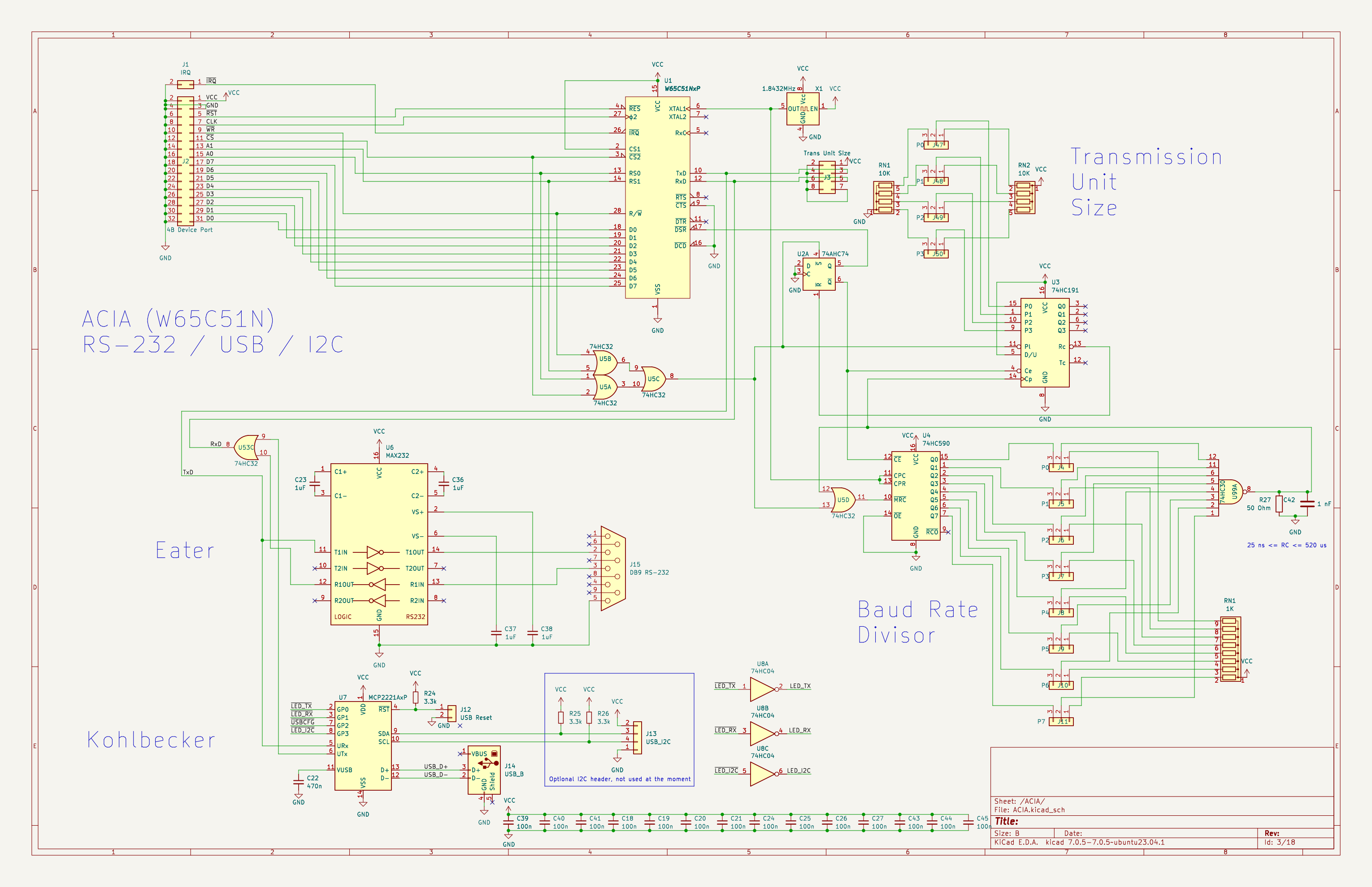

YES, I am already thinking along those lines, I could trap writes to the command and control registers and set the latches up to count any baud divisor, any transmission unit length. And you're right about just adding shift registers and rolling my own UART (excuse me ACIA) but I'm sort of entertained by the idea of festooning the buggy 65C51 with a billion add-on chips until, at the end, I just delete the 65C51 from the schematic and the processor never knows the difference. It'd be the perfect way to put a definitive end to people (like me) bellyaching about how bad the ACIA is! ("You mean, you didn't just replace the entire functionality with a separate circuit?!") :) :)
I don't know if I'll ever be brave enough to order a PCB based on my schematics, but I'm having a blast learning Kicad and creating schematics as part of my learning process as I study the Ben Eater (and Adrien Kohlbecker) videos. At this point I have half a mind to reproduce the Ben Eater 8 bit breadboard computer, but using only 74HC138 3 to 8 decoders (on the back of a napkin, I figured out how you can hotwire one to be a NAND or NOR gate, and since the Apollo Guidance Computer was made exclusively out of NORs, that should be all that anyone ever needs to land on the moon again).

Here's a schematic with both your and Ben's ACIA circuits on it. I put an OR gate so that the ACIA can listen in on both yours and Ben's lines at once, and I fork the transmission line so that the ACIA can blast serial out over DB9 RS-232 and I2C at the same time. It is 2023, not 1983, and desperate times call for desperate measures. We need to act quickly before IBM and Apple come to dominate the PC market.
Thanks for endorsing the 16C550C, I will look into it. I've been going for new through-hole parts, because that's all I know how to solder, but I can see bending the rules to make an effective UART solution. I will also read the Rockwell datasheet you attached. I'm compelled by the idea that the DSR transitions can trigger interrupts on the receive side.
I have a Vector Pull rewrite module in schematic, with an 8to3 priority encoder, so I can have up to 8 different interrupt vectors, including a facility to turn my IRQ7 into an NMI. A programmable interrupt controller with a single memory mapped register allows software control of interrupt priority and CPU destination (for my quad core 65816 scenario).

Done, check it out! I use EEPROMS to replace combinatorial logic based on the line discipline settings, which I intercept with latches when there are writes to the command and control registers.
One thing it doesn't handle correctly is baud rate = 0000, i.e. 1/16 External Clock, but that would be easy to fix.
I just don't see why people complain about the W65C51N, it's a perfectly good UART if you simply add 14 support chips to work around the transmit bug! :lol: :lol: :lol:
