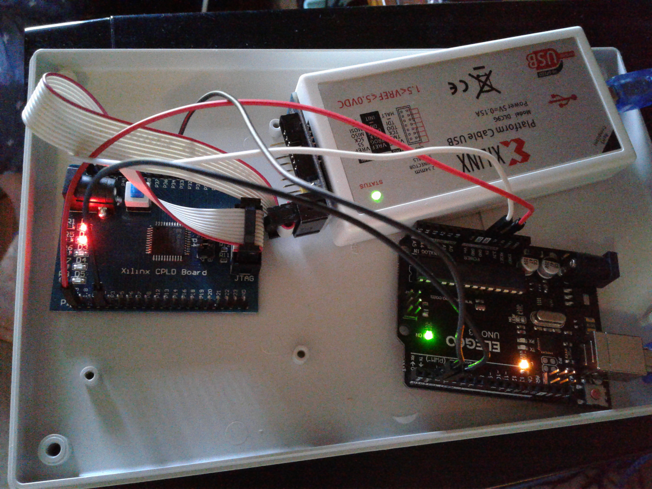

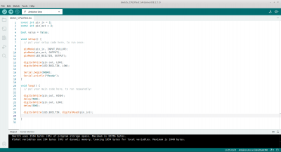

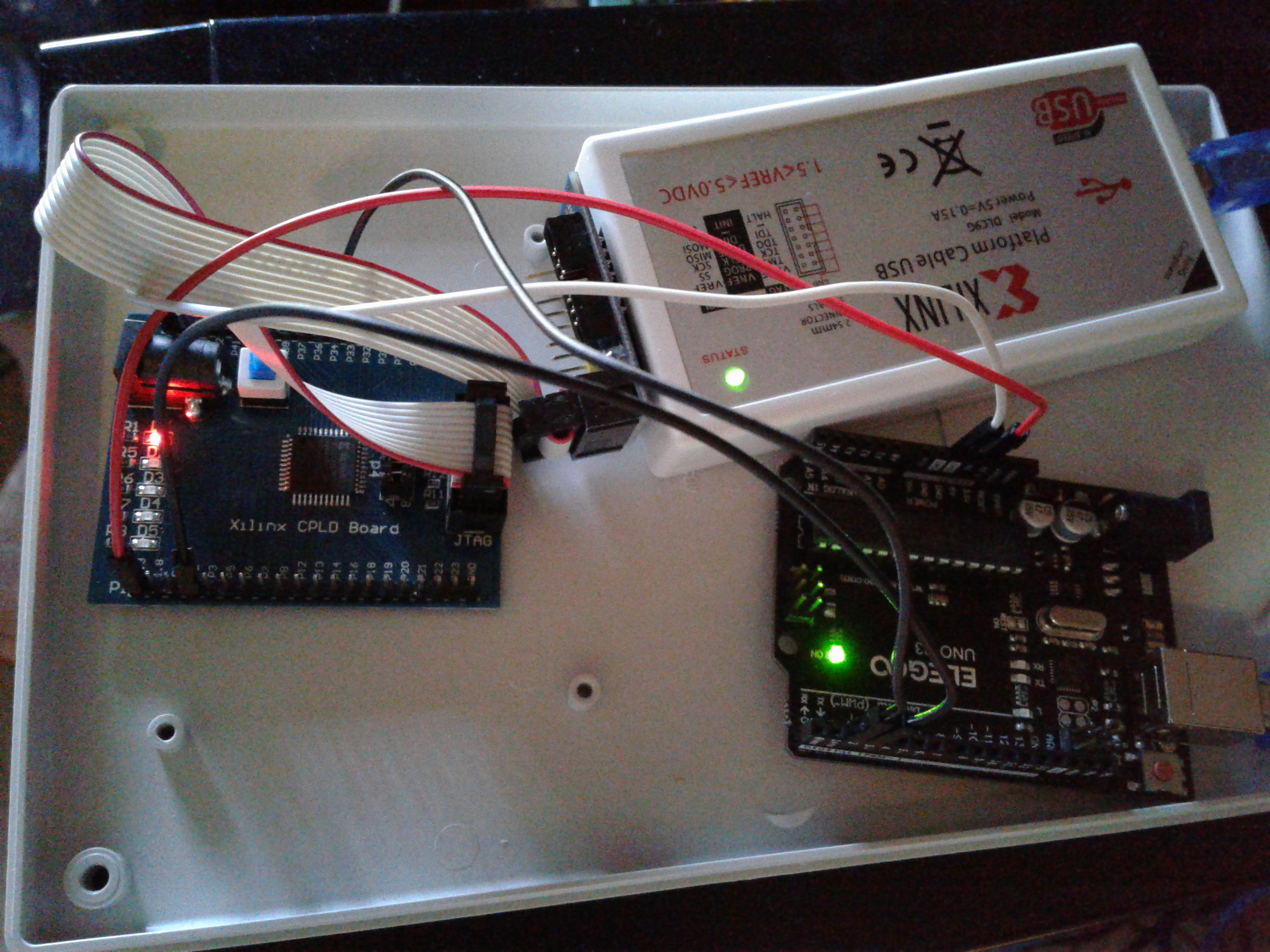

Edit: Adding Pictures, with code. I'm currently testing it with the Arduino, sorry it's not directly 6502 right now. The Arduino is able to send a clock signal to the CPLD. The CPLD then flip-flops the value, blinking it's own light, and then sending the value back to the Arduino. The Arduino then turns it's own light according to what it receives from the CPLD. Conclusion: The CPLD can receive, compute, and send back data!
