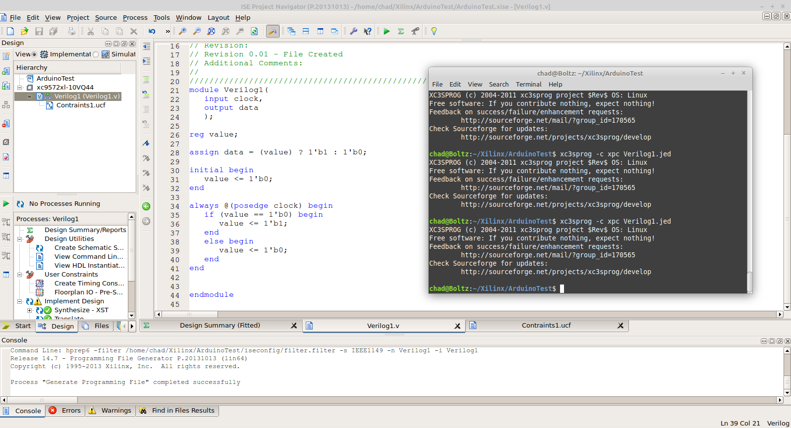

xc3sprog -c xpc MyProgram.jed
In case you are new to CPLD's, the .jed file is what will program the CPLD when sent through the JTAG programmer. You get that file from running the ISE 14.7 software as usual. Instead of using the built in Impact programmer, simply pull up a terminal and command-line your programmer to make it work. You can also use xc3sprog to program "older" FPGA's using .bit files. I believe ISE 14.7 will create those for you as well when you are programming specifically for an FPGA.
Lastly, a bit of advice on the ISE 14.7 software. I started trying to use the 'schematics' side of things, but was quickly disappointed. It is *nothing* like KiCad. So instead I started learning Verilog. It is a C-based programming language that I found to be VERY helpful. I am still fairly new to it all, but I was able to adjust things very quickly. There is also a "Constraints" file you need have to create pin number assignments. Each pin needs a line like:
NET clock LOC = P2 ;
With "clock" coming from the Verilog file, and "P2" being different for different devices. The XC9500 just happen to be fairly easy in that regard.

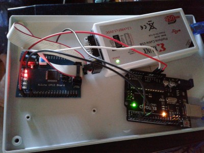

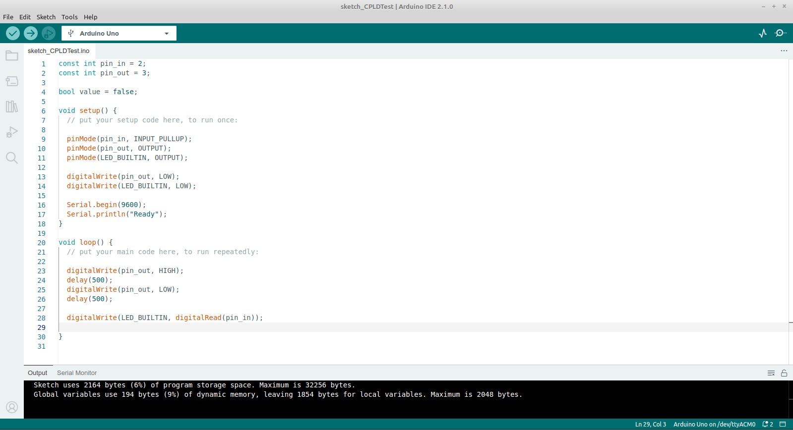

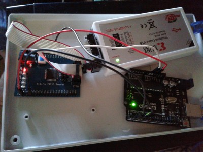

Edit: Adding Pictures, with code. I'm currently testing it with the Arduino, sorry it's not directly 6502 right now. The Arduino is able to send a clock signal to the CPLD. The CPLD then flip-flops the value, blinking it's own light, and then sending the value back to the Arduino. The Arduino then turns it's own light according to what it receives from the CPLD. Conclusion: The CPLD can receive, compute, and send back data!
