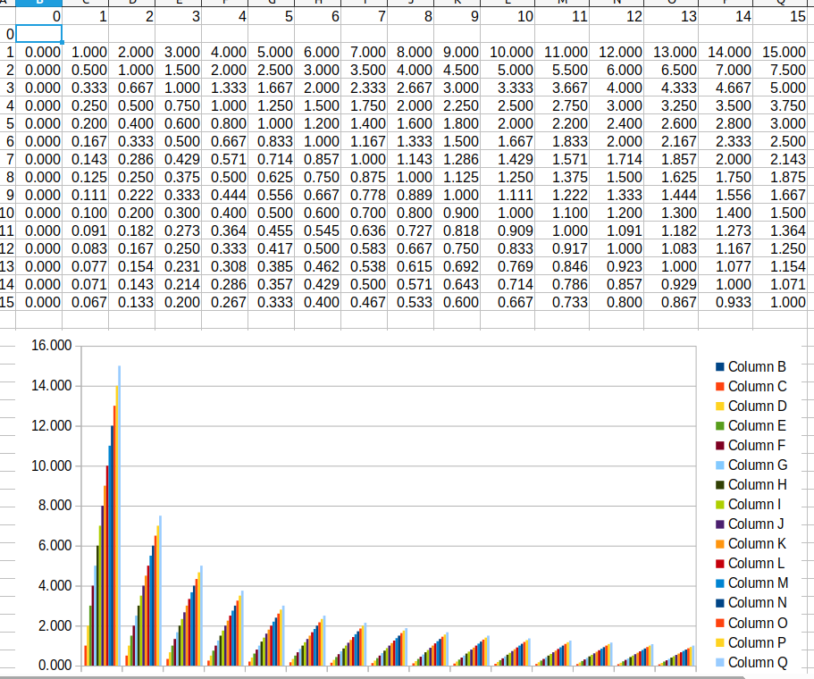

Hmm, I did a quick spreadsheet to look at the distribution of values with a four bit numerator and denominator.
It's clear that there are some problems - maybe they go away with more bits but I don't expect so. In particular, while the digits values 0-15 can be exactly represented, there are no fractional values available above 8. There are also a lot of repeated values: every integer below 8 is duplicated at least once, and '1' appears fifteen times. There are also fifteen zeros and fifteen infinities; many of the fractions are also present multiple times (0.5, 0.33. 0.25, 0.2, and 0.167).
That's a lot of wasted space.

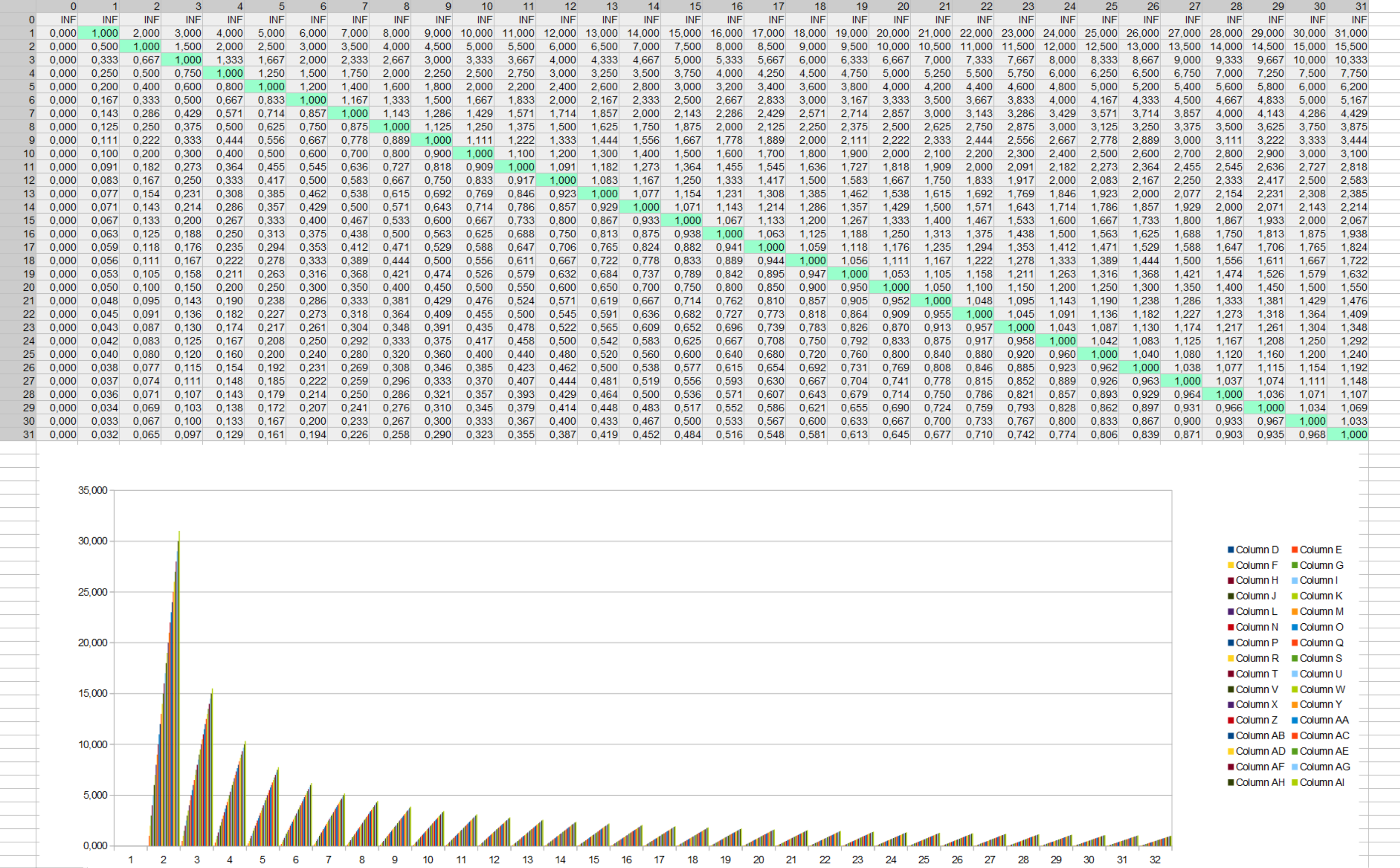

more bits doesn't make that issue go away, it just gives the spikes more "resolution" so to say...
looking at this, it makes sense that the largest fractional number is exactly half the maximum integer you can have.
so for 4 bits that's 15. and 15/2 = 7.5.
