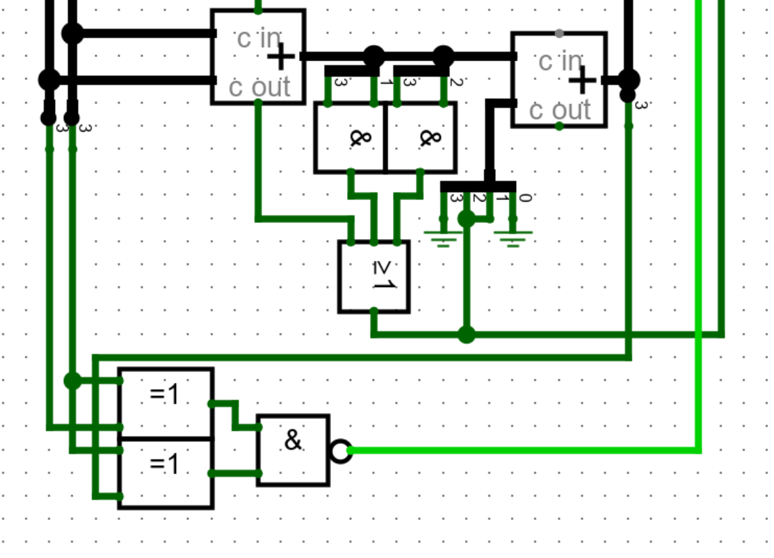

Well, my equation can be implemented in 3 gates (two XORs and a NAND). That hardly seems over-complicated.
yes but sometimes my laziness is close to infinity so even the smallest things are too much effort for me at the time.
also i'm having a hard time seeing where the gates are supposed to go as my BCD circuit is not that clean.
but i'll try! i recently got another project much closer to completion so i'm still riding that high!

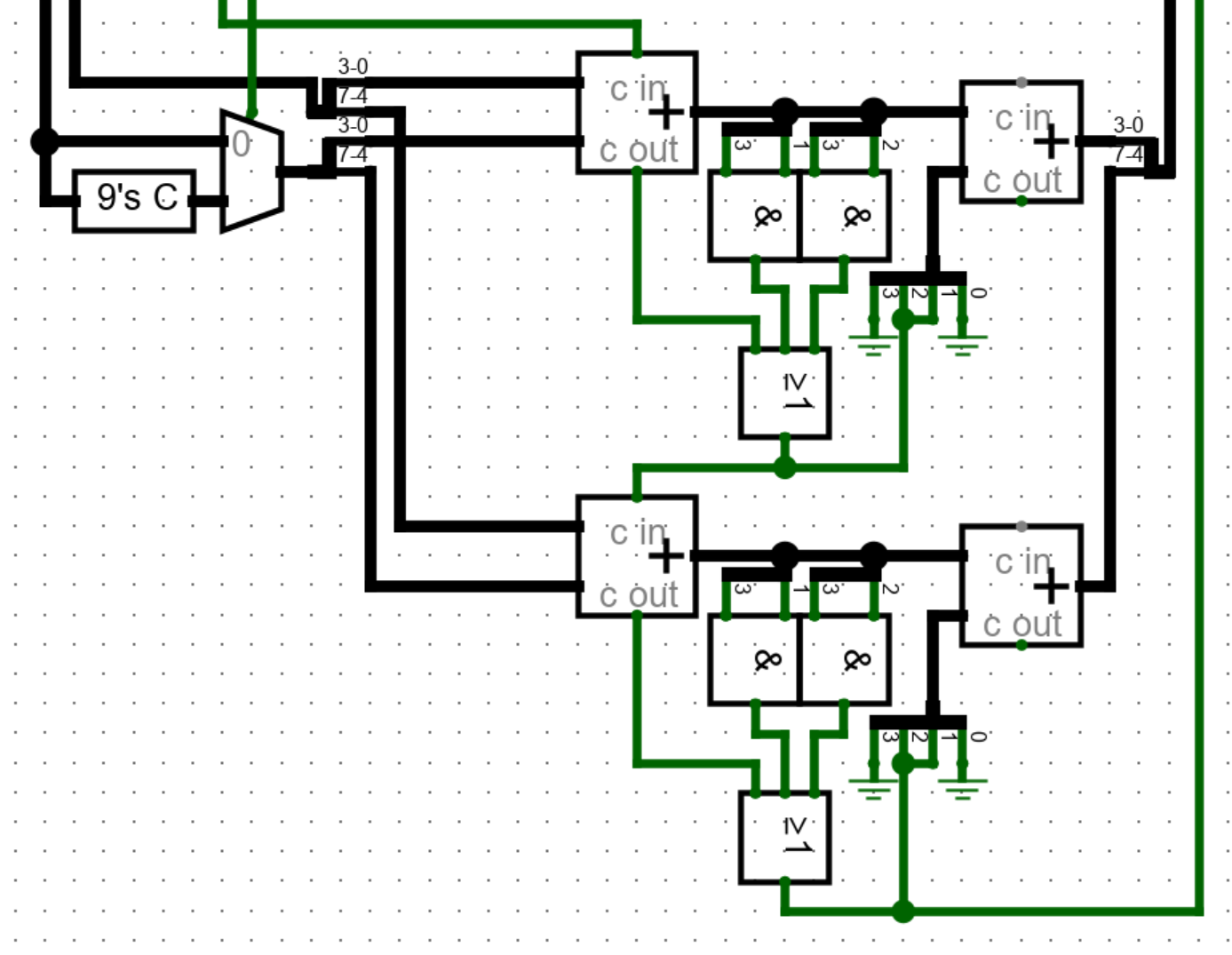

there are 4 seperate adders, 2 for each nibble/digit.
the input numbers and the carry input are on the left, and the output and carry output is on the right.
the first adder at the top left adds the 2 lower nibbles together, the carry output and the mess of AND/OR gates after that are to generate the carry output,
the adder after that to the right adds 6 to the nibble if the carry output is 1.
and the same thing for the upper nibble except the carry in is from the lower nibble adder and not the carry flag. the carry output goes to the carry flag like normal.
so, how i understand your equation:
V =  NOT((bit 7 of A XOR bit 7 of B) AND (bit 7 of A XOR bit 7 of s))
following that i get this:
looking at the top left, the right black wire is A, the one to the left of it is B, and the black one in the top right is s.
