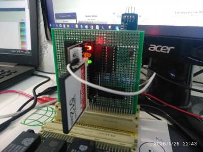

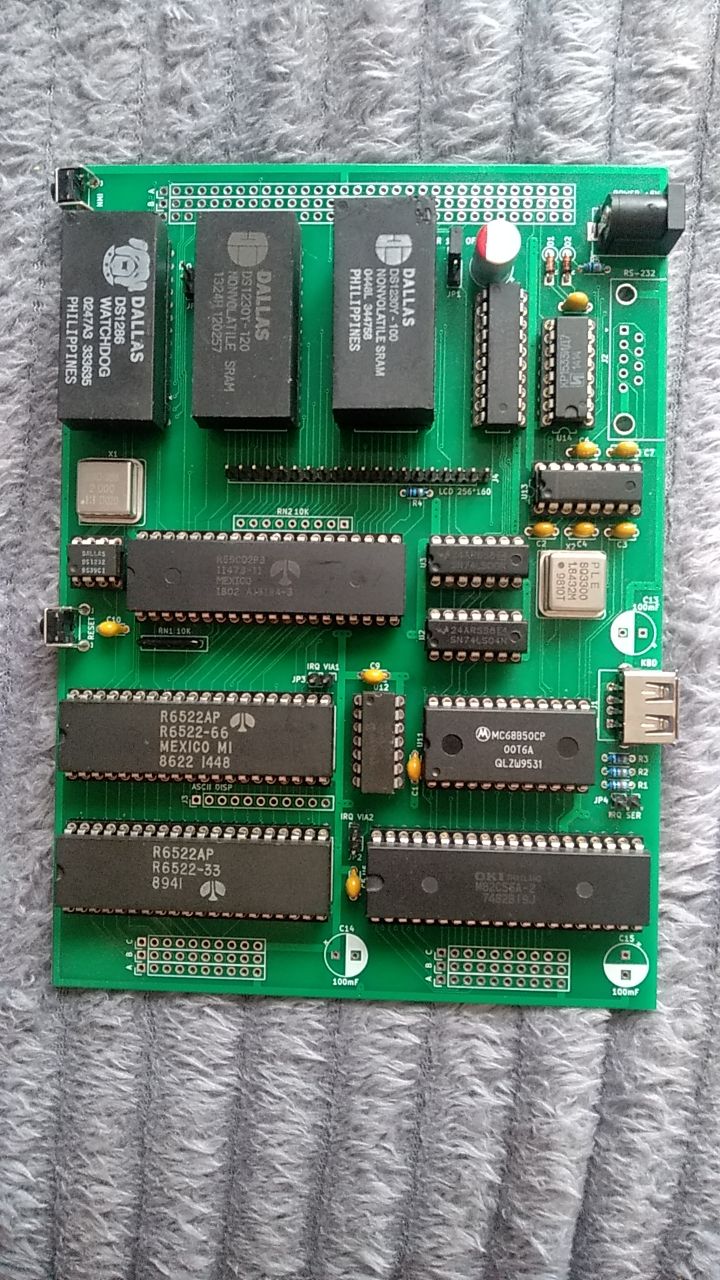

Good afternoon everyone.
I've recently become interested in the 6502. As a result, I've created this SBC, also assembled an HDD interface, an i2c interface board, and an spi interface board. I've written a display driver that supports CSI, adapted EhBasic and Wozmon and Krusader. I've implemented the ability to load files in HEX format from a PC. I've created a video card based on the PPU NES and written a display driver that supports CSI. I'm currently trying my hand at writing a DOS and a file system, but these are just the initial steps. I am glad to join your community. I will be happy to share my experience and learn from you.

Welcome! Sounds great, and looks good too! It'd be great to hear more about it, and more about your adventures in designing and building it.

More concretely interesting is your memory array. I see no ROM there, so can I assume that the ROM function is fulfilled by one of the battery-backup RAMs? For updates, I guess you'd want a bootloader of some kind (rather than yanking the chip out of its socket every time)...

Good afternoon, friends. Thank you for your interest in my design.
This is my first project.
In general, it was conceived as a small standalone desktop device that does not take up much space on the table, without the need to connect an external display, for experiments with connecting various programmable interface chips for their study, testing, debugging, with the ability to write and run programs on the device itself

Specifications and hardware:
Processor - currently a 65802 running at 4 MHz. So, my little guy is 16-bit.
Memory:
ROM - 32K. I installed non-volatile RAM while debugging the software, but it turned out to be very convenient, so I'm using it for now.
I made it writeable by setting a jumper. Some software can be overwritten.

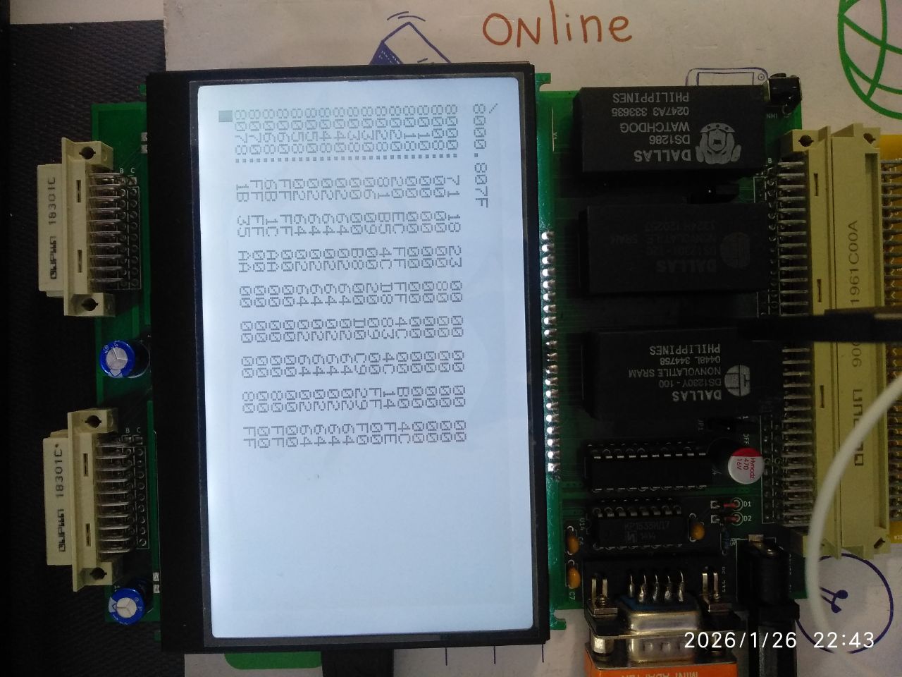

I created a PC HEX file loader via the RS232. It's called by the non-maskable interrupt button and is immediately ready to load a file.
32K of RAM is also implemented on a non-volatile chip.
Memory distribution: the first 32K is RAM, then 256 bytes are for internal I/O ports, and 256 bytes are I/O ports for devices connected via an external connector.
The remaining space is ROM.
There is a real time clock chip on the board DS1286.

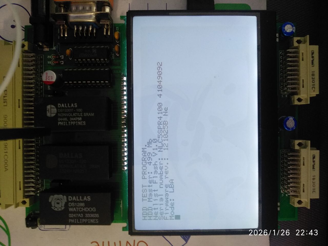

Display:
The 4-inch 256x160 LCD graphic display on the ST75256 chip with a 6x8 font provides 42 characters per line (20 lines).
It features hardware vertical scrolling. It is connected via a parallel interface directly to the processor bus.

2 VIA R65P22 - one for connecting a keyboard and a free port (reserved for internal use or connecting an ASCII display) plus the ability to generate internal interrupts using a timer. The second VIA has all ports routed to an external connector for connecting external devices.
1 8255 chip - all three ports routed to an external connector.
1 ACIA MC68B50 for RS232
expansion connector for connecting external devices.

Expansion boards that I was able to create and launch:
HDD IDE interface Lee Davison's http://retro.hansotten.nl/6502-sbc/lee- ... e-circuit/ - It's simple and works great. I slightly modified the GAL firmware to suit my project.
SPI and I2C board:
I2C on PCF8584
SPI on ATF1504 based on materials Daryl's Rictor https://sbc.rictor.org/65spi2.html - It's simple and works great.
May we see it? :mrgreen:
