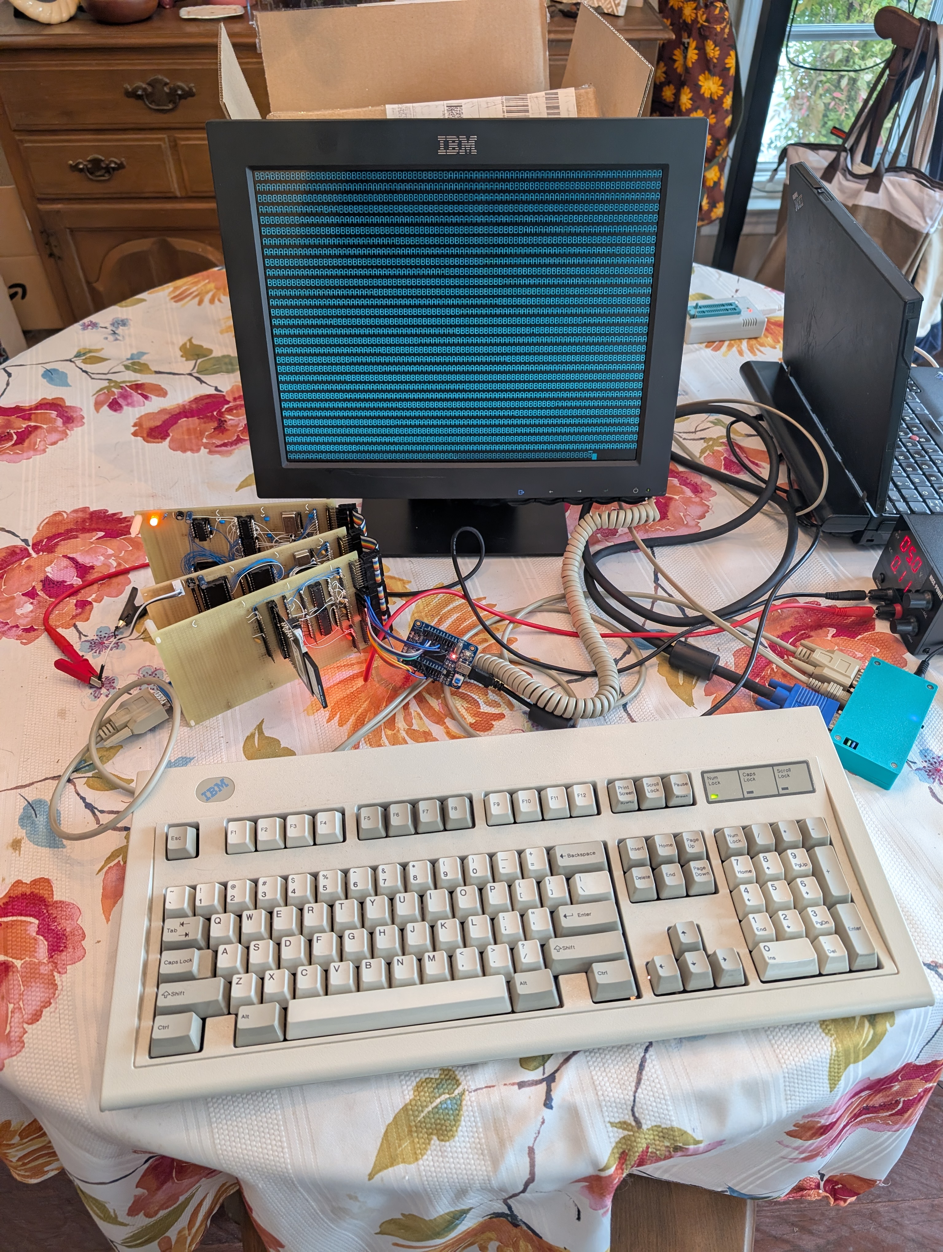

Well, we are all snowed/iced up here in Texas, so I've finally gotten around to working on one of my dream/bucket list projects, which is creating a mini-UNIX for my 6502 hobby computers. I added a few new OSDEV books to my holy trinity. One of them (An Operating System Vade Mecum) hasn't actually been delivered yet - it's probably stuck in an ice bank somewhere.
Anyway, my new 4MHz S(sic)BC has it's VIA2 hooked up to NMI. So the first thing I did was set up a 100Hz RTC.

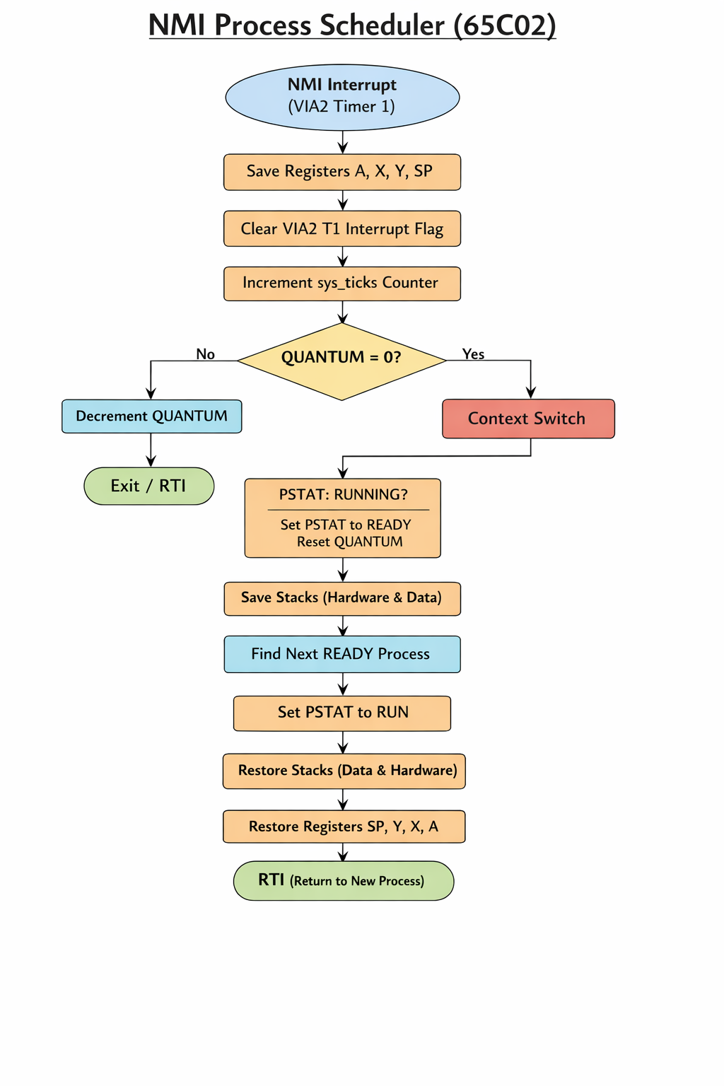

I spent the next couple of days working on "_SYS_mon" which is it's core process monitor - i.e., scheduler.
_SYS_mon:
; _SYS_mon - NMI interrupt handler (system tick from VIA2 Timer 1)
; Called every 10ms (100Hz) for preemptive multitasking
; Must be fast and non-reentrant safe

		; Process Scheduler
		LDA	current_pid	; Get current PID
		ASL	A		; x2
		ASL	A		; x4
		ASL	A		; x8
		ASL	A		; x16
		ORA	#QUANTUM
		TAX
		LDA	PROCTAB,X	; Check Quantum
		BEQ	.do_switch	; Is it zero?
		DEC	PROCTAB,X	; No, decrement it
		JMP	.exit		; And go back to what we were doing

.do_switch: 	; Step 1: update current process PSTAT and QUANTUM ---
		LDA	current_pid
		ASL
		ASL
		ASL
		ASL
		ORA	#PSTAT
		TAX
		LDA 	PROCTAB,X	; .A now contains PSTAT byte
		BPL	.not_run 	; If Bit 7 is clear, we're NOT RUNNING
; If Bit 7 is set, we *are* RUNNING, so we want to change state to READY
		LSR 	PROCTAB,X 	; set PSTAT to READY
		LDA 	#$04
		STA	PROCTAB+1,X 	; reset QUANTUM (It's the next field up from PSTAT)
.not_run:
; Don't touch PSTAT, or QUANTUM, but do save stacks and switch.
		; Save Stack Pointer at this point
		LDA	current_pid
		ASL
		ASL
		ASL
		ASL
		ORA	#STACK_PTR
		TAY			; Y = PCB offset
		TSX
		TXA			; A = Stack Pointer
		STA	PROCTAB,Y

I don't have a way to actually *create* processes yet - no _SYS_fork or anything like that yet. So I hand coded a couple of test routines - process A just spams 'A's to the serial output, while process B just spams 'B's. Here it is working! :D :D :D Task switches are about a 6% overhead, which could probably be better. But I think not bad for a first try!

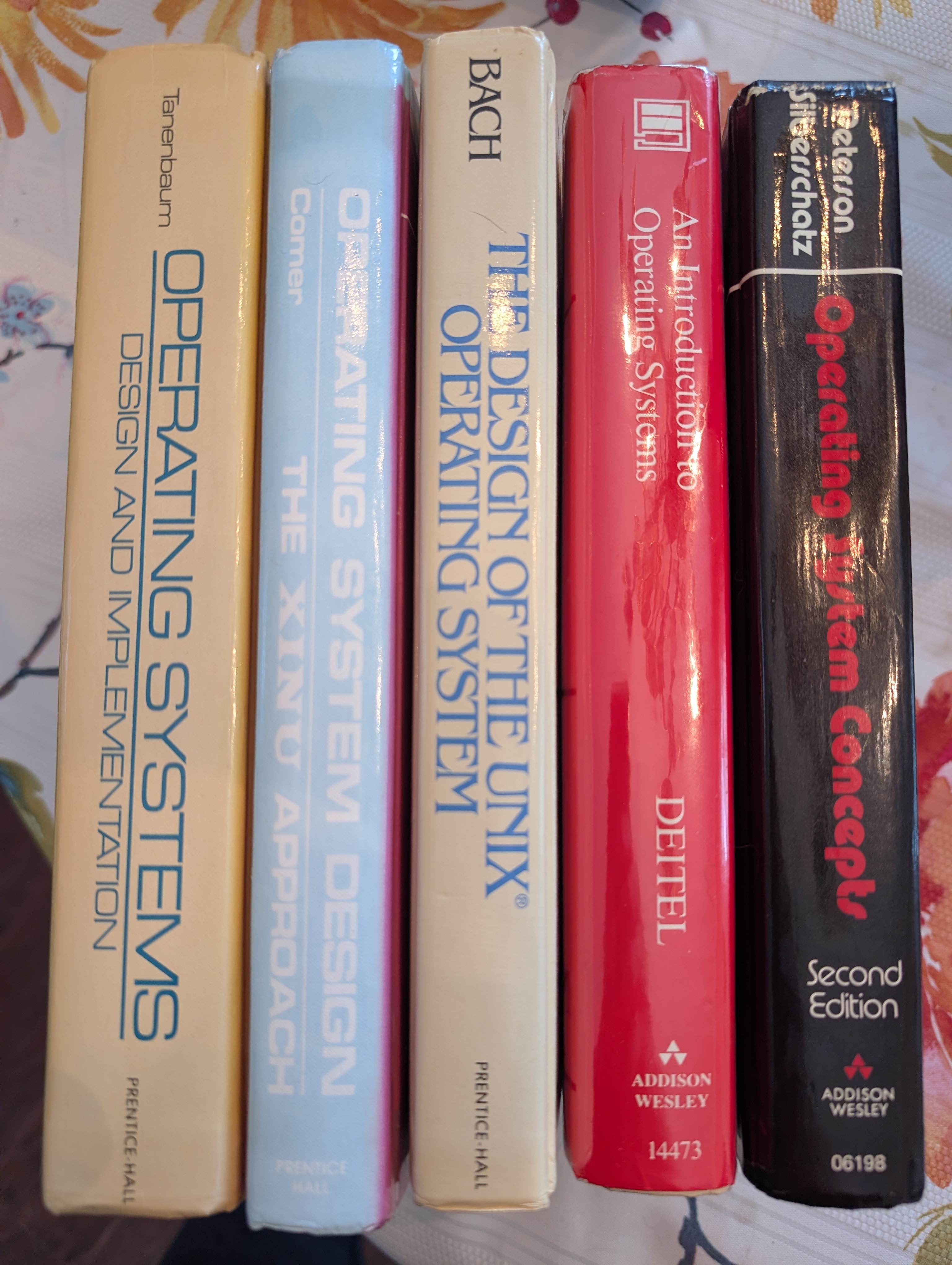

I see you have Maurice Bach’s excellent book.  My copy looks like it saw action at Normandy from so much reading over the years, 35 of them, to be exact.  :)
I sure do! It's the second in the "holy trinity," which I bought while we lived in San Diego 8 - 10 years ago. The MINIX book is the first on, given to me by a good friend in 2007. Only took me 20 years to start implementing! I'm still well ahead of OS/360 . :D

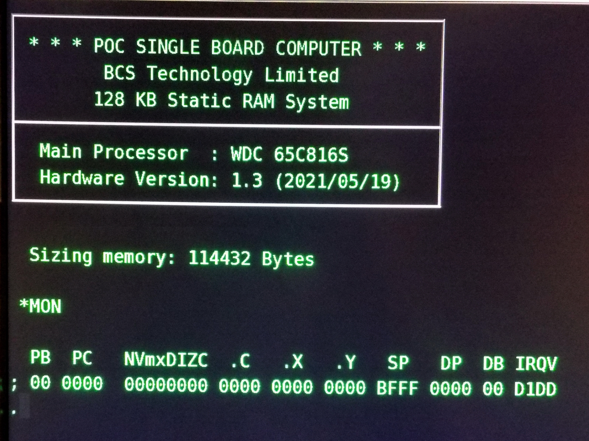

The DEC VT-100 could do box graphics, as could the best-selling WYSE 60 (and its many clones).  The latter could actual draw a rectangle by giving it a simple ESCape sequence to define the top-left and bottom-right corner coordinates.  I have some thin clients attached to POC V1.3, with them running with a WYSE 60 personality.  The rectangle drawing function appears to be instantaneous when commanded.  It’s slightly slower on the real WYSE 60 (I have two of them, one of which is an actual green-screen), but still pretty quick.  Of course, neither of these terminals could do the graphics seen in Gordon’s video.
The POST banner on my POC units includes box graphics, as seen on a thin client running as a WYSE 60.
POST Banner w/Graphics

jgharston wrote:
Gordon - how do you detect what output system you're writing to? My PDP11 VDU drivers do some horribly shonky prodding of the running environment tied up with some it-works-on-my-system assumptions to decide if it can do esc[...m type stuff.
My "RubyTerm" (a modest C program that uses the SDL libraries and runs under Linux) takes a "magic sequence" and replies with an equally magic reply. So at startup, the code on the CPU end sends the magic output and waits (but not for long) for the reply. Based on the reply, or not, it works out to pass the Acorn VDU codes through "as is", or run them through a local translation layer.
But to get there, there is another layer - so as well as the usual Acorn codes, there is an extra code and that tells RubyTerm to do extra "stuff". Such as inkey (osbyte &81) and stuff like enable/disable the visible cursor (there is no copy cursor) because that's fiddly to manage sensibly. Also stuff like read pixel (osword 9), font (osword &A). It also doubles up as an FTP style program so from the command-line on the RubyOS, I can pull a file from the linux host and store it locally.
It just sort of grew...
I use ESC as the start of these "magic" functions as it's not used in the Acorn world. ESC 0 (as in a single byte zero, nul) is the "identify" and RubyTerm has to respond inside 100mS with 42 (as in &2A, "*") That code is ignored by ANSI/vt100 type terminals, so seems fine to use. The code in the CPU side is more or less the same as the code in the Terminal side in that it gathers the bytes from each command then works out the translation to ANSI.
If my current "next-gen" system, as it's all BCPL, I'm doing the probe or not, depending on the bootstrap code detecting the underlying architecture - on the '816 (serial console/graphics), or ARM32 (Pi V1 with native graphics), RISC-V with either serial graphics OR native graphics and then loading the appropriate dynamic VDU dynamic library at boot time. The '816 system when booted in Acorn MOS mode will do the original so BBC Basic can continue to work, but in my BCPL world programs make library calls to move the cursor (e.g. vduLeft (n), vduCls (), etc.) so programs are agnostic to the underlying output device.
