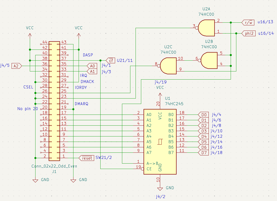

Using the IDE-CF adaptor module
This derives two signals from the 65c02 control signals: R/~W NAND PHI2 gives a ~RD signal on pin 23 and ~(R/~W) NAND PHI2 gives a ~WR signal. The 74HC245 isolates the CF from the databus when not required, with the data direction selected from R/~W. You may have to investigate your socket to ensure the pins match; the numbers in this diagram match those on my adaptor, viewed from the pin side. Pin 20 is missing.

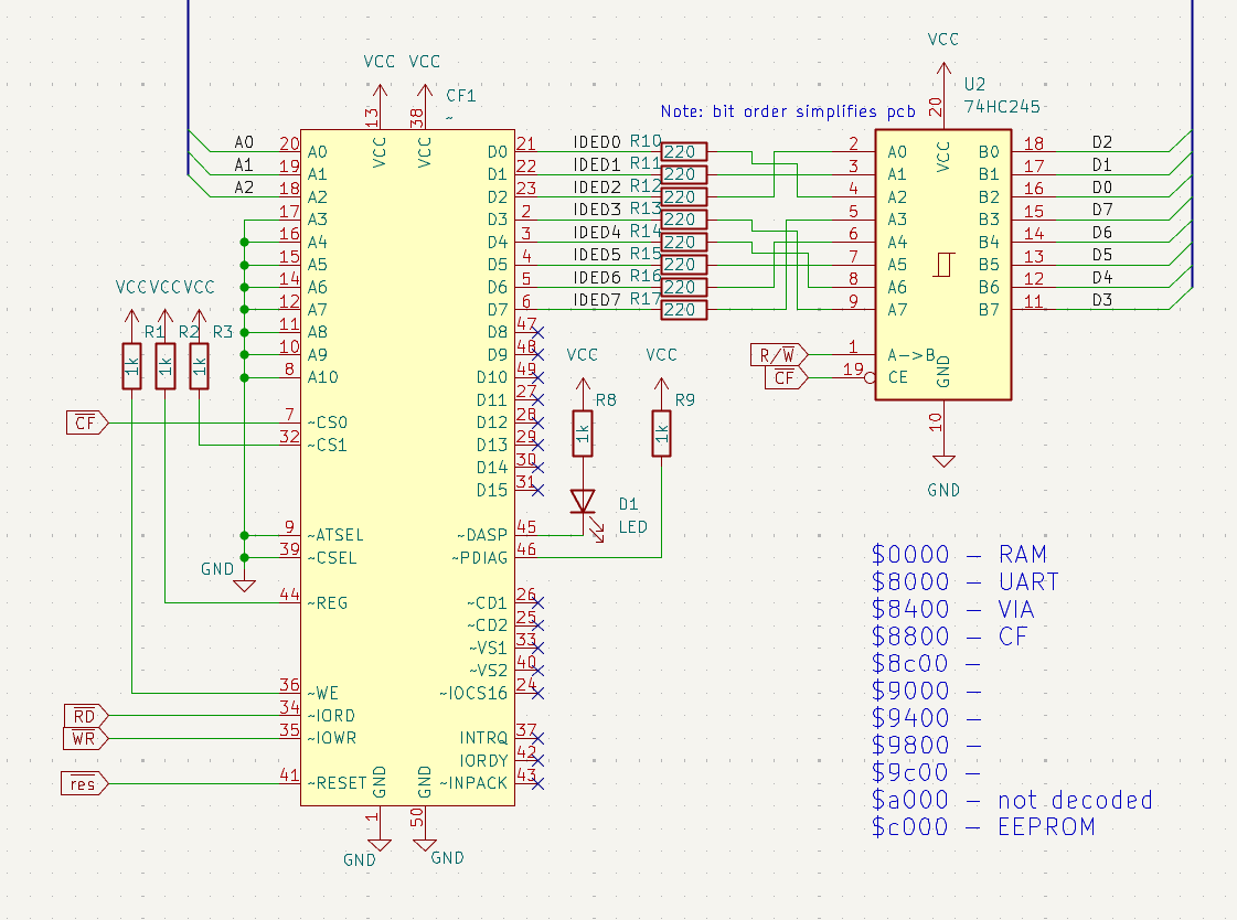

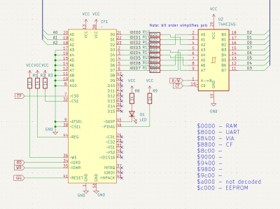

Using the CF card directly
This shows a section of the single board card described above. Again, ~RD and ~WR are generated as above, and the '245 works the same way. The series resistors are _probably_ not required - they're not there on the adaptor, for example - but sources on the web strongly suggest that they be fitted to slow down the edges of the data.
Note: the CF is specified to work at either 3.3v or 5v; for 3.3v its access time is stated at 600ns and half that for 5v. I suspect that it is in fact significantly less, particularly with modern fast cards.
Threads discussing the development of both designs can be found here: viewtopic.php?f=4&t=8482 and here: viewtopic.php?f=4&t=8501
To be continued.
