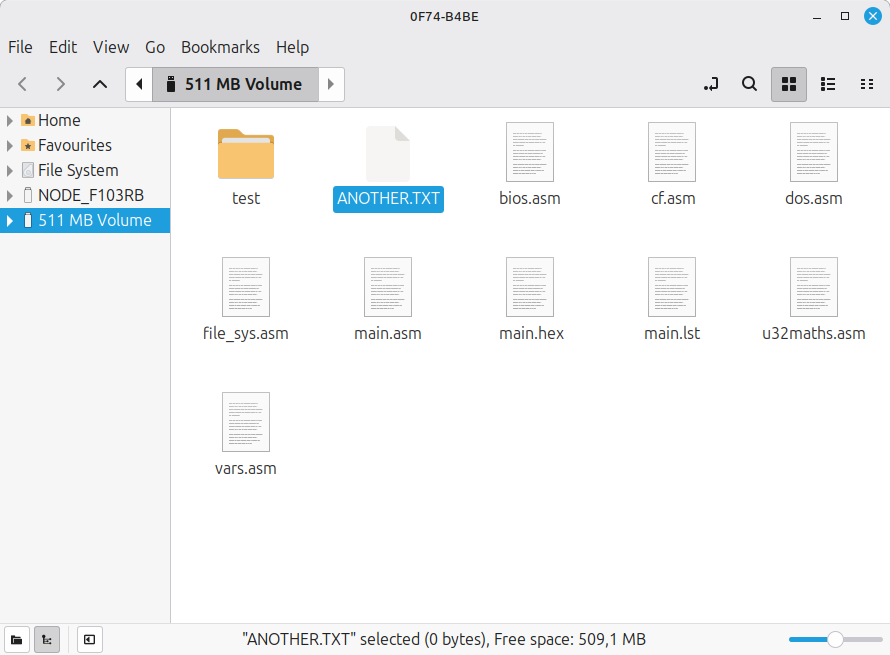

Re: Adventures in FAT32 with 65c02
f_create
Taking into account the comments above, f_create takes a string pointer in Y:A and, if there is no matching filename already existing in the current directory, creates a zero length file with no allocated cluster (i.e. cluster zero, as discussed earlier).
This file is happily visible both by f_create, if run a second time with the same filename, and by my linux box: First run - the test code performs a directory listing before attempting to create the file:
And on the second attempt:
in which the listing shows the file is already present, and so the create fails.
The calling code:
and f_create, still with all sorts of debug code in.

NeoDOS32 v0.0072
BIOS.ASM
CF.ASM
DOS.ASM
FILE_SYS.ASM
MAIN.ASM
MAIN.HEX
MAIN.LST
U32MATHS.ASM
VARS.ASM
[TEST]
ANOTHER.TXT
Failed
The calling code:
LYA new_file
jsr f_create ; returns zero set if create worked
bne m1
PRINT "File created"
jsr crlf
bra m2
m1:
PRINT "Failed"
jsr crlf
m2:
lda #'+'
jsr putchar
bra * ; wait forever
