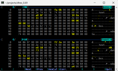

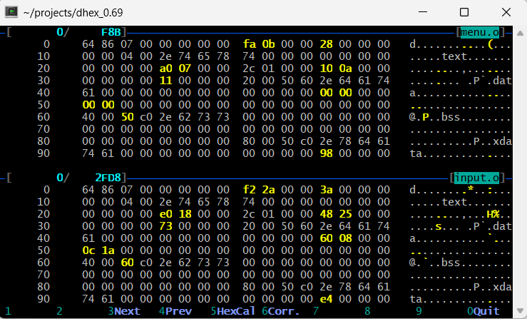

I'll recommend dhex as a good terminal-based Linux utility for doing binary diffs. Most distros have it available in their package manager, or you can download it and compile from source (it just needs a C compiler and libncurses-devel) from https://www.dettus.net/dhex/. It's a hex editor, but it has a diff mode if you give it two filenames. The main feature you will probably enjoy is the ability to specify the starting offset on the command line (so you can jump directly to the sectors of interest) using -oh [put hex value here] or -od [put decimal value here] before giving the two file names. I expect this to be useful because you'll be looking in the same spot (once you determine where that is) and could make a shell script to get the image off the CF card and then compare it to your known good filesystem, jumping right to the directory entries.
It's F10 to quit by default, although I had an issue on one of my linux boxes where F10 was already used by the window manager so I remapped that key. It lets you (forces you to) map the keys the first time you run it.

Thanks for the recommendation.
