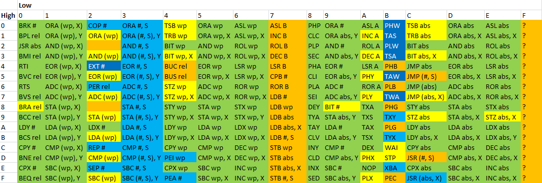

I was thinking about this myself a few months ago (april) and this is what I came up with: Green is all the original 6502 instructions (the backwards compatibility part), Yellow are 65C02, blue 65C816 and Orange are instructions of my own design.
There are two new registers: B, a secondary accumulator, and W, the Working Page pointer (equivalent to the Direct Page register in 65816). All zero-page instructions are replaced with equivalent instructions indexed by W. Instructions for B are added, including XBA, all the RMW instructions and some LD/ST instructions. No, B is not as flexible as A, but its not really meant to be - it is secondary afterall. JMP and JSR using (#, S) address mode added to support passing function pointers on the stack.
The P register has two new flags at bits 4 and 5: U and E respectively. If bit E is clear (which is the default on reset) then incompatible extensions are switched off - BRK shares its vector with IRQ, and the U bit behaves as the B bit does in 6502, and the SO pin messes with V. If bit E is set then BRK has its own vector, and the U flag mirrors value input on the SO pin. There are two new branch instructions, BUC and BUS, for the U flag.
Unfortunately I cannot remember what PLG, PHG and PEC where supposed to do.
The chip would be pin-compatible with the 65C02.
There's certainly been many interesting suggestions in this thread. I like the 10-bit bytes idea, though I'm not sure that it would have been practical in terms of memory ICs, even in 1980. I do like some features of both the 65CE02 and the 6809, but I also dislike each of them for one reason or another.
Re: How would YOU extend the 6502?
I would guess that PLG and PHG need to push and pull some state: how about General state: they could push and pull A, B, X, Y, W, maybe P. For some kind of task switch, perhaps.
Whereas PEC looks like it should be a bit like PEA, PEI, PER which Bruce describes thus:
PEA, PEI, and PER all push a 16-bit value onto the stack. In fact, they could be thought of as the different addressing modes of the same instruction, since the operation is otherwise the same
I'm sure other guesses can be made, and I'd be interested to see them...
So, PEC needs to push something 16-bit flavoured. How about the concatenation of A and B?
