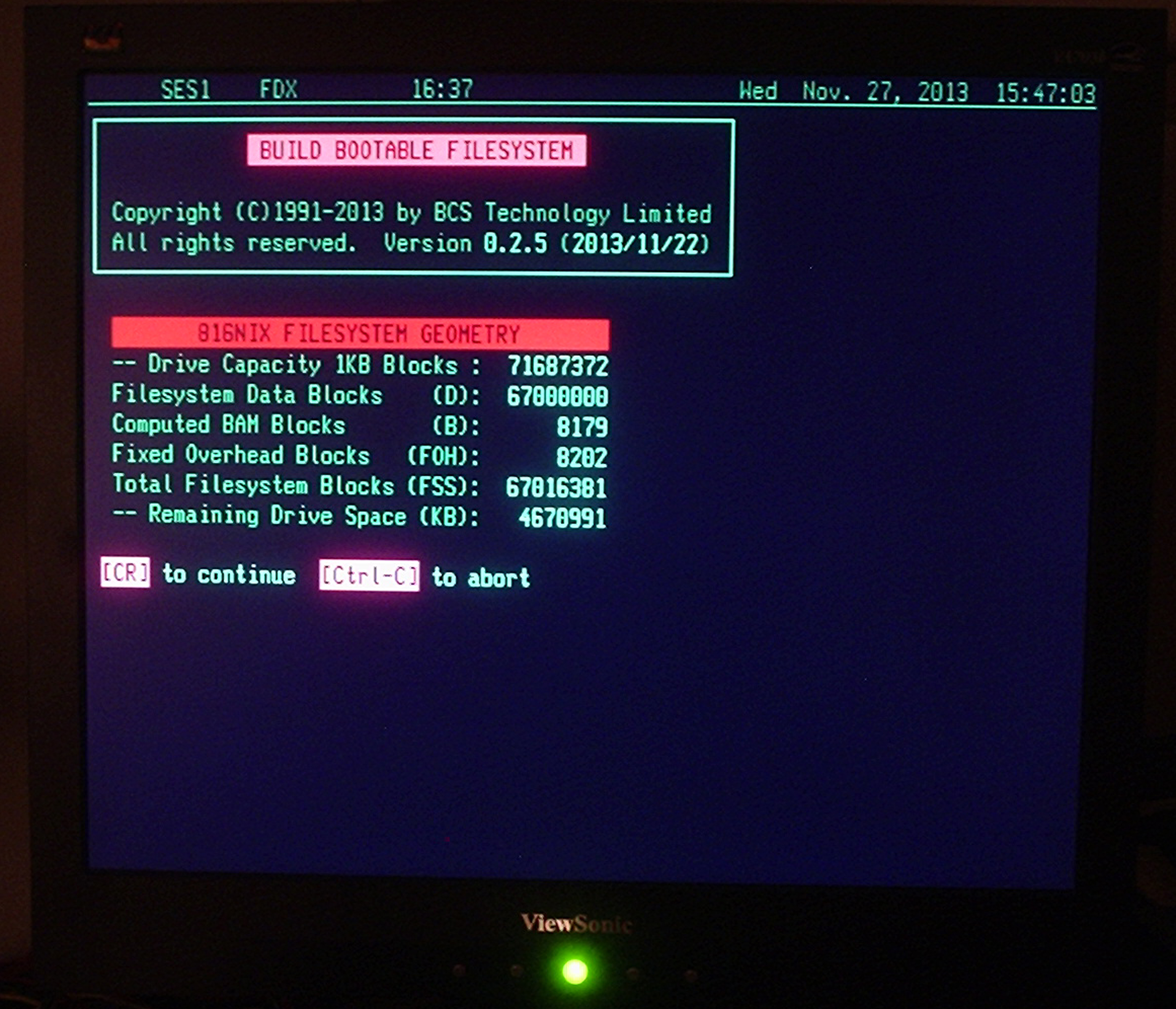

I continue to rationalize my 816NIX filesystem's design with an eye to reducing the amount of overhead in the structure, as well as the amount of grunt work to be done by the MPU in accessing and manipulating the filesystem's structure. The present design consumes only 0.03 percent of the total filesystem size in static overhead, not counting dynamic overhead used in creating directory structures and indirect block lists. So some progress is being achieved.
All storage in the 816NIX filesystem is managed in 1KB "logical blocks," equal to the size of two physical disk blocks, assuming a hard drive with a default format. I arrived at that logical block size by crunching various possibilities to determine how efficient they would be. Using larger logical blocks tend to be more efficient in compute-bound terms—the bitmaps that track storage will tend to be smaller—but less efficient in the use of available storage space. Smaller logical block sizes reduce slack space when many small files are created, but increases SCSI I/O activity when larger files are accessed, since a single SCSI transaction can't transfer as much data as with a larger logical block size.
As disk capacity isn't really much a concern these days, I decided in favor of a larger logical block size to improve SCSI throughput and reduce the processing overhead needed to manage the filesystem structure. 1KB turned out to be a good compromise, especially when working with a 16 bit MPU. Ergo the disk capacity listed in the above picture is approximately 68.37GB, using a 1KB logical block size (the drive is a Seagate ST373307LW, which has an advertised formatted capacity of 73.3GB).
"Filesystem data blocks" is a test value that I used—it can be anything, as long as it will fit within the 816NIX 64GB limit (explanation of that limit follows).
Overhead includes a superblock, an inode allocation map (IAM), a data block allocation map (BAM) and a BAM tag block. The superblock and the IAM account for the "fixed overhead blocks" value—the present design uses a fixed value of 65,535 for the number of inodes available to catalog files, resulting in the IAM being contained in eight contiguous 1KB blocks. When a new file is created, the IAM is scanned to find an unused inode. In order to minimize disk activity during a search for an unallocated inode, a "tag byte" is maintained in the superblock, with each set bit in the tag byte corresponding to an IAM block that points to at least one unallocated inode. Hence disk activity is limited to a single read of the corresponding IAM block, followed by a later write of the same block after the IAM has been updated.
"Computed BAM blocks" refers to the number of blocks in the BAM that will be required to track the usage of the data blocks. The BAM is a essentially a gigantic bitmap, with a one-for-one correspondence between each bit and a data block. A set bit indicates that its data block is unused. As 816NIX logical blocks are 1KB in size, there are 1024 × 8 bits in a block. Hence, each BAM block can track up to 8192 data blocks.
Also associated with the BAM is a "tag block," one logical block in size, with each bit corresponding to a BAM block. If a bit is set in the tag block it means that the corresponding BAM block points to at least one unallocated data block. As with the use of the IAM tag byte, this BAM tag→BAM→data block hierarchy eliminates the need to search the entire BAM to locate an available data block, especially important as the space consumption in the filesystem approaches the maximum. The BAM tag block can map up to 1024 × 8 or 8192 BAM blocks. Therefore, the maximum number of data blocks that can be supported in the 816NIX filesystem is 8192 × 8192, or 67,108,864 1KB blocks, equal to 64GB.

That screen shot in my last post is from software running on POC V1.1. The display is of the parameters calculated from the input value of 67,000,000 data blocks. When [CR] is pressed at the prompt, the filesystem is generated and is theoretically capable of storing files.
