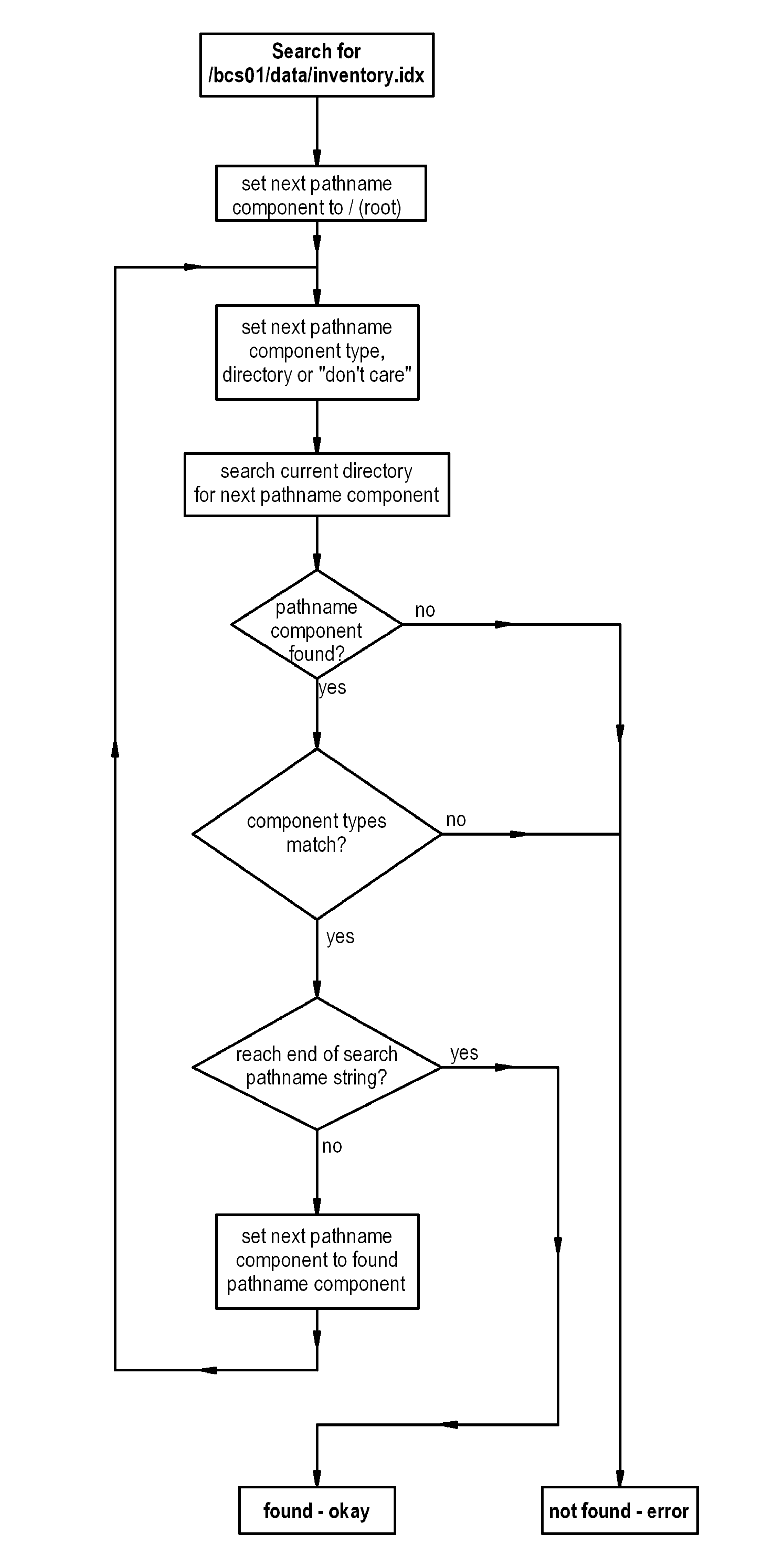

More complicated is the use of a partial or full (absolute) pathname, e.g., /bcs01/data/inventory.idx. If the first character in a pathname is / then the kernel starts at the root of the filesystem hierarchy, as defined by the root directory inode number in the process' u-area, which may or may not be the system's actual root directory. Otherwise, the search commences at the current location in the filesystem hierarchy, as defined by the current directory inode number in the process' u-area. The process becomes an iterative one, as depicted by the following flow chart, which shows a search commencing at the root directory:
The above algorithm, with a minor change, will work for all three search cases. If the search involves a partial pathname or a simple filename, the current working directory is initially set as the next pathname component in the first step of the algorithm. The rest of the search proceeds as shown.
During namei's search, intermediate pathname components (e.g., bcs01/ and data/) are expected to be directories (the trailing / indicates that this is the case), so not only must a name character string match occur, the matched entry's file type must be a directory, which is determined by loading its inode and examining the file type bit field. If the entry is not a directory then the search immediately terminates and a "file not found" error is returned to the caller. Otherwise, the inode becomes the next pathname component and the search reiterates.
It is clear from studying the above that namei has to scan each pathname component to see if it is terminated by /, as that is how namei "knows" that the path to the desired filename traverses yet another directory.* Furthermore, if namei determines that it has reached the end of the pathname string (determined when the terminating null is encountered) it must ignore the file type of that last pathname component, as that component could be a file or yet another directory (it will be up to the higher level function that instigated the search to decide if the file type is appropriate). Not shown are the steps that must be executed to actually read the directory contents from the disk—various kernel primitives take care of that, or the functions that parse the pathname into individual components, e.g., bcs00/, data/ and inventory.idx.
Aside from the mechanics of searching are those of security. My namei algorithm doesn't show the procedures where the kernel determines if the user has access rights to any component in the pathname. So part of the loop would be checks to examine the ownership and permissions of each pathname component and compare them to the user's. These checks are actually fairly simple, as every user and user group is identified by a unique word-sized (16 bit) number, and permissions are defined in a word-sized bit field. If the user doesn't have permission then the search will abort and return a "permission denied" error.
