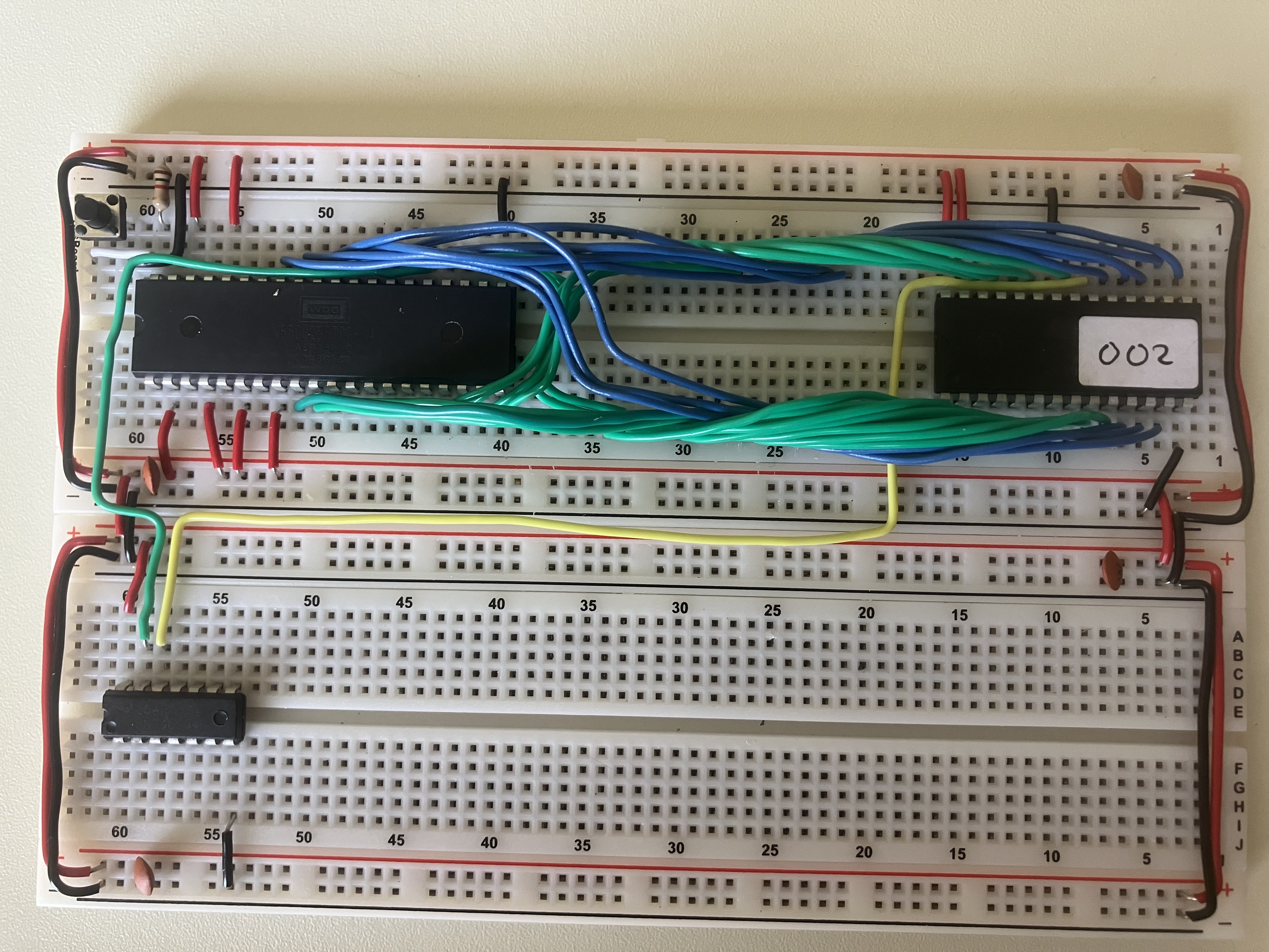

Just for completeness -
I tested all connections (testing from the 6502 pin to the exact breadboard "hole" where the removed EEPROM sits), and tested all pins and connection points for possible shorts, no joy.

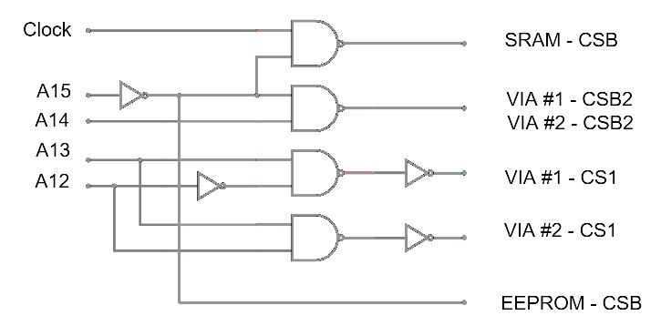

It looks like this: http://www.qwertyboy.org/files/6502-001.jpg (the "002" sticker is because I have multiple EEPROMs so I can keep track of them).
Some/most will recognize a "Ben Eater" project. I wanted to change the layout of the components - the original had (on the top breadboard, left-to-right) 6502-EEPROM-SRAM, I want it to be 6502-SRAM-EEPROM (so removing/re-adding the EEPROM will be easier). That should explain the longer wires to the EEPROM - the SRAM will sit in between the 6502 and the EEPROM (once all is happier).
I also wanted to expand the computer with a second 6522 - that's why I am using an additional 7404 as part of the glue, as the glue will be more complex. See http://www.qwertyboy.org/files/6502-002.jpg .
So I took the entire (working) setup apart and started anew, and somehow broke it. Guess it will take a shade longer to get it all working again (but then again, that's what hobbies are for - spending time on stuff you enjoy). I already had a second 65C02 on order for something else, should arrive this Monday, so I can easily rule that out.
-Niek.

In any event, you said you're using a modified Ben Eater design, all other things aside; it would be helpful to see a schematic of how you have things wired up, and possibly a photo of your build.
Yes, a schematic (not in color!) would be very helpful, along with a clear photo of how you constructed your gadget.
