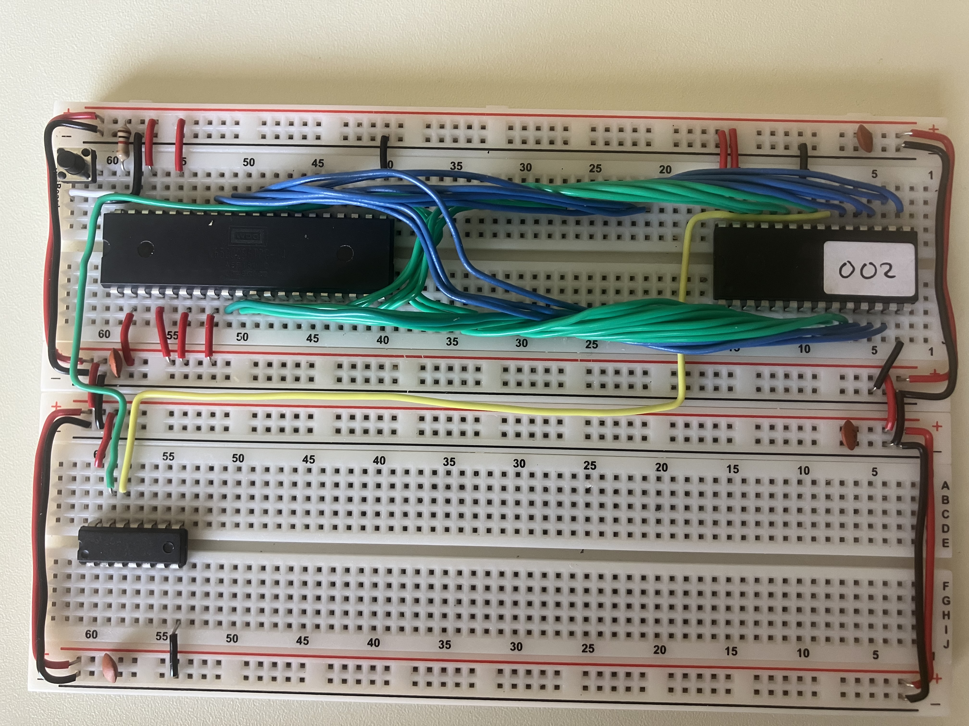

Anyways, the pic of my test setup is attached. I will work on an Arduino-and-555-free setup with an added 6522 (but as said that will likely have to wait a bit). Thanks for the comments on the reset button (ah - more wisdom to ingest) and the RDY pin (goes to show I really need to read the datasheets, as is obvious with many other comments). I do have two gates on the 74AC14 available, so probably won't hurt to feed the oscillator into one of those just to be on the safe side.

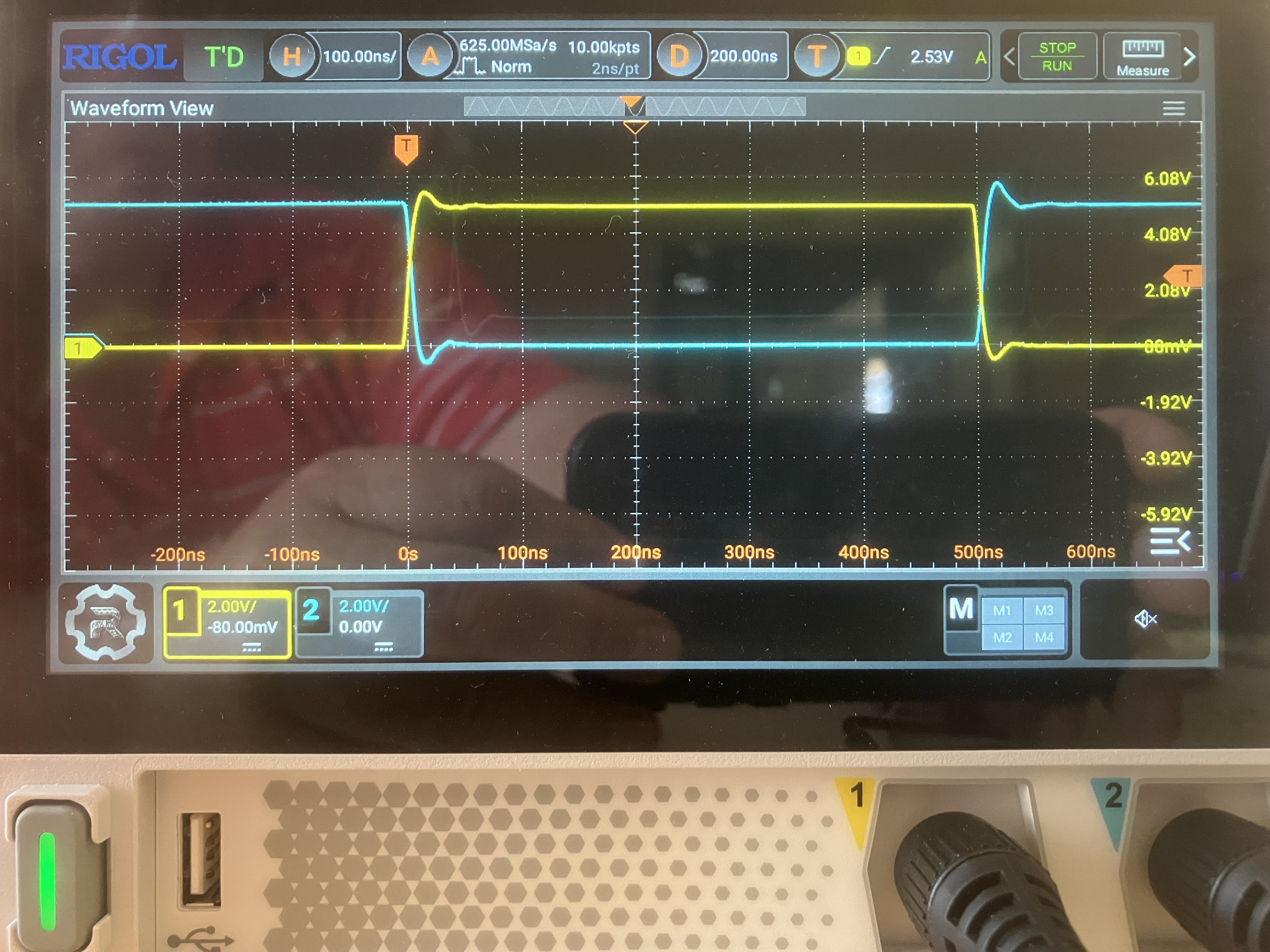

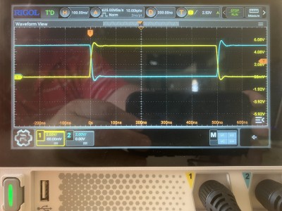

Success! The setup (a 65C02, an EEPROM and a 65C22) are working fine (eliminated the 555 clock and the Arduino test). Thanks all! I will post a "lessons learned" later.
Doing so will result in a sharply-defined signal with single-digit transition times, which is what the MPU likes.  The idea is to eliminate “gotchas” from the circuit that can create undefined conditions within the MPU and fool you into thinking your design isn’t working.
Attached is a scope monitoring the oscillator pin directly (the yellow line) and the signal directly after going through a 74AC14 gate while a "blinking LEDs" test program is running (the blue line). They look almost identical, so the 74AC14 for cleaning up the oscillator signal is likely not needed, but I will leave it in as I have that gate available anyways.

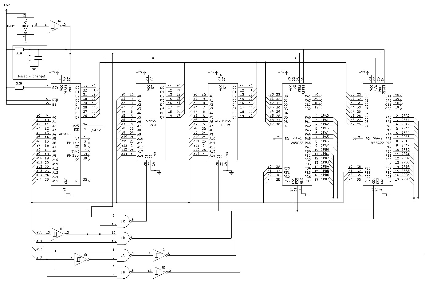

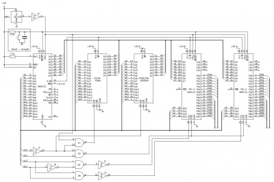

Just an update - all is working OK with 2 VIAs (will need to rework the reset circuit as was advised). See attached for the current schematic. Hopefully it is not too messy.

Are you decoding and overlapping I/O address space at $4000..$7FFF with RAM in the $0000..$7FFF address space?
Good catch - a14 should be tied to OEB on the SRAM (it is actually on my breadboard, I was trying to document after the fact). I will update.
-Niek.
Posts: 9426
Re: Issues with 6502?
Aside from the decoding oopsie pointed out by Michael, what is the purpose of the Schmitt inverter connected to the clock oscillator?
That is actually because of your input - we discussed forcing the clock input to be sharp and snappy (see a few posts back). I also posted a picture of measuring the oscillator output and the output from the inverter. Looks like the oscillator provides a proper clock, but I had that gate available anyway.
Ah-so!
Usually a flop is employed for that purpose, which gets clock symmetry right at 50:50 (within a nanosecond or two).  However, at the modest speed at which you are running, symmetry is unimportant and just about any sort of gate whose outputs meet requirements would work.
If you carefully read the data sheet, you will see that input hysteresis for Schmitt-triggered inverters can be all over the map.  It’s not uncommon for the input voltage at which the output switches from low to high to be substantially different than when the output switches from high to low.  Depending on the characteristics of the oscillator, the inverter could exacerbate asymmetry in some cases.  While that doesn’t matter in this case, it’s something to file away for future reference when you decide one day to build a 20 MHz special.
