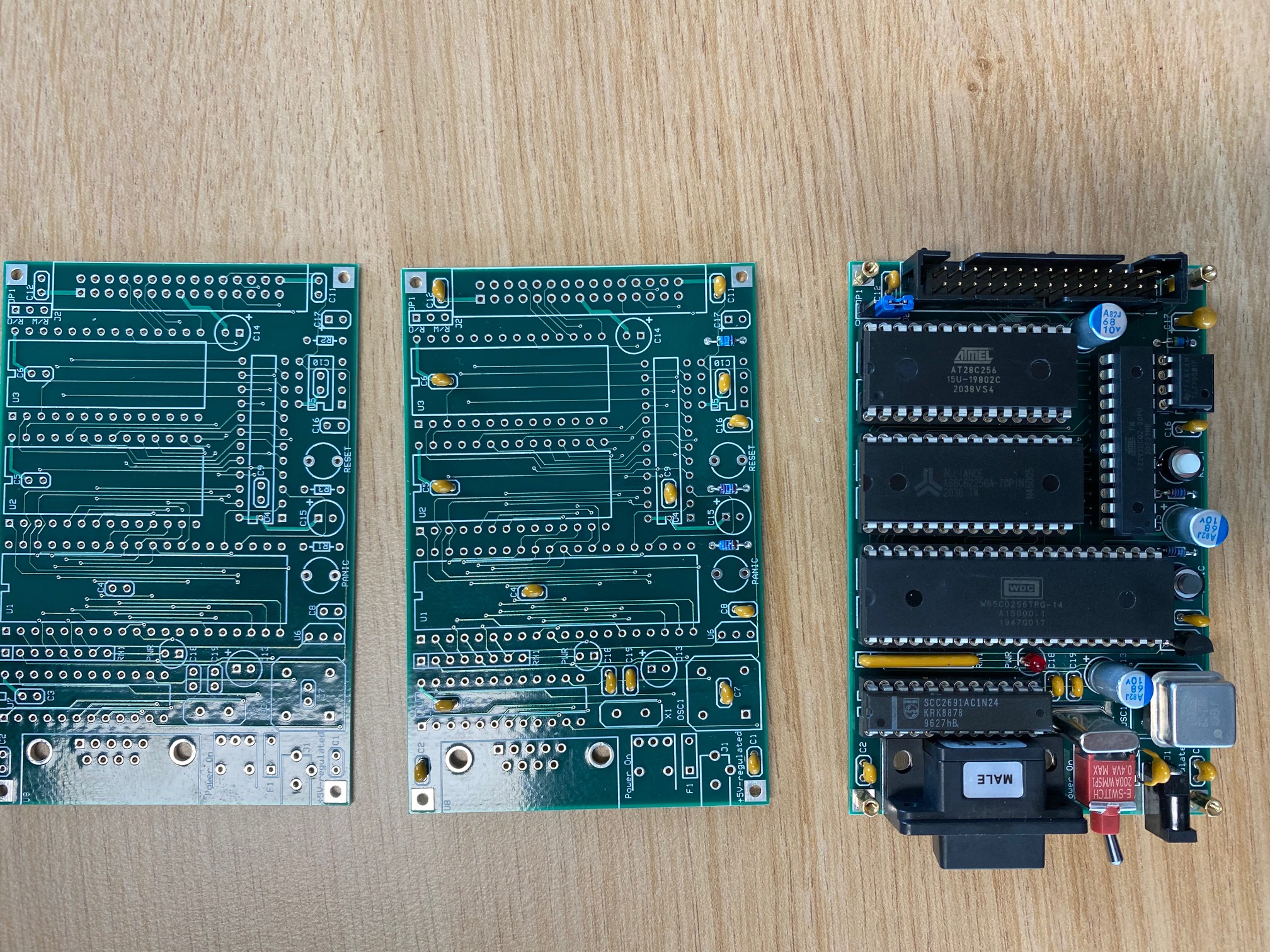

I was looking around for a compact and well documented 6502 board and Kevin's C02 fits this bill!
https://github.com/floobydust/C02-Pocket-SBC
You can order the PCB's through ExpressPCB https://www.expresspcb.com/.
I live in The Netherlands, so the sending costs are a bit steep but the quality of the PCB's is excellent.
On github there is a helpful overview of the parts with a Mouser order number.

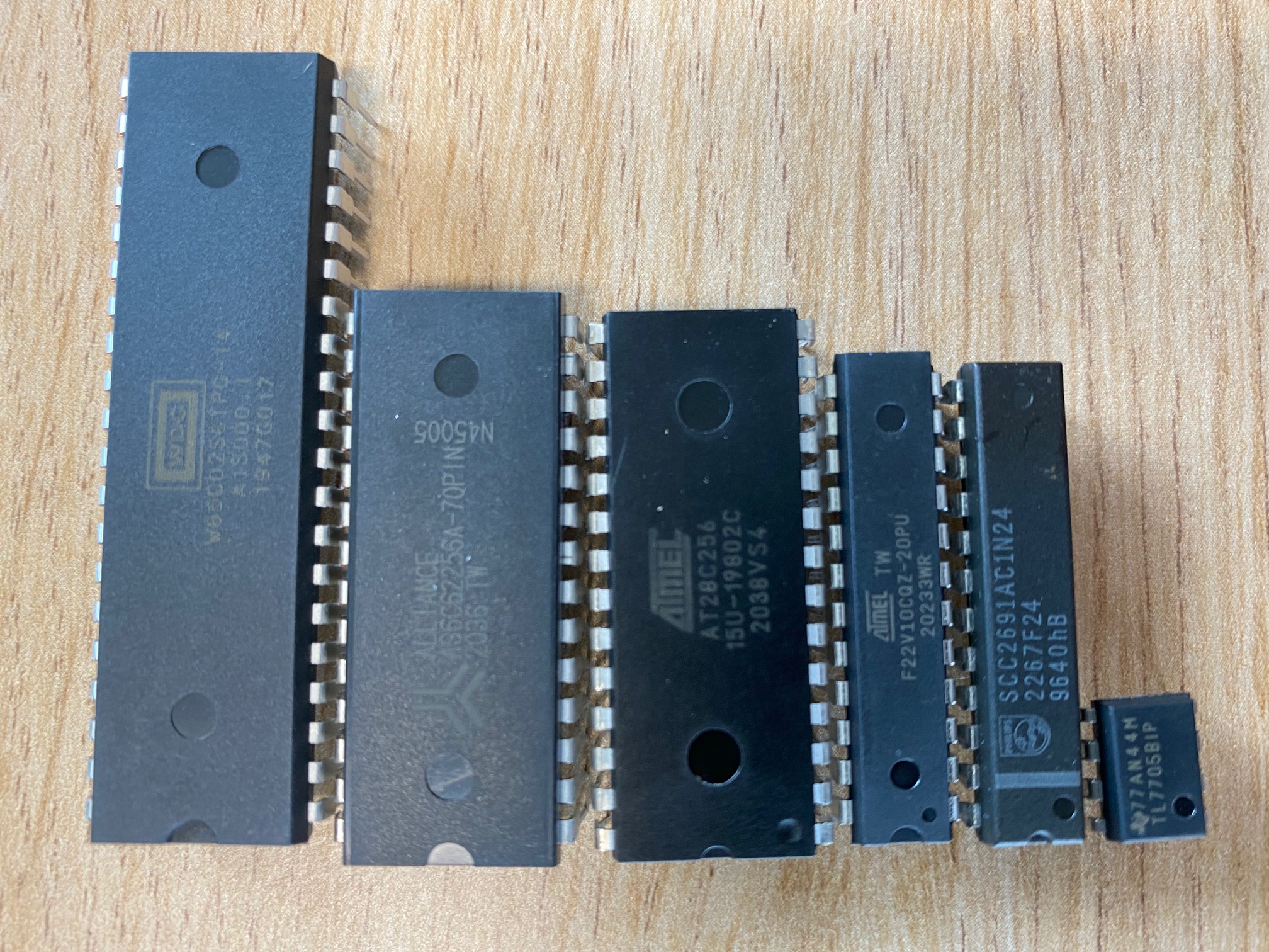

Here is an overview of the required IC’s.

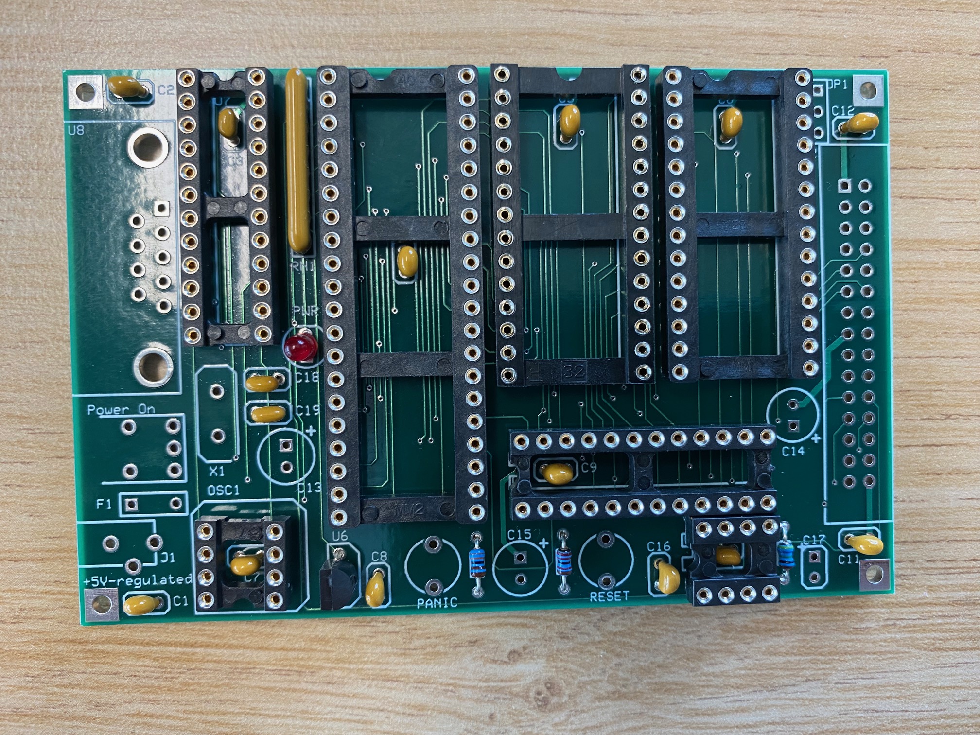

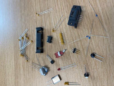

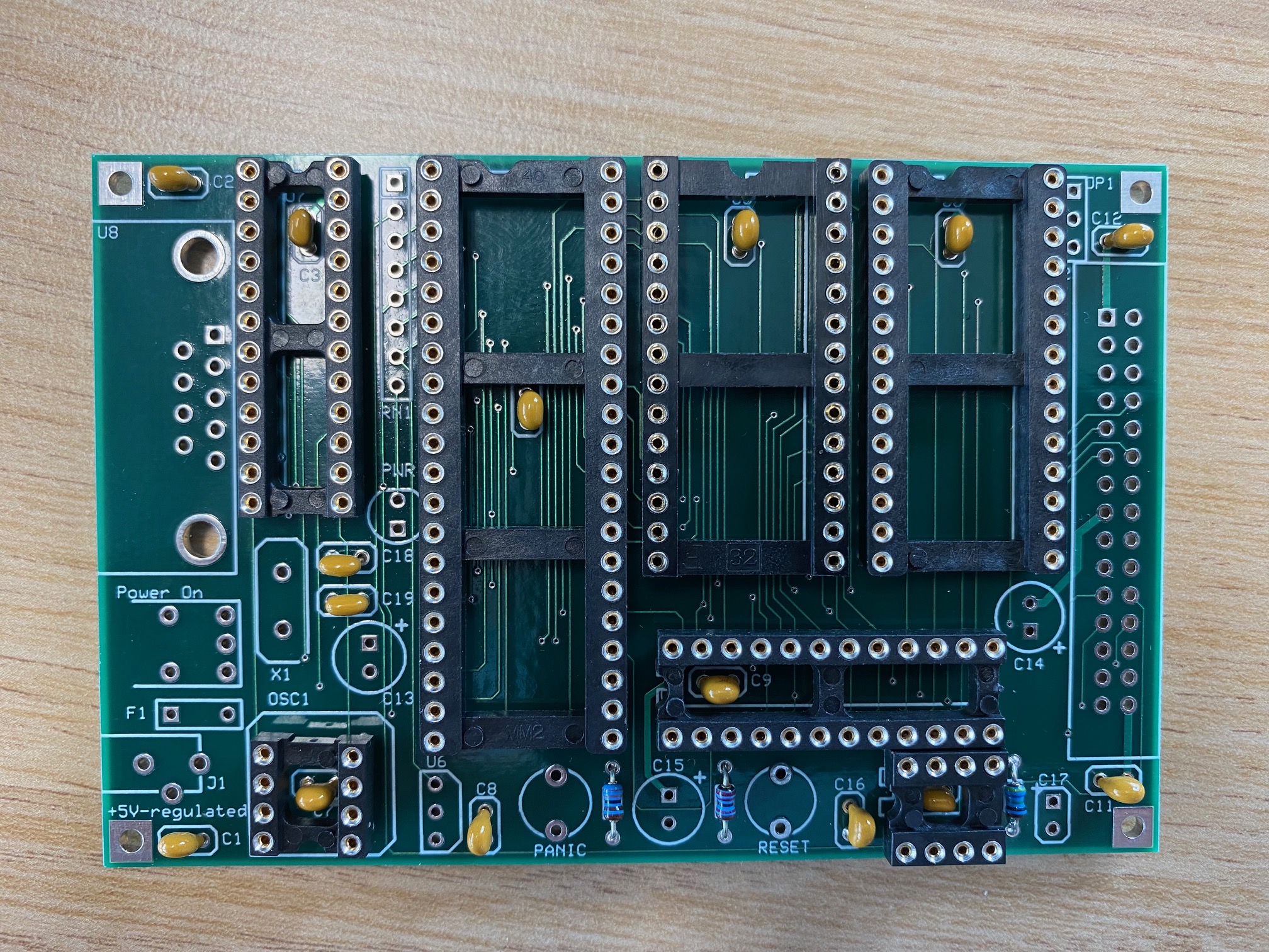

Starting with the lower parts (condensators, resistors).

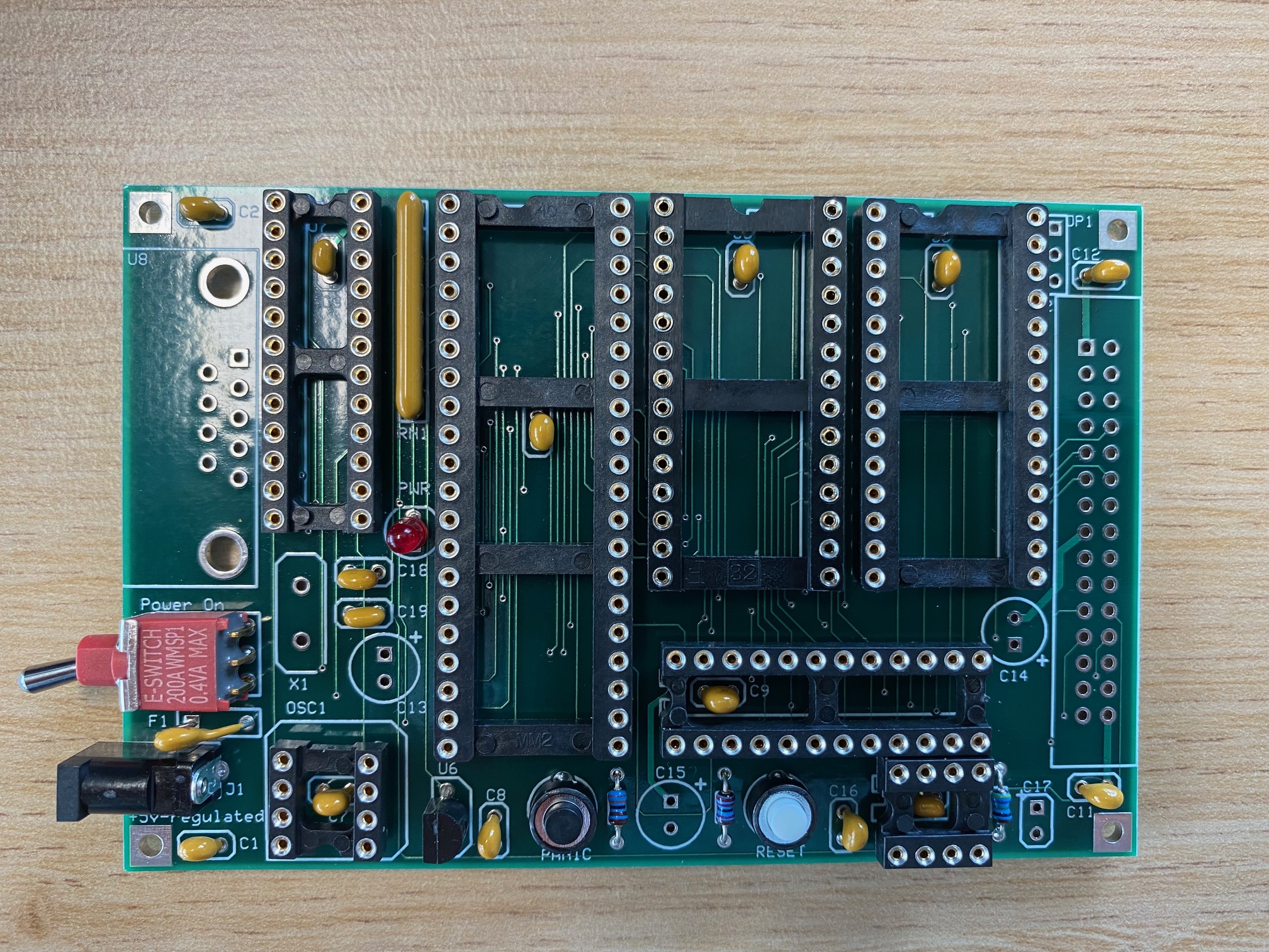

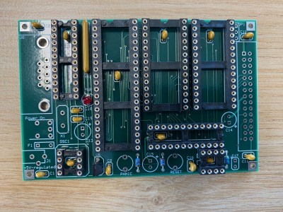

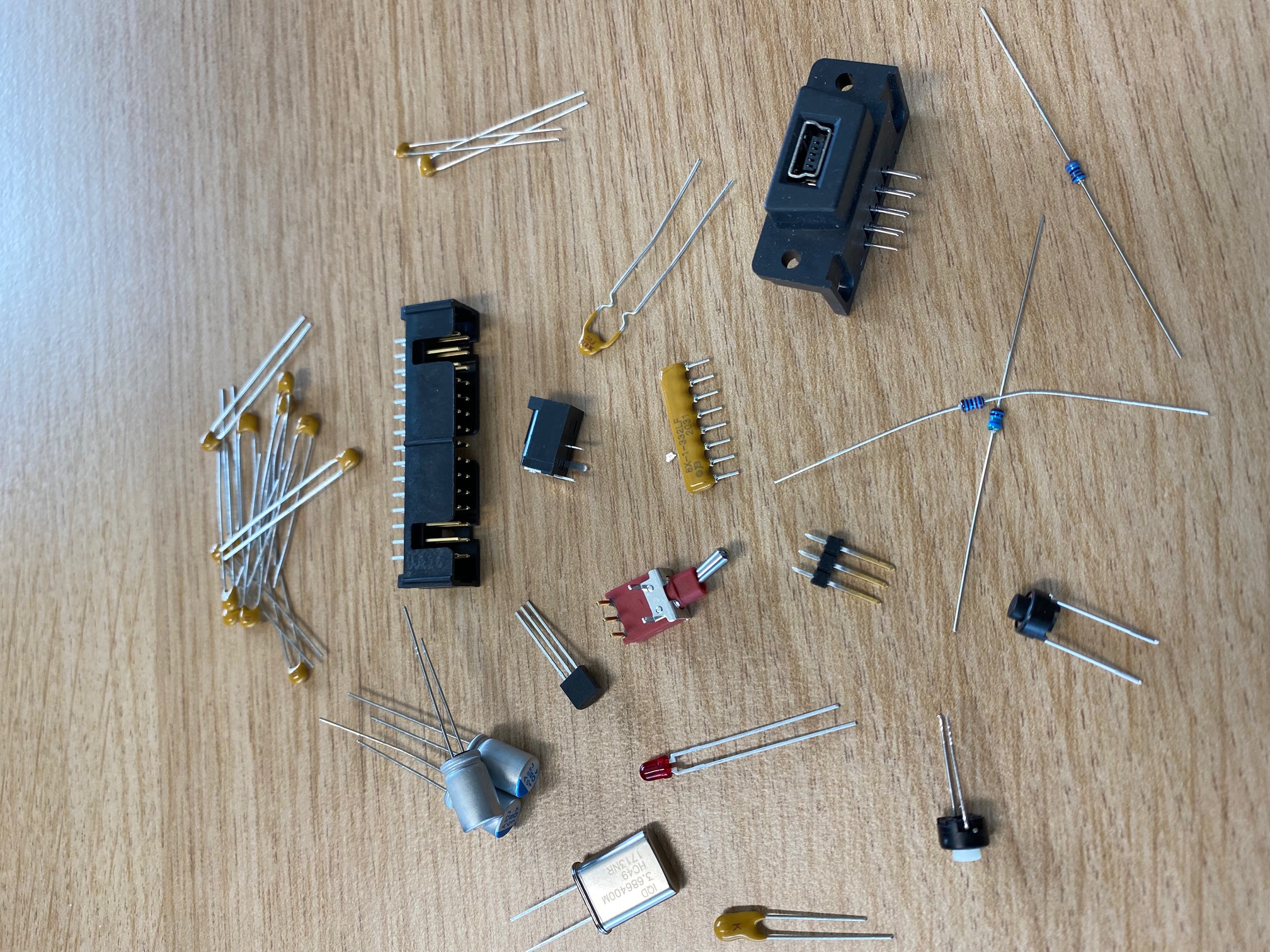

Next are the Resistor arry, Led and Reset chip.

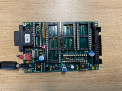

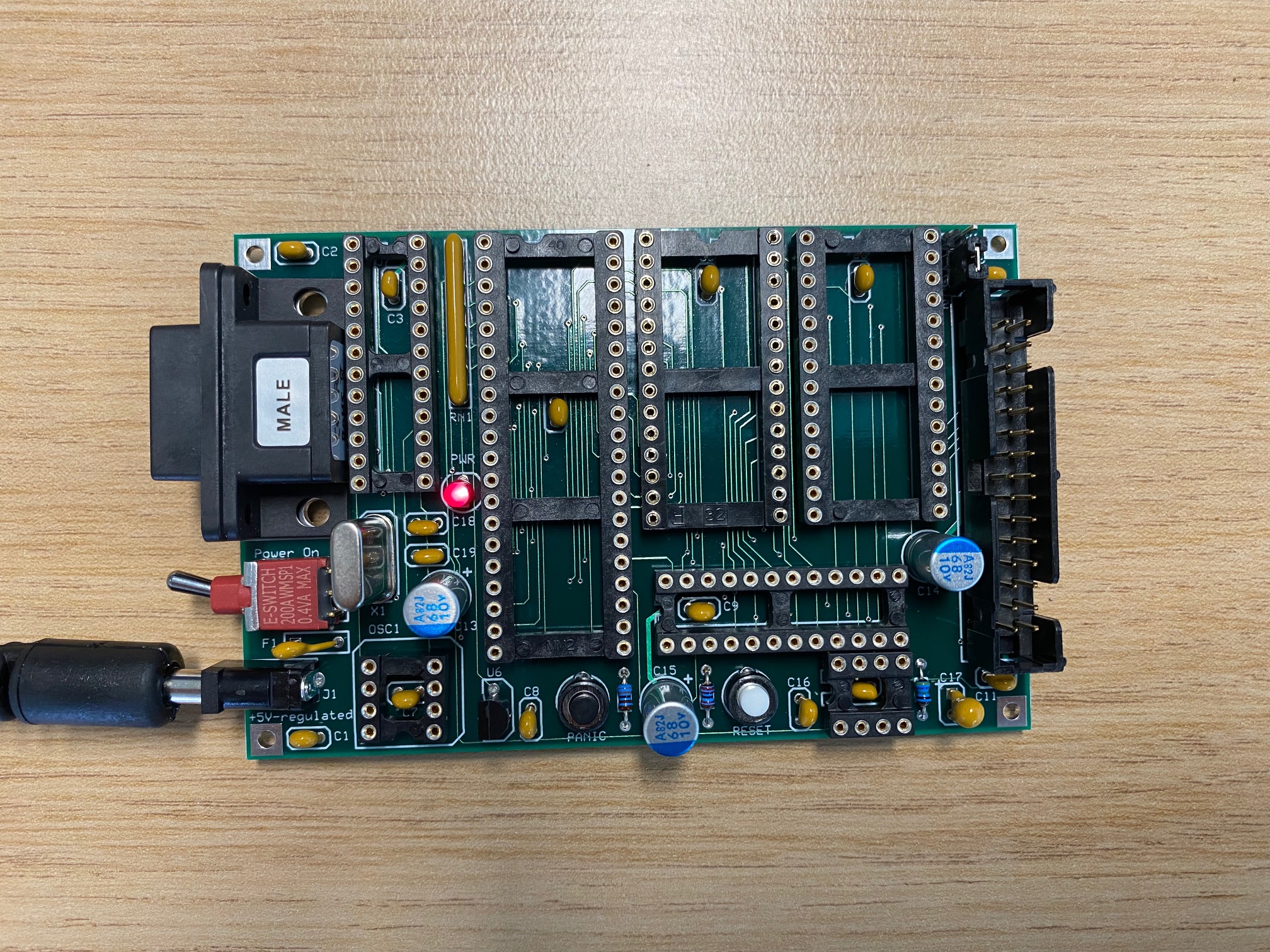

Followed with some switches and power connector.

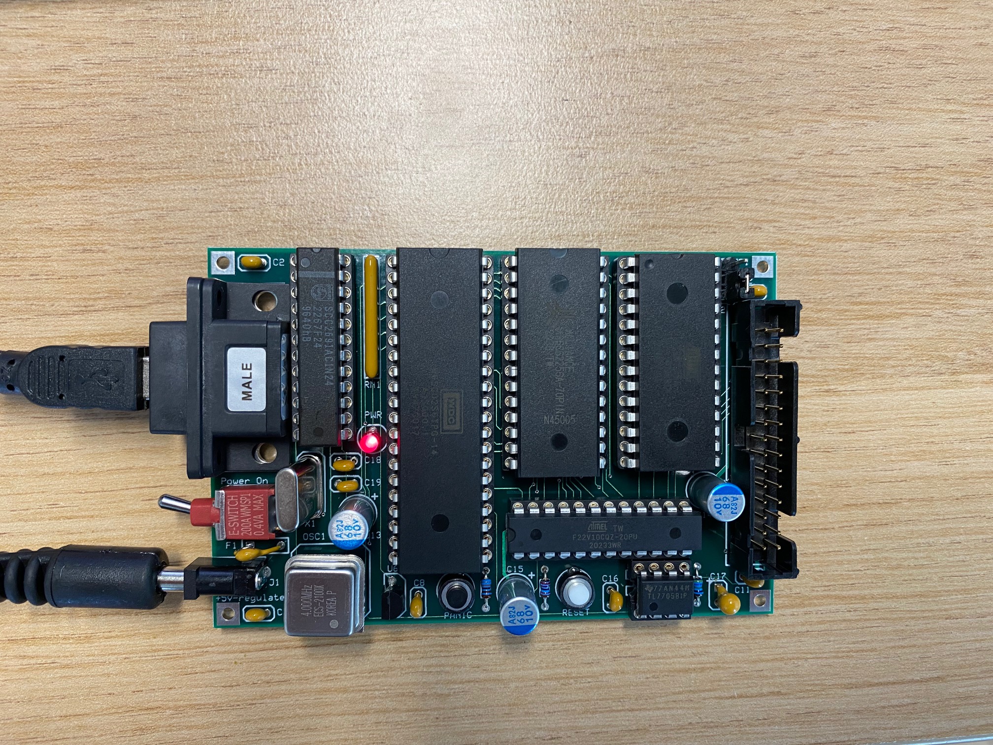

When all parts are fitted, power can be supplied and tested.
Led is working, IC's are getting 5 V. Almost there!

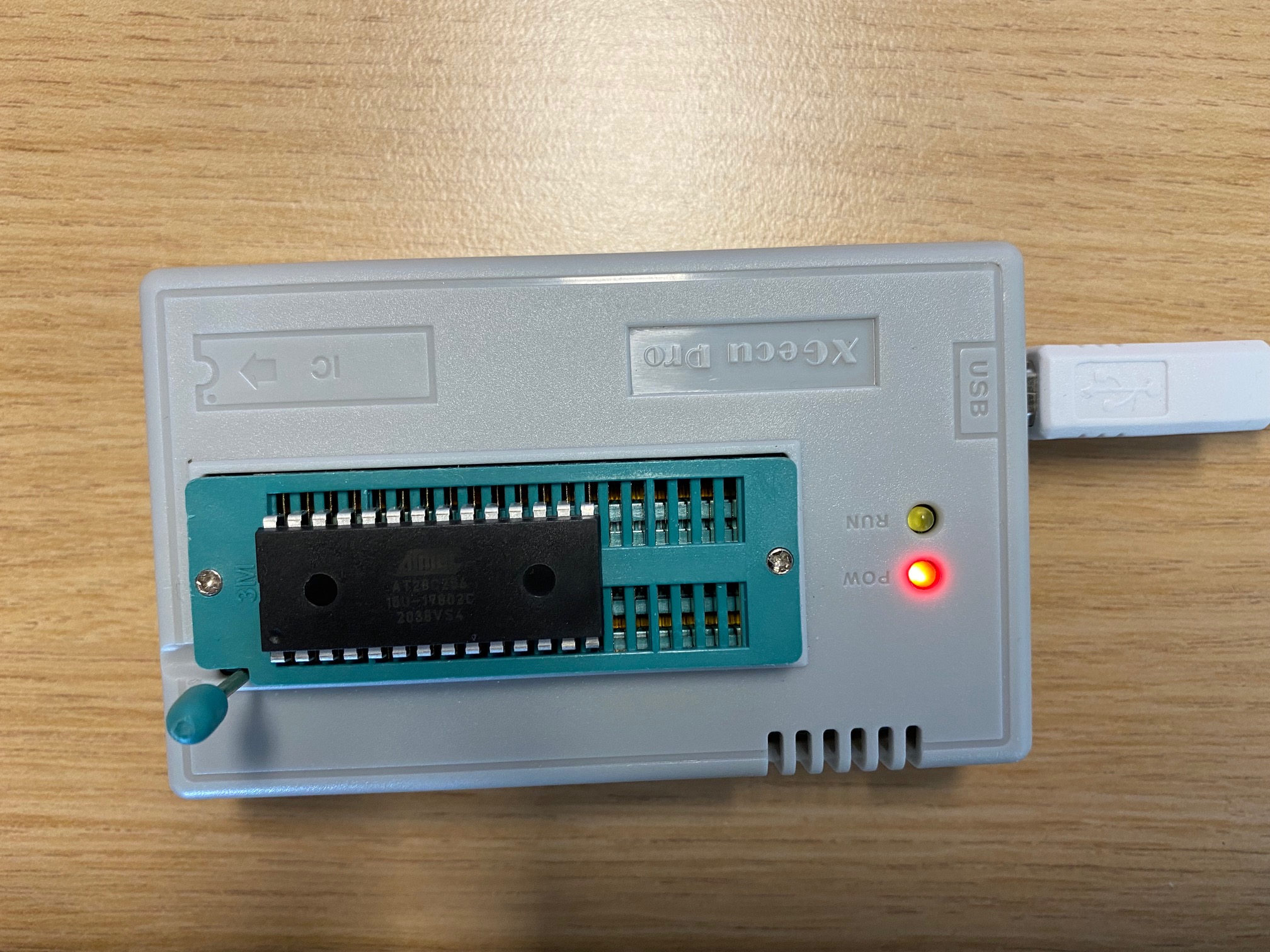

Then it's time to program the AT28V256 EEPROM and ATF22V10C PLD.
For the PLD you find in the Software/Glue map a file named GLUE3.jed. With my TL866II plus this is easily done.
Programming the EEPROM was a problem for me. Kevins supplies two S-record files on github. One for the BIOS and one for the Monitor program.
The Bios starts at $F800 and the Monitor at $E000 (with an offset of $800).
I don't have a clue (yet) how to configure that with the software of the TL866. I think the TL866 is not even capable of programming S-record files (?).
After contacting Kevin he kindly e-mailed me the newest version of the EEPROM in binaire format!
The systems works instantly (when you punt in the oscillator the correct way...)!
