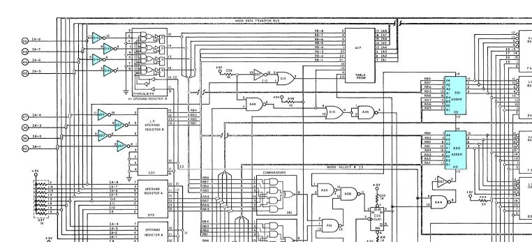

Martin_H wrote:
@Dr Jefyll, I thought at the circuit level there were only binary adders, and subtraction with borrow required inverters for one of the inputs.
Right. Binary adders (74283) are what're used here. And yes one of the input data paths is inverted but it happens further upstream, not right at the '283 inputs. Here's a cropped, lores version in which I've highlighted the relevant sections. For an overall block diagram see the web page.
