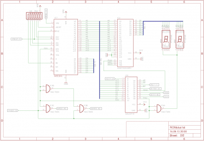

So here is the first set of documents I have created. First the schematic in two sheets
Schematic 1st Page
Schematic 1st Page
Schematic 2nd Page
Schematic 2nd Page
And the WinCUPL design file of the GAL

One question about the schematics, on sheet 1, is the parallel input to the shift register supposed to be VA0..6,11? I was expecting to find VD0..7.
I'll look forward to watching your progress!!
Daryl

8BIT wrote:
Great job Peter!
That's correct. This is on purpose. One issue I have is that the 80-column display only leaves 7 cycles per character and that I only can update 8-bits of the video RAM address. So I need to pack all address bits that might change in a row into the lower 8 address bits. The mapping you see is used when the VGA controller is used in my Apple IIe clone. The Apple II normally packs 3 character rows with 40 characters each into one linearly addressable memory block of 128bytes (3 x 40 leaving 8 bits per block unused). Thats why I have VA0..6 in the low-byte and I only need to change VA0..6 when I build the video display. VA11 is then added to the lower address byte so I can toggle the highest address bits for every other character when I mimic the Apple IIe 80-column mode and still only need to change one byte of address bits. The 6502 in Apple IIe mode then connects A0..A10 to address lines A0R to A10R of the DPRAM and A11R of the DPRAM would then connect to the Main/Aux RAM selector signal.
Peter
