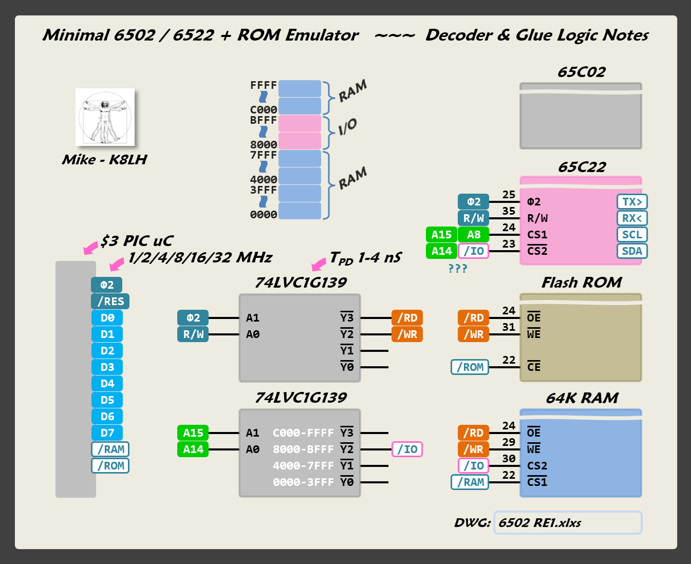

... the goal is building a full up computer with many I/O functions without glue logic. The 32K RAM probably will be the real limitation.
I would love to see this evolve into a full computer. Your experiments are very cool but the lack of memory, and vectors in the upper 16K ($C000..$FFFF), could be a limitation. Even with glue logic and a uC providing Loader/Programmer functions to support RAM-only operation, it seems 32-MHz operation might be difficult.
Question, please? Could a GAL provide faster switching times if it replaced the 139's in the circuit below? Also, could it be faster if the GAL produced an active-high 'IO' signal connected to the RAM active-low CS1 input with the RAM active-high CS2 input connected back to the ɸ2 signal (RAM /OE would be connected to RAM /CS1 and RAM /WE would be connected to CPU R/W)?
I can’t read your drawing, so I don’t know exactly what is being achieved.  However, I can tell you that, on paper, a single 74LVC gate will be faster than the fastest GALs currently available (Atmel 7.5ns products).  However, 74LVC’s TPD is more affected by loading than is a GAL.  It all depends on what you want to achieve.  One GAL can do the work of multiple LVC gates, and if needed, in a more complex way.  Also, as long as a GAL design doesn’t use pins as feedback nodes, the advertised TPD is guaranteed.  With discrete gates, cascaded prop time is always a variable.

I would speculate CS high tied to clock is the critical propagation path. W65C02 generates valid addresses quite quickly, so the decoding through GAL or ACT/LVC gate may be done before clock goes high. I do agree with BDD that a gate is faster than GAL. On the other hand, GAL has sufficient sum-of-product terms to form a small ROM the contains sufficient code to bootstrap from CF disk. That can be an interesting minimal design, too.
Regarding the missing vectors in high memory, I’m thinking of 8 resistors wired to value of $02, so interrupts are mapped to $0202. However, resistors may be too slow to work at 30+ MHz unless they are low values. I can also wire one of the resistor to address A[1] so IRQ vector is different from NMI vector.

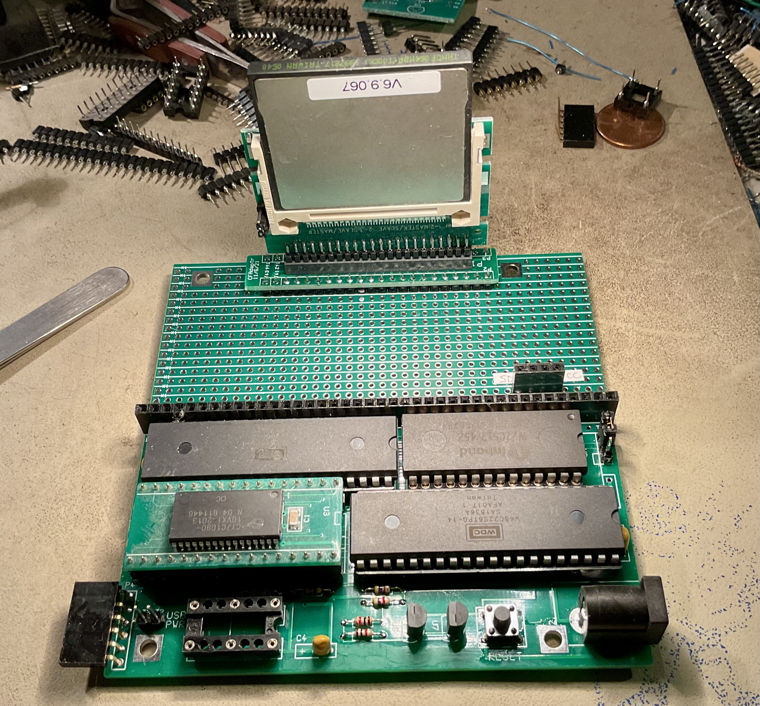

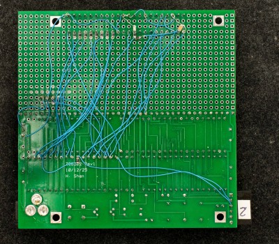

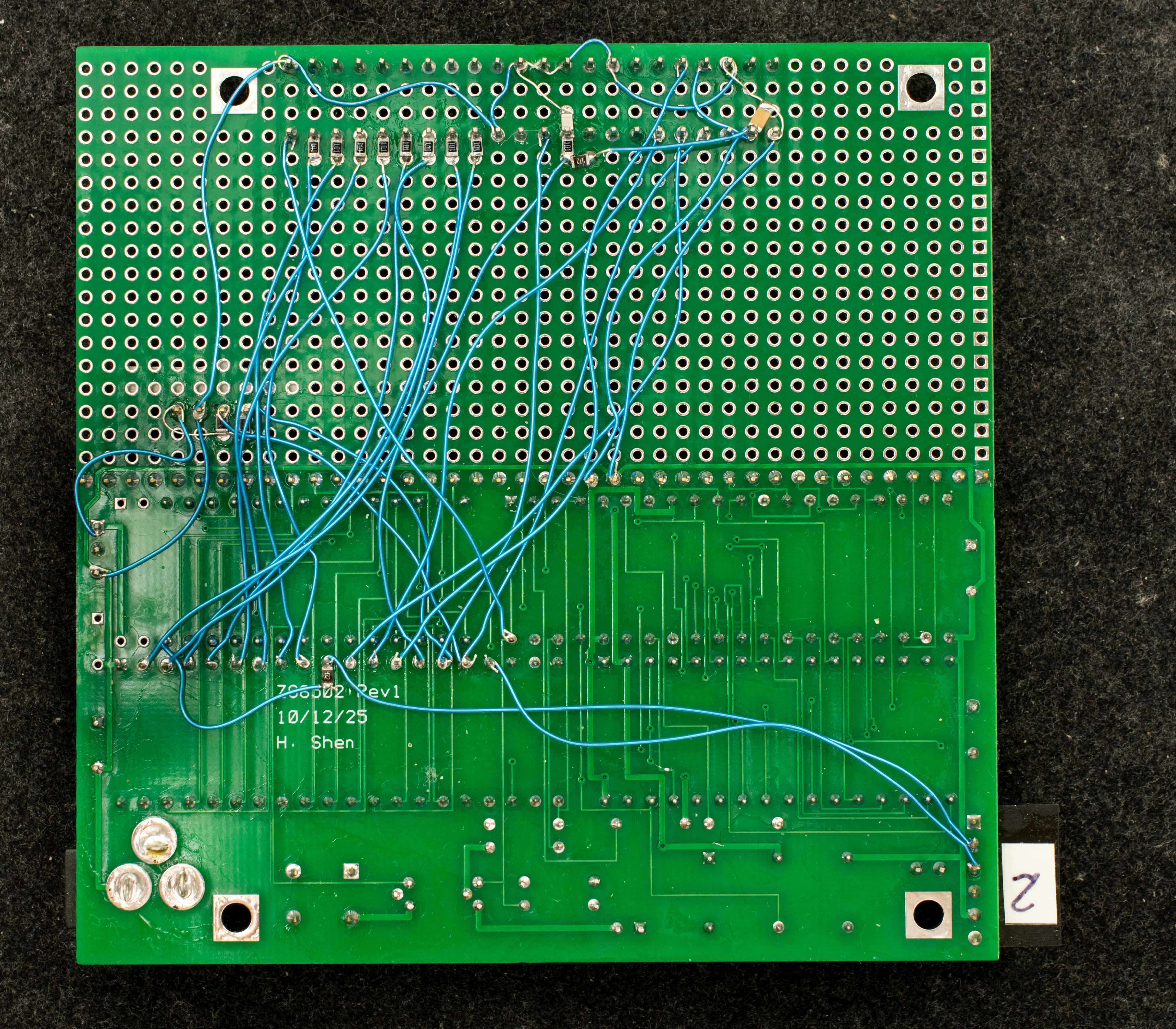

This is bottom view of the ZG6502 with CF interface added. The CF interface used 14 IO pins of W65C22; 8-bit data bus on port A and 6 IO on port B for addresses and CF controls. Serial bit-bang and CF interface used up all port A&B IO pins. I think I'll do SD interface instead because that only uses 4 IO pins.
Anyway, I'm able to read CF data reliably with 14.7MHz CPU clock. I'll do a speed test to check out the CF read and write access time.
Nov 11 update: it takes 23 seconds to read 8 megabytes of CF data (16384 sectors) at 14.7Mhz, that’s 360kB per second transfer rate.

I want to preserve both bitbang serial port as well as bitbang I2C function while implementing the CF interface. So I modified the prototype CF interface and assigned 6522’s CA2 and CB2 to CF read and write controls. The resulting CF interface is somewhat slower, but the I2C function is preserved. The CF transfer rate is 350KB per second with 14.7mhz 6502.
