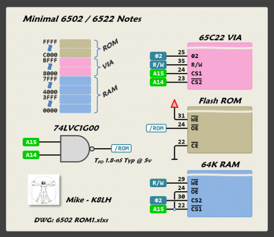

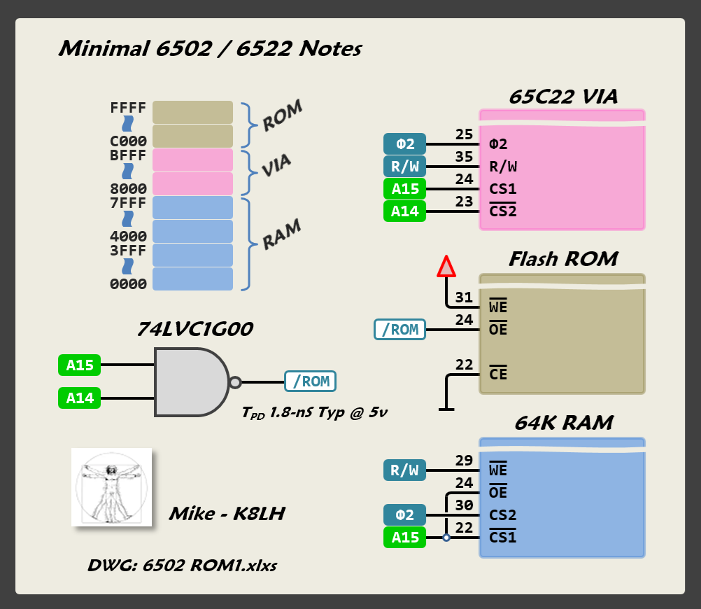

On paper W27C512 is 45nS access, so no, not on paper. In practice, it is faster than spec and furthermore its chip select and output enable are grounded, so the access is from valid addresses to valid data out. W65C02 addresses are valid significantly earlier than the rising edge of clock, so I’m able to run successfully. My guess is it can run close to 20mhz.
Very cool. Question, please? Based on your results do you think the W27C512 would work in the circuit below at 14.7-MHz or 16-MHz? If the ROM /OE pin goes low 1.8-nS after a valid address would its 20-nS propagation delay be concurrent with the ROMs 45-nS TACC (which you've demonstrated is much shorter)?

It should work fine. There may be slight loss in max operating frequency, but simplicity itself can improve speed by reducing load capacitance.
Edit, in rev0, it only has W65C51 so I like ROM to be paged out to accommodate additional I/O expansion. Rev1’s W65C22 is a more capable I/O device, so having ROM present in top 16K is a reasonable design option.

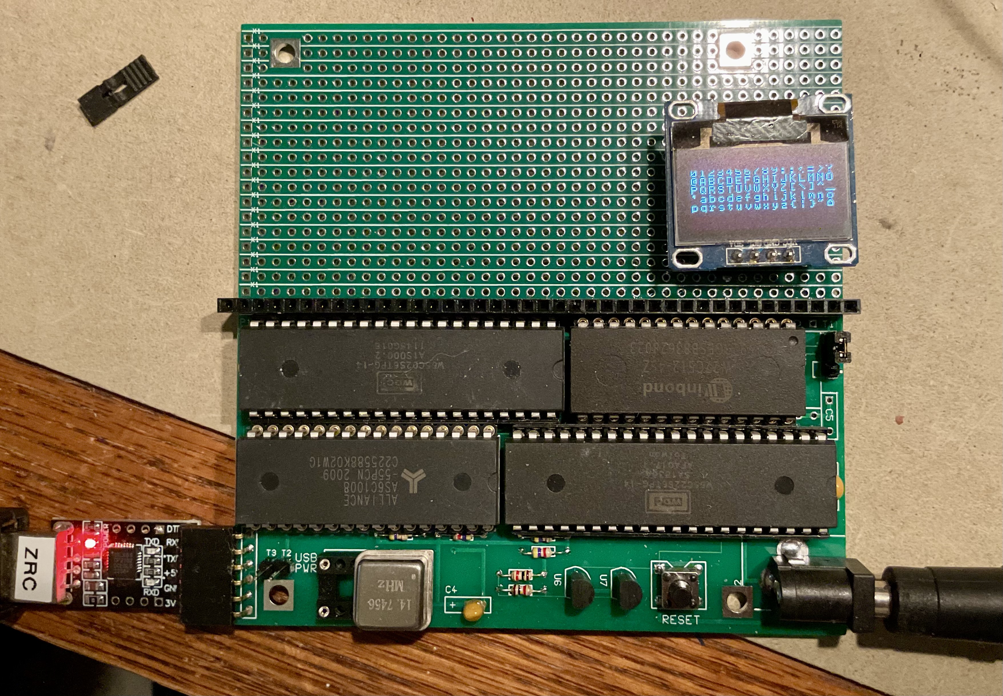

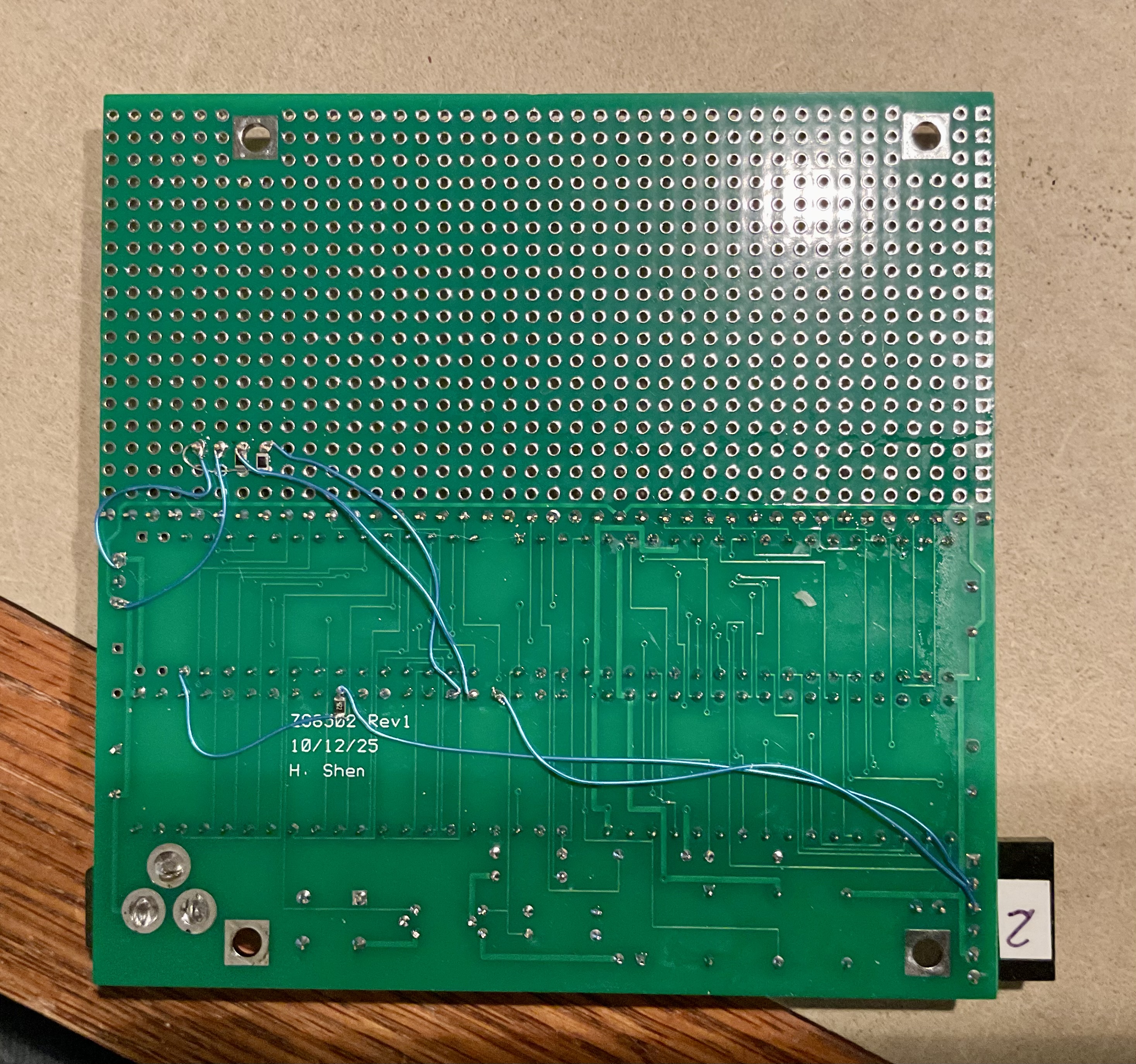

I have built 2nd ZG6502 rev1 board. It performed the same as the first board; run OK at 16mhz, but failed at 18.4Mhz. So the nominal operating frequency of ZG6502 rev1 will now be 14.7mhz. The bitbang serial port is still 115200 bps.
RAM can be as fast as 10nS, I think the speed limiting component is the 45nS W27C512. It maybe interesting to boot from W27C512 at 14.7Mhz, after the program is running in the fast RAM, then increase the clock until failure. One way to change clock while running is using a DS1086 oscillator that can be controlled via I2C. So I’ve added an I2C function such that VIA portB D[5] is I2C SDA; and portB D[6] is I2C SCL. I tested out the I2C function by driving an 128x64 OLED I2C display. It can display an ASCII table successfully, so I think the I2C interface is working correctly. Now I’ll try driving a DS1086 raising its own clock until it crashes…

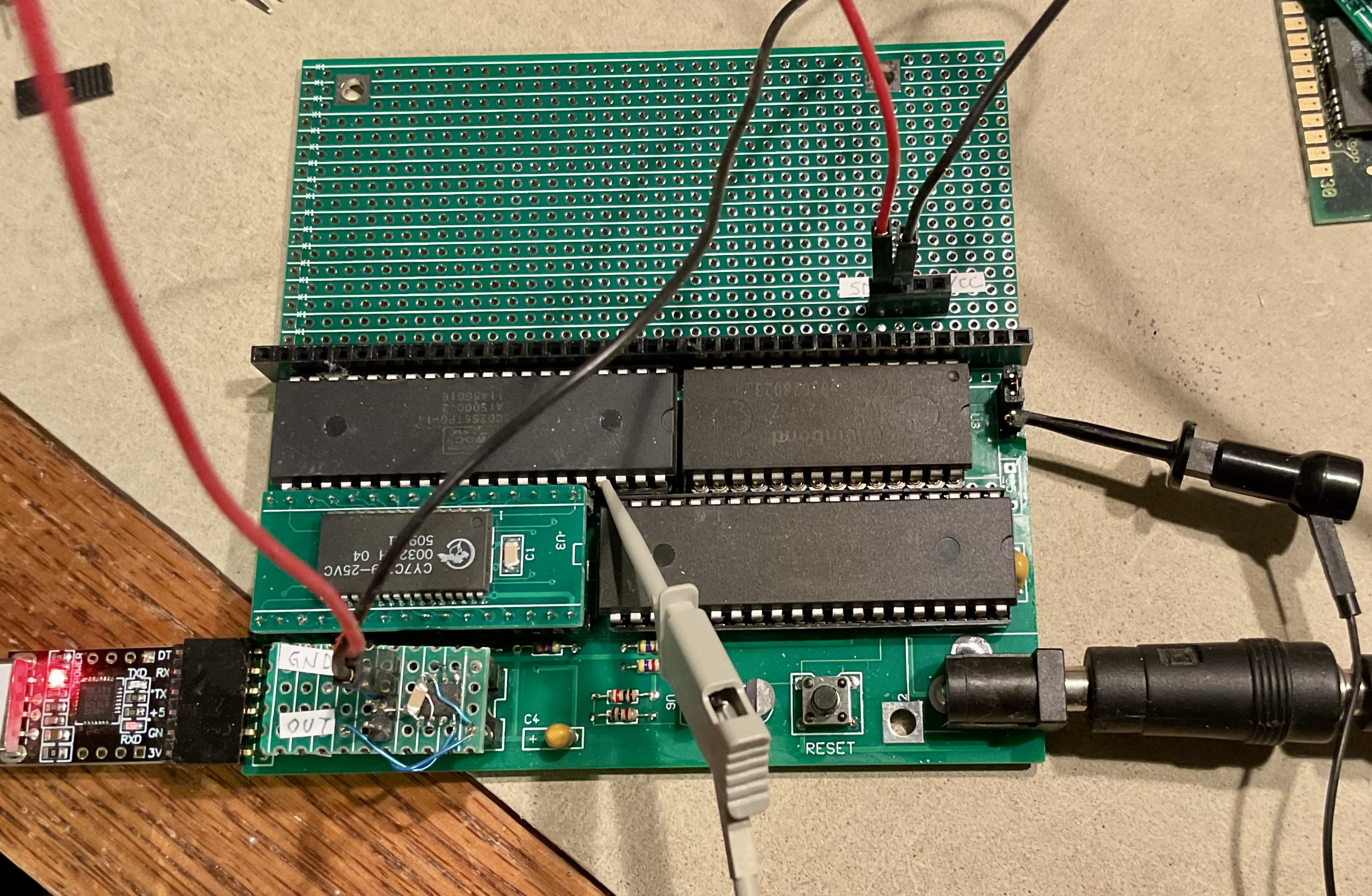

I’ve prototyped a DS1086 oscillator in DIP14 package so it can plug into the oscillator socket of ZG6502. The I2C signals are connected to a 4-pin header on the DIP14 prototype so I can drive them with W65C22. Before plugging in the DS1086 prototype into ZG6502 oscillator socket, I first programmed it to run 14.7mhz. Then it is plugged into ZG6502 oscillator socket and verified it will run correctly. Then the I2C signals are patched to W65C22.
I wrote a test software running in RAM that steps DS1086 frequency from 15.3mhz, 16.6Mhz, 17.9mhz, 19.2Mhz, 20.5mhz, 21.7mhz, 23mhz, 24.3mhz, 25.6Mhz, 26.9mhz, 28.1mhz, 29.4Mhz, and 30.7mhz. They all worked! These frequency steps require W65C22 to bit bang I2C signals, so as long as the frequencies are stepping up, W65C22 is working at that particular frequency. This is a pretty good indication that ZG6502 rev1 is good to 30.7mhz as long as the program is running in fast RAM.
To further prove proper operation at 30.7mhz, the test program returns to the monitor which originally communicates at 115200bps with 14.7mhz clock. Now the clock is 30.7mhz, the serial port is within 3% error of 230400bps so it can communicate at 230400bps just fine. I can now load a memory diagnostic and watch the memory test runs twice as fast. Total power consumption is 89mA at 5.1V at 30.7mhz. Power consumption is 59mA at 14.7mhz. Cool!
The take away is W65C22 can pair with W65C02 and overclocked recklessly!

I’m not done with overclock testing since it hasn’t failed yet. The RAM I’m using is 25nS part which is really too slow for 30+mhz operation. I need to swap in a 10nS RAM. I’m actually surprised that dynamically changing clock worked, all that worries about fractional clock phase or glitches in clock output do not appear to a problem, then again I need to run the tests repeatedly to be sure. Changing clock is a different way of working with slow peripherals; maybe there are applications for this approach. Alternatively I can use a 22V10 as a fast bootstrap ROM, add a CF interface such that 22V10 ROM loads and runs programs from CF disk.

I replaced the 25nS RAM with 10 nS RAM. The max frequency where ZG6502 is able to pass memory diagnostic at 5V and room temperature is around 32.3mhz. Considering this is a 2-layer board with DIP components and no attention to minimizing traces (done with an autorouter), this is roughly the result I’d expect with just W65C02. W65C22 may operate at higher frequency, but W65C02 is likely maxed out. Maybe 2-3 more megahertz is possible with better board layout and optimal component selection, but I’m satisfied that low 30Mhz operation can be achieved with average pair of W65C02 and W65C22 running in fast RAM.
