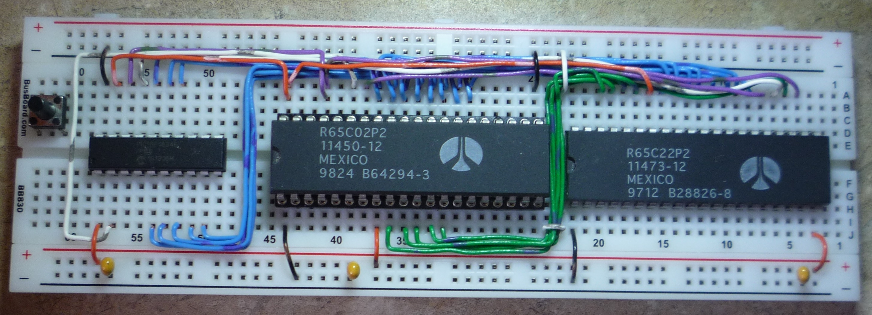

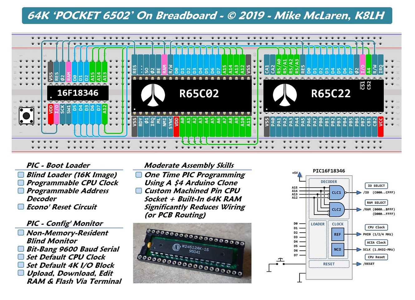

As for zero glue logic... If I replace the ROM chip with a boot loader / rom emulator chip on a 64K RAM design, might that be worth an "atta boy"?
Re: Zero glue logic 6502 SBC?
Atta boy.
Having said that, I wonder whether there are lowly "retro" single-chip microcontroller to assist the more powerful retro processor? 8051 family has quite a number of single-chip microcontrollers as well as 680x. Just don't want the assistant to outshine the 6502...
