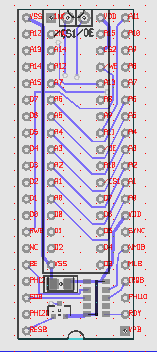

by enso
There are great space-saving and electrical reasons for tucking the SRAM into the socket of the EPROM.
As demonstrated, it is also possible to tuck the SRAM under the CPU, on a DIP40-sized board. I am experimenting with one such design. The SRAM is a little shorter, leaving space for decoupling, a SOT23 reset supervisor and an SMD pullup resistor pack. A minimal system just needs a clock, a ROM and a 74HC00. There is actually enough room for a SOIC-14 '00, but I did not want to hardwire the system to that extent. Instead I expose the /CS and /OE of the SRAM, which allows the assembly to be used in just about any map or situation.
I just need to find the best IC-like pins. In the meantime I can use my 3D-printed wire-wrap sockets.
P.S. Garth, connecting the address and data pins to their exact counterparts was just an added brain teaser.
